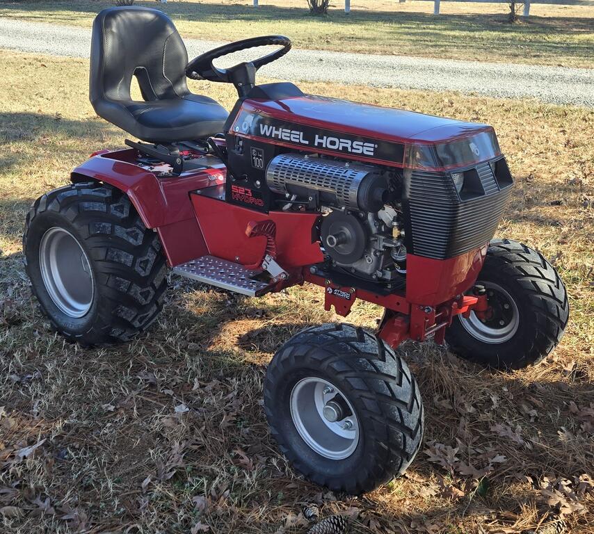

My 523-H has 9 inch tall front tires and 25 inch tall rears. Frame height is increased by about and inch and a half. But an unmodified deck on this machine has the same cut height as any other WH tractor. I modified an Exmark zero turn deck for higher cutting, but even then 3.5 to 4 inch cut height is about the best I could manage.

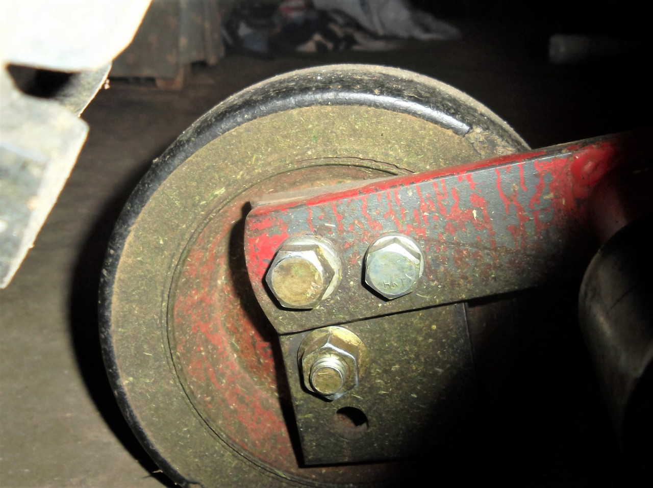

I replaced a the 6" deck height wheels with 8" ones on one of my decks and that gave me the extra deck height.

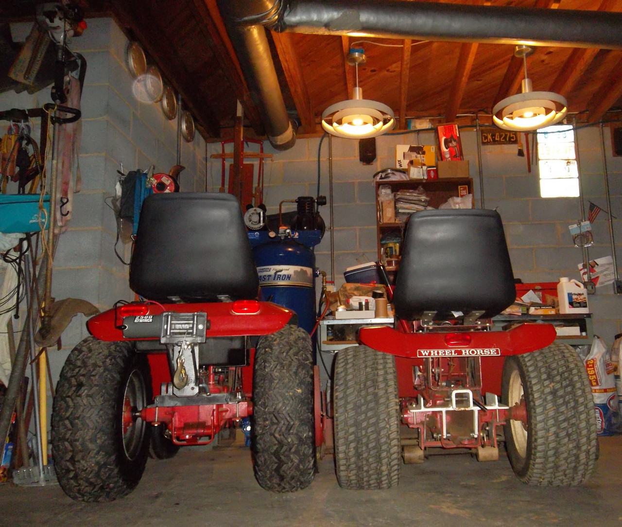

312-8 with 6" spindles and 400x8 Destones and 25x900x12 All Trail II rear fender, bracket and gas tank raised 1 3/4"
Seven inch deck wheels with added adapter 1".
Raised 312-8 beside a stock height C-120.
If there is room for 7" or 8" wheels you will get .5" or 1" increase in height, just remember to level the deck.  I run my blades almost level to gain a bit more height and see no difference in the power required.
Other than that mowing with it off the ground is another option??
It's easier to get deck height by increasing the size of the deck wheels.
I put 7-1/2 wheels on my deck.
