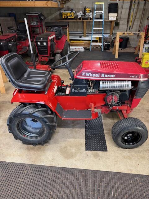

bo dawg 643 #1 Posted May 22 What is the width size that came on the 418s? To have 10.5" width tires are they same size as the 520? 1 Share this post Link to post Share on other sites
Easton Rich 1,290 #2 Posted May 22 Mine has 10.5"s on it and I think they're original. Id check Tractor Data 1 Share this post Link to post Share on other sites
kpinnc 19,105 #3 Posted May 22 (edited) Standard 7.5 inch Wheel Horse wheels will accept most any 10.50 wide turf tire. Ag cleats of the same 10.50 (actual) width on the other hand can be troublesome on 7.5 wide wheels. The bar treads force all the flex to the sidewalls on some tires and make clenching the bead tough without tubes. Better to use 8.5 (like 520 wheels) or wider wheels for these. So 23x10.50-12 turfs (or any non-bar tread) should be good. Edited May 22 by kpinnc 3 Share this post Link to post Share on other sites
bo dawg 643 #4 Posted May 22 These big bars I have must have been a bear to mount then. 10.5" 2 Share this post Link to post Share on other sites
