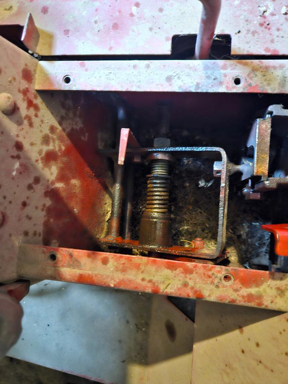

Tim.0 40 #1 Posted 3 hours ago (edited) The control lever for going forward backwards goes to full speed forward. Used to stay in a position. I had some information looked up and lost it, Any help. 1970 or so Raider or Cherger 10 or 12 if i remember correctly. Thanks wheelhorse ranger.jfif Edited 3 hours ago by Tim.0 Share this post Link to post Share on other sites
Tim.0 40 #2 Posted 2 hours ago found some info loosen nut tighten friction collar. anyone have any other insight on this. It was working and just stopped. Something possibly broken in friction collar? Thanks Share this post Link to post Share on other sites

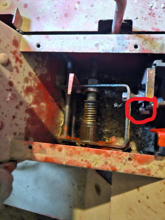

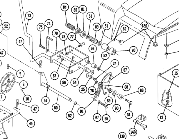

pfrederi 20,503 #3 Posted 1 hour ago Make sure the metal tab on the left end of the shaft (bolted to the hoodstand) isn't broken or the bolt missing. (#24/25) Share this post Link to post Share on other sites
WHX?? 56,570 #4 Posted 1 hour ago (edited) This guy here is what sets the friction. There was ones with springs over the top of the plate that set the tension on the plate. Some tractors do not have that spring. I thinks Lowell has the replacement plates. I know he has replacement cam plates. Check that for wear too. Edited 1 hour ago by WHX?? Share this post Link to post Share on other sites
pfrederi 20,503 #5 Posted 1 hour ago 1 minute ago, WHX?? said: This guy here is what sets the friction. There was ones with springs over the top of the plate that set the tension on the plate. ome tractors do not have that spring. I thinks Lowell has the replacement plates. I know he has replacement cam plates. Check that for wear too. The big spring on the cross shaft provides the resistance to the motion control. The little springs back on the slider were only used on Wheelamatics... (875-1275 vintage tractors.) Share this post Link to post Share on other sites
pfrederi 20,503 #6 Posted 1 hour ago Too adjust the tension on the control loosen the1-1/8 nut then use 5/8" wrench to turn the 4 flats on the end of the shaft sleeve Share this post Link to post Share on other sites
