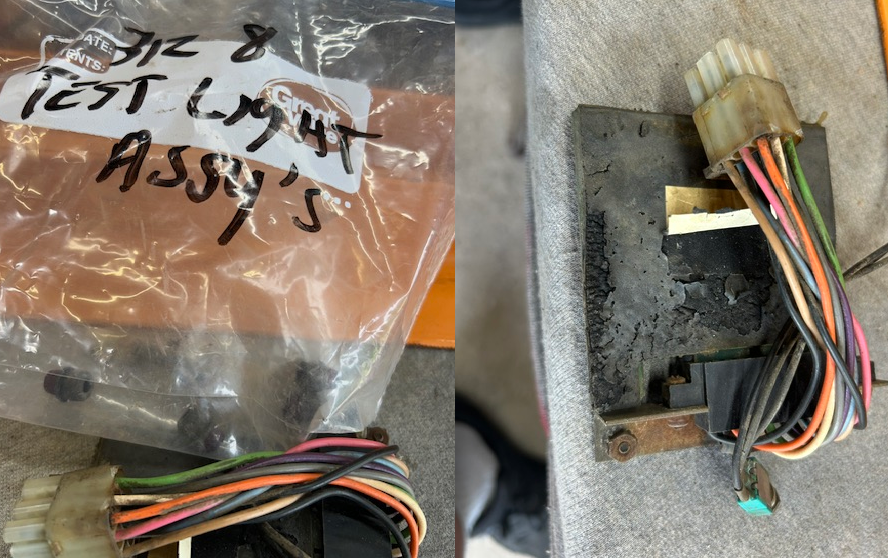

Bill D 3,156 #1 Posted May 21 Anyone got a source for replacement light panel connectors? Share this post Link to post Share on other sites
lynnmor 9,040 #2 Posted May 21 Maybe if you would clean it up and take a photo of the mating part we could get an idea of what you need. Digi-Key might be a good place to search. 1 Share this post Link to post Share on other sites
Bill D 3,156 #3 Posted May 21 I'll try to find some photos of a similar part. The pieces in the photo have been discarded. Share this post Link to post Share on other sites

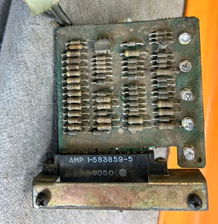

Bill D 3,156 #4 Posted May 21 Here's a screen shot of a board from ebay. Share this post Link to post Share on other sites

lynnmor 9,040 #7 Posted May 21 Go to the Digi-Key website and search for card edge connectors, you need to measure the pitch to get the spacing right. Just measure over all of them and divide by the number of spaces. Apparently there is a bracket involved not showing on the eBay photos. 1 1 Share this post Link to post Share on other sites

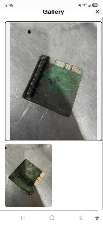

JoeM 10,267 #8 Posted May 22 Bill this one came off of a 312-8 Will it work for you? Share this post Link to post Share on other sites
gwest_ca-(File Mod) 12,488 #9 Posted May 22 If I remember correctly SOI determined all boards operated the same 110999 panel introduced in 1986 through 1988 for 312, 414 and 416 models - Replaced by 115207 111000 panel introduced in 1986 through 1988 for 417 and 420 models - Replaced by 115207 115207 panel introduced in 1989 through 1990 - (Page 3-12 of the Demystification Guide does not apply to the idiot light module. Should be page 3-13) 114825 idiot light module used 1990-1997 and replaced by 115207 - (Page 3-12 of the Demystification Guide does not apply to the idiot light module. Should be page 3-13) 79-2130 idiot light module used 1991-1997 on the 520 models - (Page 3-12 of the Demystification Guide does not apply to the idiot light module and page 3-13 is a different module. 79-2130 should not be listed.) 82-12o502* - Correct 82 -12o502 - Not correct 82-12o502 - Suspicious and not checked or determined yet 110999 Light circuit board used on 1986 models 21-12K802*, 21-12K803*, 21-12KE01*, 21-12KE02*, 22-11B502*, 22-12TE01, 31-14K801*, 31-16K802* 1987 models 21-12K804, 21-12KE03, 31-14K802, 31-16K803, 32-11B301, 32-11B501, 41 -18KE01, B2-11B392 1988 models 21-12K805*, 31-14K803*, 31-16K804*, E1-12K801* 111000 Light circuit board used on 1986 models 31-17K802*, 31-17KE02*, 31-20KE01* 1987 models 21-12K804, 21-12KE03, 31-14K802, 31-16K803, 31-18K801*, 31-18KE01*, 41 -18KE01 1988 model B1-16O801* 115207 Light circuit board used on 1988 models 22-17KE01*, Not used on 22 -13KE01 1989 models 22-17KE02*, Not used on 22 -13KE02 1 1 Share this post Link to post Share on other sites
Bill D 3,156 #10 Posted May 22 1 hour ago, JoeM said: Bill this one came off of a 312-8 Will it work for you? PM sent. Share this post Link to post Share on other sites
