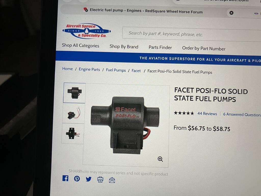

Retired Wrencher 7,043 #3 Posted May 22 (edited) Phan I would start by changing points condenser check to see if the plug wire is ok. Check your wiring for loose and bad grounds. Also look for bad wires with exposed bear wires that may be shorting out. And of course rebuild a carburetor and I think it’ll fire it up and if you could do it, find yourself a good electric fuel pump like this one and you’ll be well on your way to enjoying the tractor for years to come. I have this model it is my show putter. All day and you still have gas in the tank. As for the cables E-bay has them. Check for length of the old cable make it will be long enuf. Edited May 22 by Retired Wrencher Share this post Link to post Share on other sites
