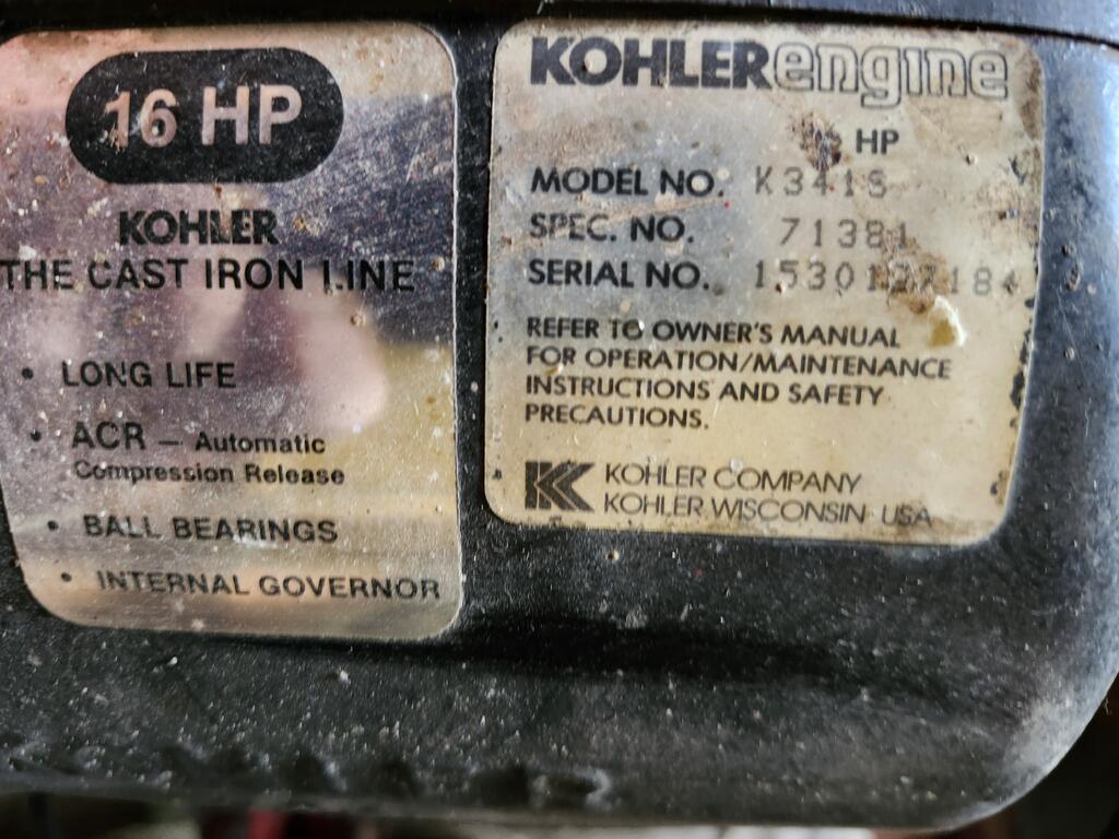

New2WH 3 #8 Posted May 28 On 5/21/2026 at 7:34 AM, 953 nut said: We are here to help one another. As you can see by the response to your inquiry we have lots of information to share. Please take a couple of minutes and tell us about your Wheel Horse story. https://www.wheelhorseforum.com/forum/47-introductions/ All contributions have been a big help, I really appreciate all the knowledge! Ordered a clutch plate waiting for it to arrive. Changed all the fluids and fixed a couple of wires that the mice munched on. The engine is turning over but I am not getting any spark. Engine info attached. any thoughts on where to look. I am getting 12v at the + terminal on the coil and the lead going to the points. Share this post Link to post Share on other sites

gwest_ca-(File Mod) 12,557 #10 Posted May 28 Your tractor is a 1986 416-8 model 31-16K802 unless it has a newer engine. The engine was made in 1985 but the 1986 model year was the only year to use spec. 71318 This link will take you to 2 pages of search results for this model number https://www.wheelhorseforum.com/search/?q=31-16k802&quick=1&type=downloads_file Share this post Link to post Share on other sites

New2WH 3 #12 Posted May 29 13 hours ago, gwest_ca said: Your tractor is a 1986 416-8 model 31-16K802 unless it has a newer engine. The engine was made in 1985 but the 1986 model year was the only year to use spec. 71318 This link will take you to 2 pages of search results for this model number https://www.wheelhorseforum.com/search/?q=31-16k802&quick=1&type=downloads_file I am pretty sure I have a Frankenstein wheel horse. model number on tractor is 91-08K802-9748 8319 which believe had an 8HP. This unit has a 16HP. Thanks for identifying 1986 as the engine date. Any idea what the mfg date is for the tractor? Share this post Link to post Share on other sites
gwest_ca-(File Mod) 12,557 #13 Posted May 29 40 minutes ago, New2WH said: Any idea what the mfg date is for the tractor? Serial 9748 - Build date 1978 8319 November 15 Wednesday Share this post Link to post Share on other sites
