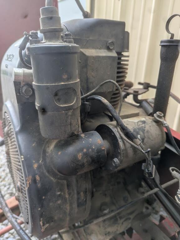

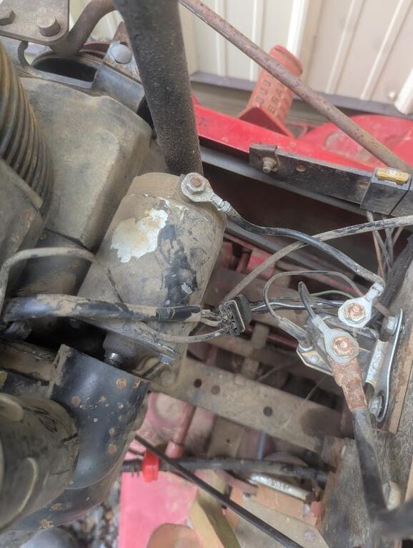

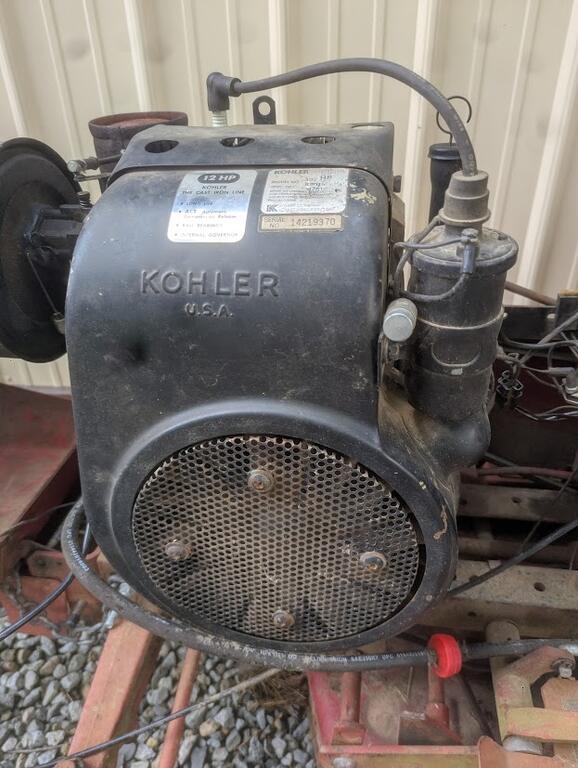

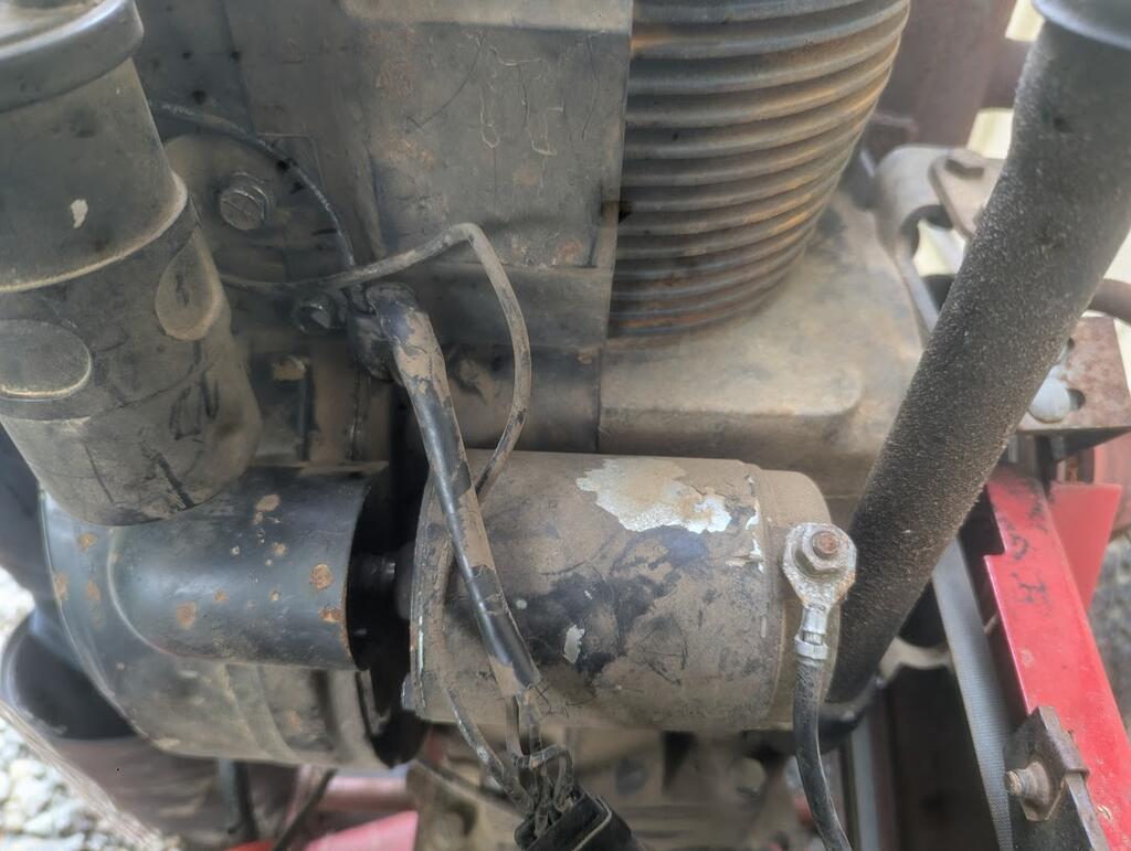

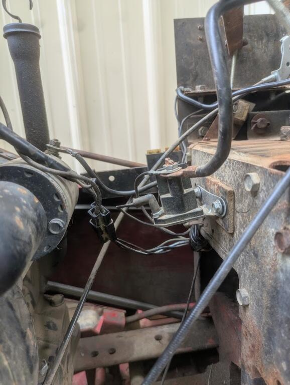

Yitzchok 5 #6 Posted June 8 Two months ago i put in a new battery the last time i used it was two weeks ago. Last week i turned the key and nothing happened i got my (not) trusty (not) good old multimeter and it gave me a reading of 0.02v. Today i tried the multimeter on the car and it gave me good readings i jumped the mower and i tested it and it gave me the same jumpy readings in ac and dc i also tested it by the wires that go to the factory installed analog meter (that i removed because it was broken) to get away from the engine and it gave me the same readings (I'm thinking maybe that's what broke the meter) what should i do before i put in a new battery? Share this post Link to post Share on other sites
pfrederi 21,342 #7 Posted June 9 Run a jumper wire from the voltage regulator housing to the Battery - terminal. See if you r reading improve. A poorly grounded regulator will do strange things 2 Share this post Link to post Share on other sites
Yitzchok 5 #8 Posted June 9 I don't know where the regulator is. 1 Share this post Link to post Share on other sites

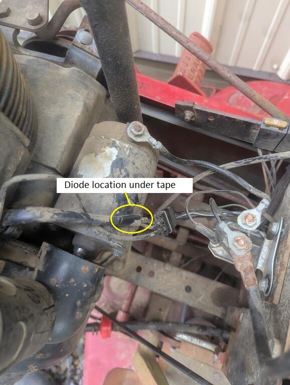

953 nut 70,649 #9 Posted June 10 If the Spec Number on your engine is 47812 or 47828 there is no voltage regulator. The engine has two electrical leads, one is a 3 Amp line with a small diode in it that serves as a battery charging system and the other wire is AC and supplies power for the lights. Not the best system in the world but that is what they went to after Cecile Pond sold the company to the bean counters. 1 Share this post Link to post Share on other sites
Handy Don 17,735 #10 Posted June 10 11 minutes ago, 953 nut said: If the Spec Number on your engine is 47812 or 47828 there is no voltage regulator. The engine has two electrical leads, one is a 3 Amp line with a small diode in it that serves as a battery charging system and the other wire is AC and supplies power for the lights. Not the best system in the world but that is what they went to after Cecile Pond sold the company to the bean counters. This engine must be up to at least 2200 RPM to get the voltage up high enough to charge the battery. The low (3 amp) current assures that the battery doesn’t cook. Also, since the lighting line is AC, any directly-connected DC-needing LED lights will likely flicker. Incandescent filaments work ok on AC. That said, since they draw much less current than incandescents, directly connecting a pair of LED headlights (with proper polarity) to the battery should be ok as long as you keep the engine revs up. Share this post Link to post Share on other sites
pfrederi 21,342 #11 Posted June 10 27 minutes ago, 953 nut said: If the Spec Number on your engine is 47812 or 47828 there is no voltage regulator. The engine has two electrical leads, one is a 3 Amp line with a small diode in it that serves as a battery charging system and the other wire is AC and supplies power for the lights. Not the best system in the world but that is what they went to after Cecile Pond sold the company to the bean counters. The 3 amp system on my 310-8 works just fine.... 1 1 Share this post Link to post Share on other sites
gwest_ca-(File Mod) 12,557 #12 Posted June 10 The electrical section describes how to check the 3 amp charging system. 1 1 1 Share this post Link to post Share on other sites
