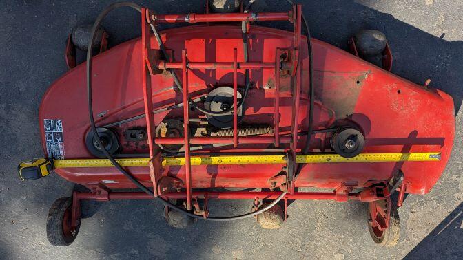

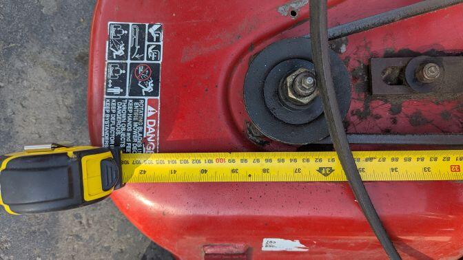

Phan 68 #1 Posted May 18 Hello There is no label on the deck. It measures 42-45 inches. What size the deck is? Share this post Link to post Share on other sites
Sparky-(Admin) 26,492 #3 Posted May 18 42” side discharge 1 Share this post Link to post Share on other sites
kpinnc 19,004 #4 Posted May 19 Yep. 42 side discharge. Very common. Share this post Link to post Share on other sites
Brockport Bill 2,479 #5 Posted May 19 for future reference, its the width of cut that is measured, not shell -- outside tip of one outside blade, to outside tip of other outside blade Share this post Link to post Share on other sites
oldlineman 1,814 #6 Posted May 19 if the height adjuster is on the right side 42" if on the left side 48" for future reference. Bob Share this post Link to post Share on other sites
