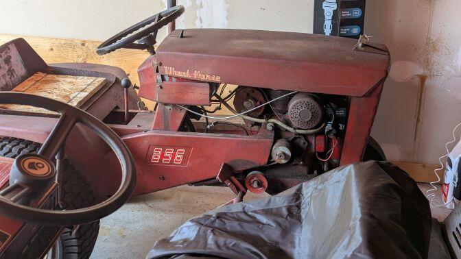

Phan 68 #1 Posted May 18 Hello! Any suggestions? It seems like 856 is stuck and cannot move. Share this post Link to post Share on other sites
Sparky-(Admin) 26,403 #2 Posted May 18 Can it be pushed by hand? That would eliminate the parking brake being set. Does the shifter move into the diff gears and when you let out the clutch it doesn’t move? Does the motor bog down when you try letting the clutch up it in any gear? Share this post Link to post Share on other sites
rmaynard 17,589 #3 Posted May 18 My first 856 would not move when I let the clutch out. Turned out to be the Woodruff key was missing from the input shaft. 1 Share this post Link to post Share on other sites
wallfish 20,639 #4 Posted May 18 1 hour ago, Phan said: Any suggestions? You should add a lot more details about what's going on for a lot better internet diagnosis. Is the brake pedal locked down by the parking brake lever? 1 Share this post Link to post Share on other sites
953 nut 69,556 #5 Posted May 19 When you let out the clutch what happens? Could be the transmission is stuck in two gears? If you jack up one rear wheel with the transmission in neutral will that wheel turn by hand? 1 Share this post Link to post Share on other sites
Phan 68 #6 Posted May 19 19 hours ago, Sparky said: Can it be pushed by hand? That would eliminate the parking brake being set. Does the shifter move into the diff gears and when you let out the clutch it doesn’t move? Does the motor bog down when you try letting the clutch up it in any gear? I depressed the clutch pedal a few times - I can move it now by hands. Share this post Link to post Share on other sites
Phan 68 #7 Posted May 19 2 hours ago, 953 nut said: When you let out the clutch what happens? Could be the transmission is stuck in two gears? If you jack up one rear wheel with the transmission in neutral will that wheel turn by hand? I depressed the clucth pedal - it can move freely ! 1 Share this post Link to post Share on other sites
wallfish 20,639 #8 Posted May 19 4 hours ago, Phan said: I depressed the clucth pedal - it can move freely ! That's good! Something easy 1 Share this post Link to post Share on other sites
