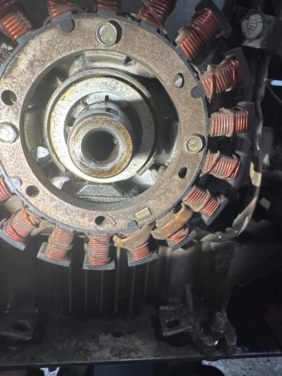

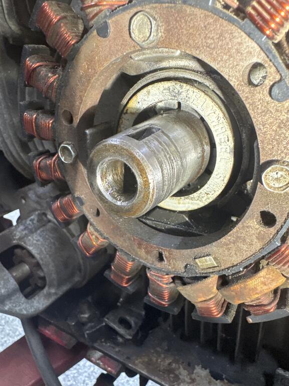

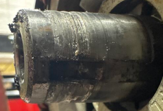

adsm08 5,247 #51 Posted August 16 @PWL216 That's kind of a crap angle on the first picture. The key doesn't look sheared to me, but it sure does look beat up, and I see a few other things on the crank that make me think that flywheel was spinning on it. Share this post Link to post Share on other sites
Bill D 3,213 #52 Posted August 16 (edited) 27 minutes ago, adsm08 said: @PWL216 That's kind of a crap angle on the first picture. The key doesn't look sheared to me, but it sure does look beat up, and I see a few other things on the crank that make me think that flywheel was spinning on it. Agreed. Part of the key is supposed hold the trigger wheel in time. Pull the key and post a picture please. Pretty sure it's sheared. If you look at the picture of the crank trigger wheel the notch for the key is at the top, not in line with the keyway. I think we found the problem. You'll need a new key and maybe a new crank trigger wheel. Key is PN 515-0284 Edited August 16 by Bill D 2 Share this post Link to post Share on other sites

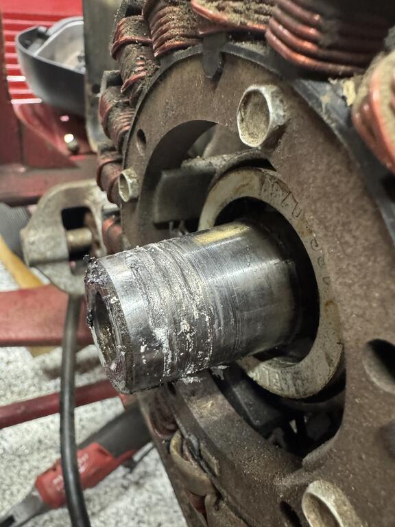

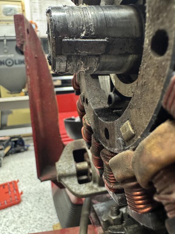

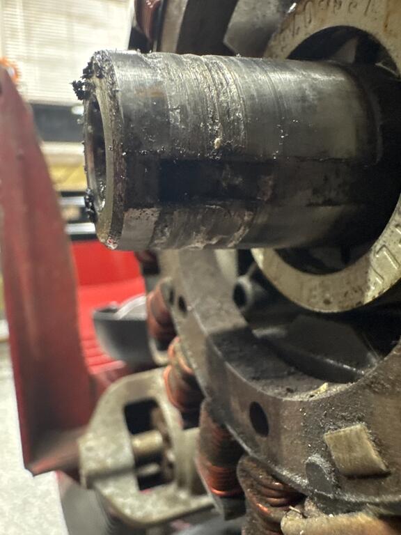

PWL216 1,310 #53 Posted August 16 Requested pics. 2 Share this post Link to post Share on other sites
PWL216 1,310 #54 Posted August 17 29 minutes ago, adsm08 said: @PWL216 That's kind of a crap angle on the first picture. The key doesn't look sheared to me, but it sure does look beat up, and I see a few other things on the crank that make me think that flywheel was spinning on it. Agreed. The crank is gouged pretty well Share this post Link to post Share on other sites

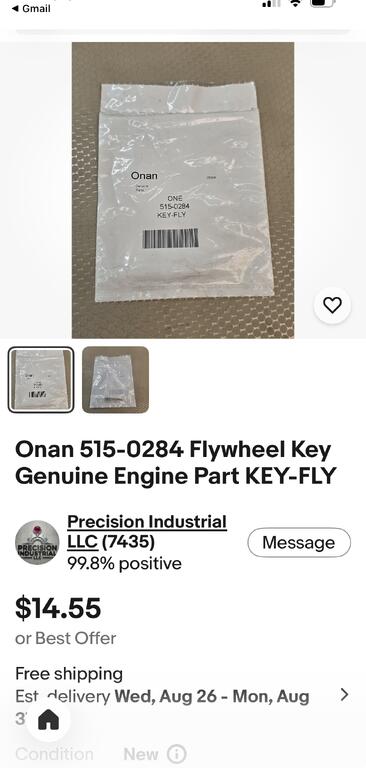

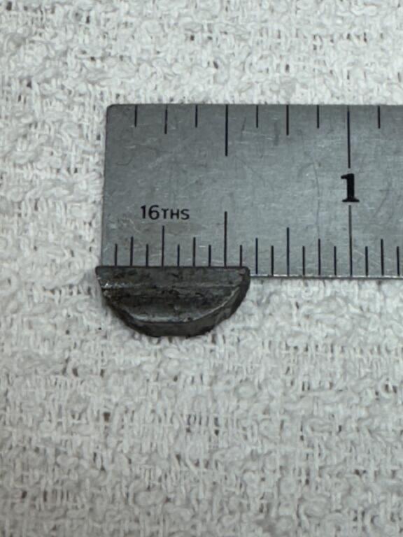

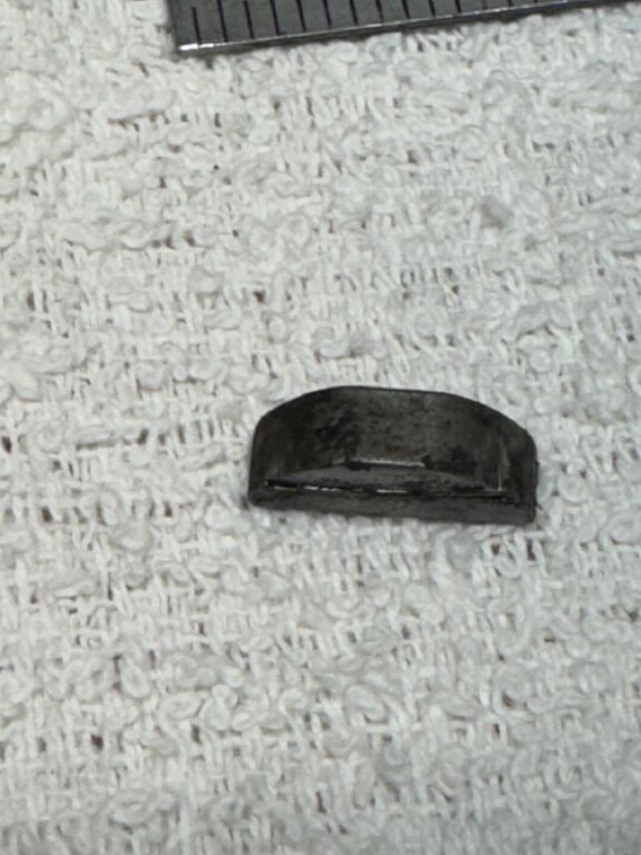

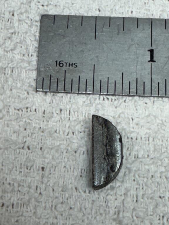

Bill D 3,213 #55 Posted August 17 (edited) https://www.google.com/url?sa=t&source=web&rct=j&opi=89978449&url=https://www.ebay.com/itm/187139873092&ved=2ahUKEwiqyKOBraaWAxVhq4kEHSRvD7AQqa4BegQIThAA&usg=AOvVaw29kSzXkoLyxbxLVKcjEsmh Definitely the wrong key. This is the key you need. An OEM Onan key is cheaper from the Cummins website. Edited August 17 by Bill D 1 Share this post Link to post Share on other sites

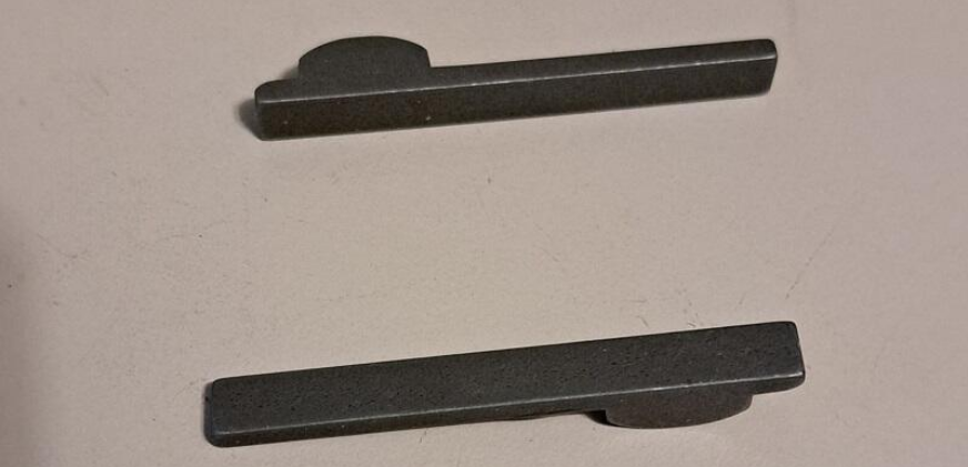

lynnmor 9,081 #56 Posted August 17 Here is the key you need: 1 4 Share this post Link to post Share on other sites
PWL216 1,310 #57 Posted August 17 Thx guys!! updates to follow… 1 Share this post Link to post Share on other sites

Bill D 3,213 #59 Posted August 17 That crank is pretty beat!! @lynnmor what do you think. Is it salvageable? Share this post Link to post Share on other sites
sqrlgtr 4,224 #60 Posted August 17 5 minutes ago, Bill D said: That crank is pretty beat!! @lynnmor what do you think. Is it salvageable? you guys are a lot more knowledgeable than I am but I sure would clean it up good and try it. just my though. 2 Share this post Link to post Share on other sites
PWL216 1,310 #61 Posted August 17 11 minutes ago, sqrlgtr said: you guys are a lot more knowledgeable than I am but I sure would clean it up good and try it. just my though. That’s the plan, I hope. 1 Share this post Link to post Share on other sites
wallfish 20,744 #62 Posted August 17 That flywheel had definitely spun before and probably because someone put a little woodruff key in there. I don't see that as being the end of that shaft though. Just put the proper key in it and it will hold. I'm no Onan expert and barely know them but most every other engine uses a taper fit lock instead of relying solely on a key to hold them in place for a reason. That's a straight shaft fit so the long key is definitely required 2 Share this post Link to post Share on other sites
Bill D 3,213 #63 Posted August 17 (edited) 9 hours ago, wallfish said: That flywheel had definitely spun before and probably because someone put a little woodruff key in there. I don't see that as being the end of that shaft though. Just put the proper key in it and it will hold. I'm no Onan expert and barely know them but most every other engine uses a taper fit lock instead of relying solely on a key to hold them in place for a reason. That's a straight shaft fit so the long key is definitely required Someone probably replaced the ignition module but never properly torqued the flywheel bolt when they put it back together, which made the key shear. The long key is used to hold the trigger ring in time. Someone else on here had the same problem with a sheared flywheel key due to the PO not torquing the flywheel bolt properly. Does the flywheel bolt have the correct thick washer with it? Edited August 17 by Bill D 1 Share this post Link to post Share on other sites
953 nut 70,647 #64 Posted August 17 9 hours ago, wallfish said: That flywheel had definitely spun before and probably because someone put a little woodruff key in there. I don't see that as being the end of that shaft though. Just put the proper key in it and it will hold. I'm no Onan expert and barely know them but most every other engine uses a taper fit lock instead of relying solely on a key to hold them in place for a reason. That's a straight shaft fit so the long key is definitely required Since the flywheel has obviously been spun on the crankshaft you should also take a good look inside the flywheel bore. 2 Share this post Link to post Share on other sites
c-series don 12,751 #65 Posted August 17 Maybe it’s just the angle of the picture but it appears that the key way in the flywheel is worn? A thorough cleaning will help determine that. Share this post Link to post Share on other sites
cafoose 3,883 #66 Posted August 17 Looks like part of the long key is still on the crankshaft. 2 Share this post Link to post Share on other sites
lynnmor 9,081 #67 Posted August 17 2 hours ago, c-series don said: Maybe it’s just the angle of the picture but it appears that the key way in the flywheel is worn? A thorough cleaning will help determine that. I'm having a problem with the photo angle as well. The crankshaft should be tapered and the tail of the key rides above and locates the magnet ring to time the ignition. That magnet ring may be damaged with the failure. It appears that the crank has grooves worn in it and that may not grab the flywheel well. Any debris and high spots on the crank and in the flywheel needs to be removed and then the parts can be lapped together with fine lapping compound. The surfaces need to be completely clean and then only a wipe of rust proofing applied. The flywheel bolt torque is 55 ft. lbs. with a drop of oil on the threads and under the bolt head. What really is needed is replacement of the crankshaft and flywheel, using these parts might very well cause a failure in the future. 2 1 Share this post Link to post Share on other sites
squonk 48,426 #68 Posted August 17 (edited) At very least clean up the shaft and flywheel bore and apply Loctite bearing and sleeve retainer. give it a shot. You can't spoil a rotten egg! Edited August 17 by squonk 5 Share this post Link to post Share on other sites

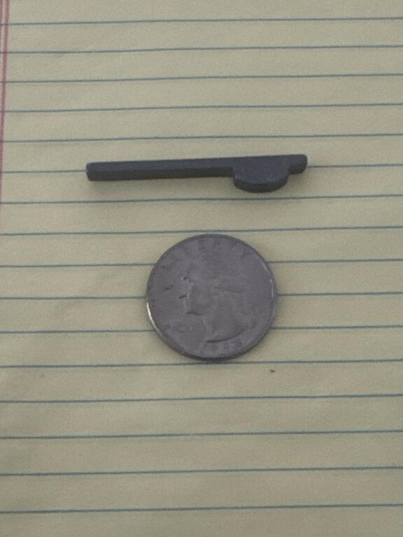

PWL216 1,310 #69 Posted August 22 The key is here. I hope to get to it this afternoon! The shaft has also been cleaned. 3 2 Share this post Link to post Share on other sites
sqrlgtr 4,224 #70 Posted August 22 1 hour ago, PWL216 said: The key is here. I hope to get to it this afternoon! The shaft has also been cleaned. If you don't mind me asking, where did you find/order one? PM me if you would rather not post it publicly. Share this post Link to post Share on other sites

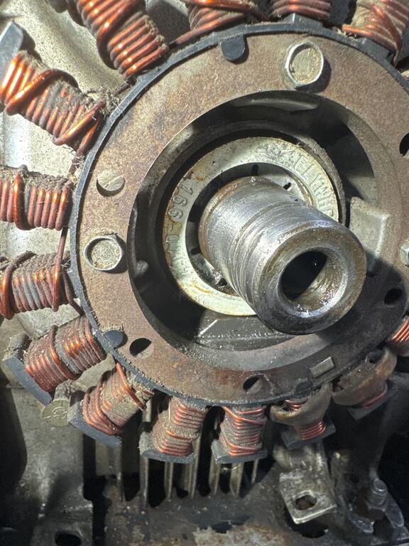

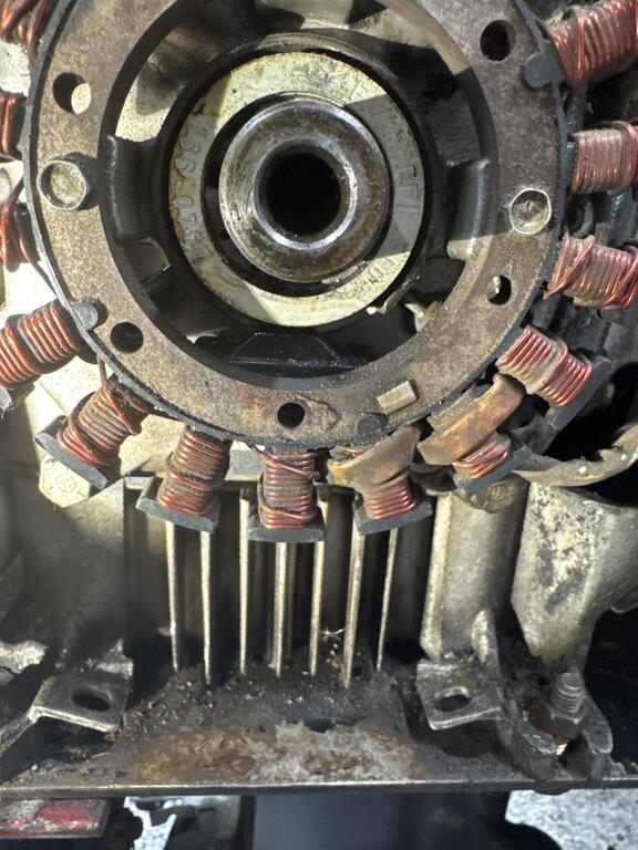

PWL216 1,310 #73 Posted August 23 (edited) 15 minutes ago, Bill D said: Looking forward to seeing if it runs!! Please post some pictures of the trigger ring. Would like to see if it looks damaged at all. Edited August 23 by PWL216 Added photo 1 Share this post Link to post Share on other sites
Bill D 3,213 #74 Posted August 23 (edited) 9 minutes ago, PWL216 said: You'll need to pull that out and clean around it good. You don't want any metal shavings from the crankshaft around there or stuck to the magnet that's in it. The large notch by the number 166 fits over the tail of the key, and that holds it in time. It's definitely out of time. That's why it wouldn't start. Trigger ring looks okay otherwise. Edited August 23 by Bill D 1 4 Share this post Link to post Share on other sites
Bill D 3,213 #75 Posted August 23 (edited) If you have some thin needle nose pliers you can gently pull that ring off. A squirt of lube will help it come off. Hit the area and ring with brake cleaner and compressed air the reassemble with the new key. Make sure the writing saying flywheel side is showing before you put the flywheel on. You won't get spark if it's on backwards. Edited August 23 by Bill D 2 Share this post Link to post Share on other sites
