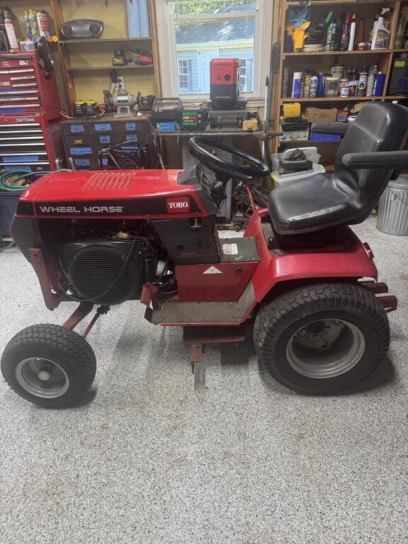

PWL216 1,310 #44 Posted August 14 Picked up the tractor today…will be checking the flywheel key as suggested by @Bill D 4 4 Share this post Link to post Share on other sites
sqrlgtr 4,224 #45 Posted August 15 9 minutes ago, PWL216 said: Picked up the tractor today wished the paint on mine was as good as that one. best looking 520 seat Ive seen in a long time..... 1 Share this post Link to post Share on other sites

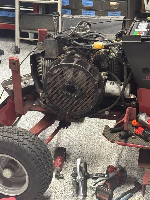

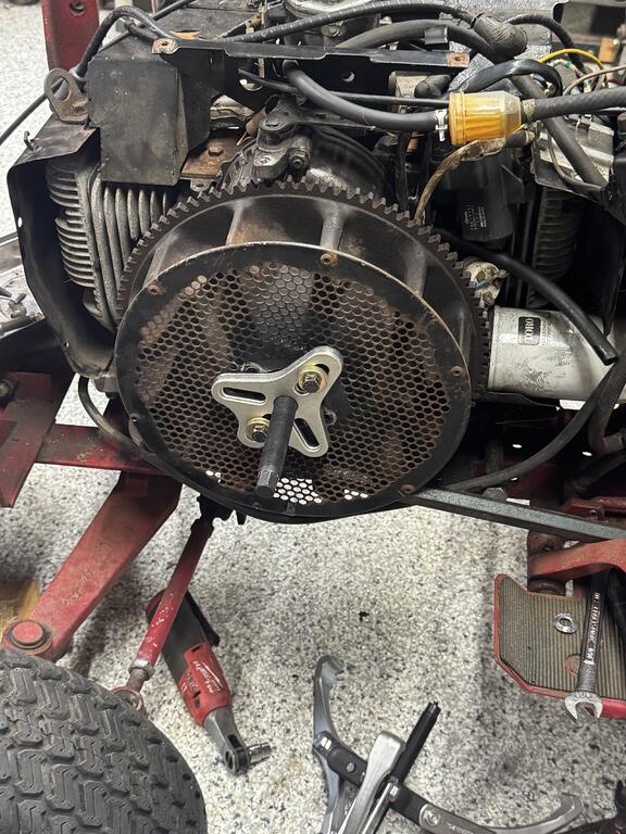

PWL216 1,310 #46 Posted August 16 Ok guys, what’s the magic formula for getting the flywheel off? 🤪 Share this post Link to post Share on other sites
Ed Kennell 47,939 #47 Posted August 16 Tension on the puller and a sharp rap with the BFH on the puller screw works for me. 2 3 Share this post Link to post Share on other sites
wallfish 20,744 #48 Posted August 16 Since you have a puller rap on that puller screw as Ed wrote. If that doesn't work wedge it and try it again I wedge them from behind against the block and do a fast rap right to the shaft with a hammer. Shocks them loose. Leave the nut on but loose so threads aren't damaged. Have yet to have one that wouldn't come off doing this 2 1 Share this post Link to post Share on other sites
SylvanLakeWH 32,918 #49 Posted August 16 1 hour ago, Ed Kennell said: Tension on the puller and a sharp rap with the BFH on the puller screw works for me. and "ping"... it'll pop off... 1 Share this post Link to post Share on other sites

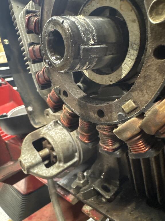

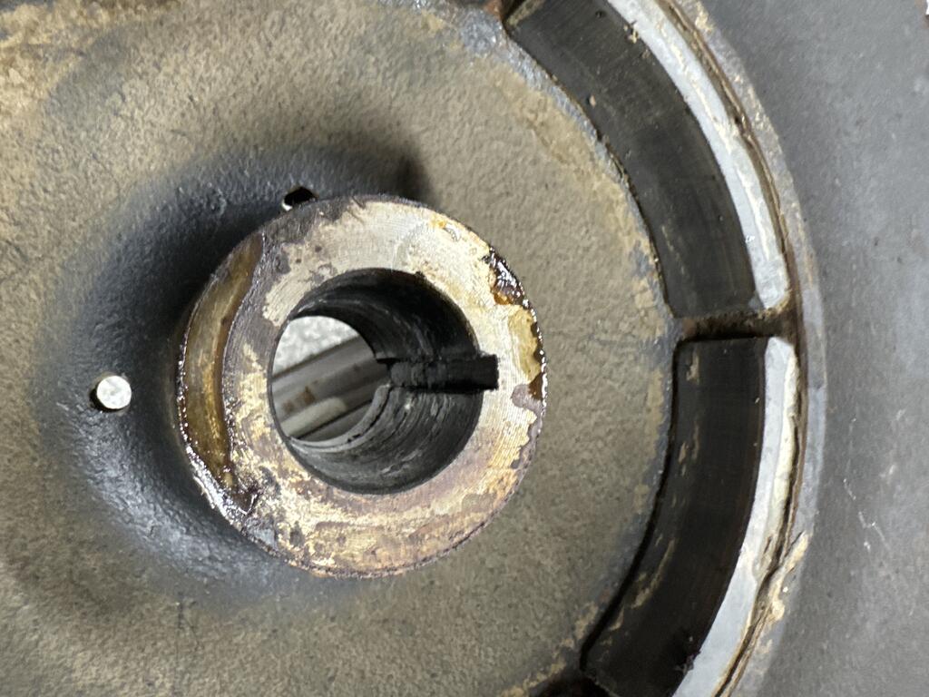

PWL216 1,310 #50 Posted August 16 It’s off! Here’s a picture of the flywheel key. It’s in its slot. Does it look sheared? Should it be longer? Share this post Link to post Share on other sites
