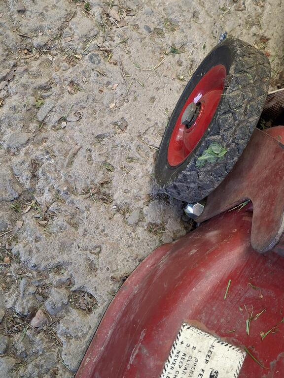

squonk 48,427 #1 Posted May 16 We've all read our operating manuals. HA! YEAH RIGHT!!! They all say check all fasteners before operating! Well I was out mowing with the Wheel a Matic and Dino deck and I got to noticing how low it was cutting. Then I saw both "special 7/16-20 shoulder bolts had fallen out that hold the height adjusting rod!!! I had 1 spare so I had to go to the parts room and get a wheel lug bolt and lug nut to secure the adjuster! 4 1 Share this post Link to post Share on other sites
