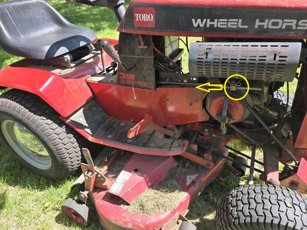

Duddy 7 #1 Posted May 15 (edited) I try engage my mower beck and the clutch sometimes engage and sometimes not. When it engages if will go for a few seconds and then stop not sure whats the problem. Has anyone else had this problem and can help Edited May 15 by Duddy Want to be notified on comments Share this post Link to post Share on other sites
gwest_ca-(File Mod) 12,508 #2 Posted May 15 What year and model of tractor is this? Share this post Link to post Share on other sites
lynnmor 9,050 #3 Posted May 15 What stops in a few seconds? Does the engine shut off? Share this post Link to post Share on other sites
Duddy 7 #4 Posted May 15 The clutch and the mower deck 1 Share this post Link to post Share on other sites

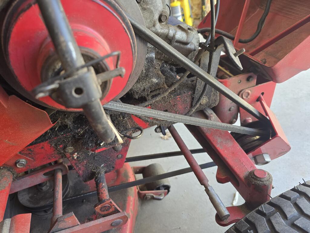

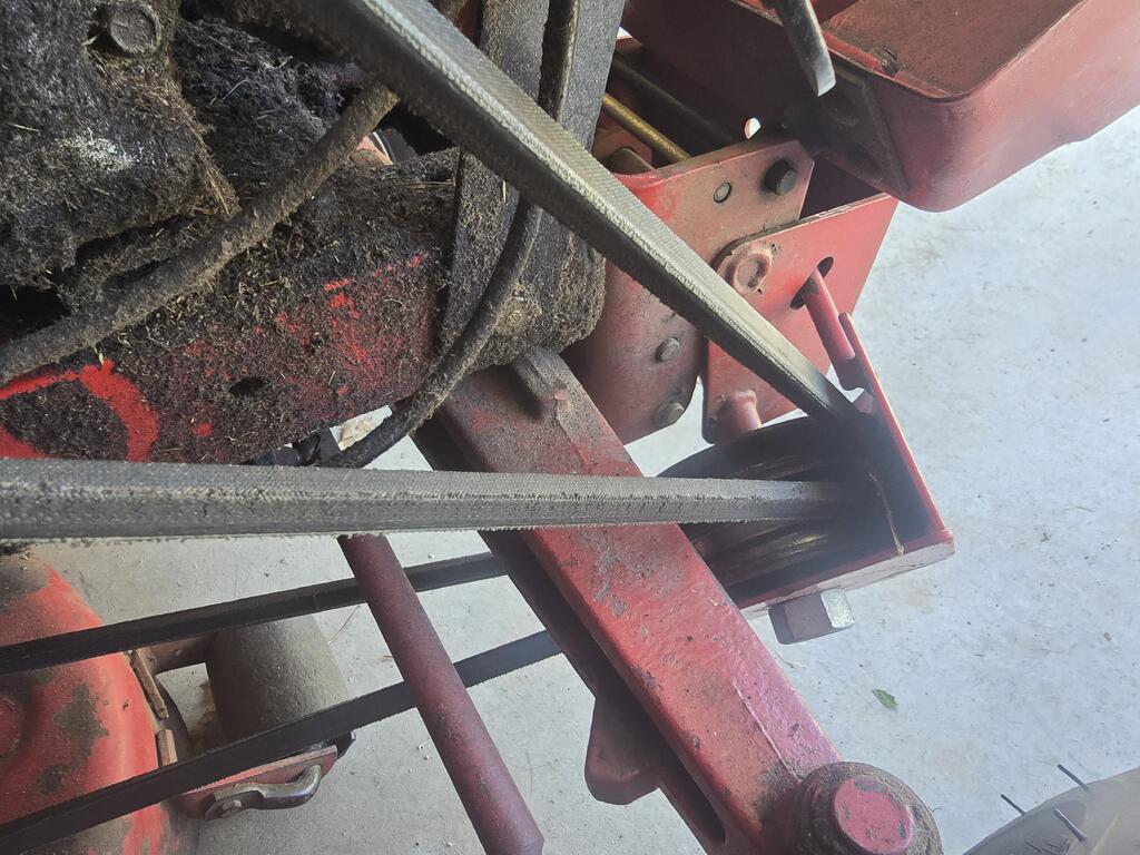

lynnmor 9,050 #7 Posted May 15 Looks like the belt isn't installed correctly on the mule drive, perhaps some photos close to that area might help. 1 Share this post Link to post Share on other sites
wallfish 20,656 #9 Posted May 15 Try this Remove the pin Drop down the rod tighten the trunion towards the seat a few turns Re-install and try it The lever should hold somewhat stiff once cantilevered over 1 1 Share this post Link to post Share on other sites
Duddy 7 #10 Posted May 15 I have twisted it back as far as i can into the triangle piece to engage the clutch. And it still stops 1 Share this post Link to post Share on other sites
lynnmor 9,050 #11 Posted May 15 The belt does appear to be routed correctly. What is up with the welding and grinding on the clutch hoop and the rod? Note the offsets and larger diameters where the welding took place. 1 Share this post Link to post Share on other sites
Duddy 7 #12 Posted May 15 When we try to twist the trunion back the rob broke. We need to mow so we improvise and it worked Share this post Link to post Share on other sites
oliver2-44 11,777 #13 Posted May 16 16 hours ago, Duddy said: When we try to twist the trunion back the rob broke. We need to mow so we improvise and it worked Something isn't right. it took a lot of force to break that hoop Is the threaded rod bent which is distorting the threads that the trunnion turn on? Share this post Link to post Share on other sites
Duddy 7 #14 Posted May 16 We held the pieces together to get the right angle and it did work for a little bit after that. Share this post Link to post Share on other sites
