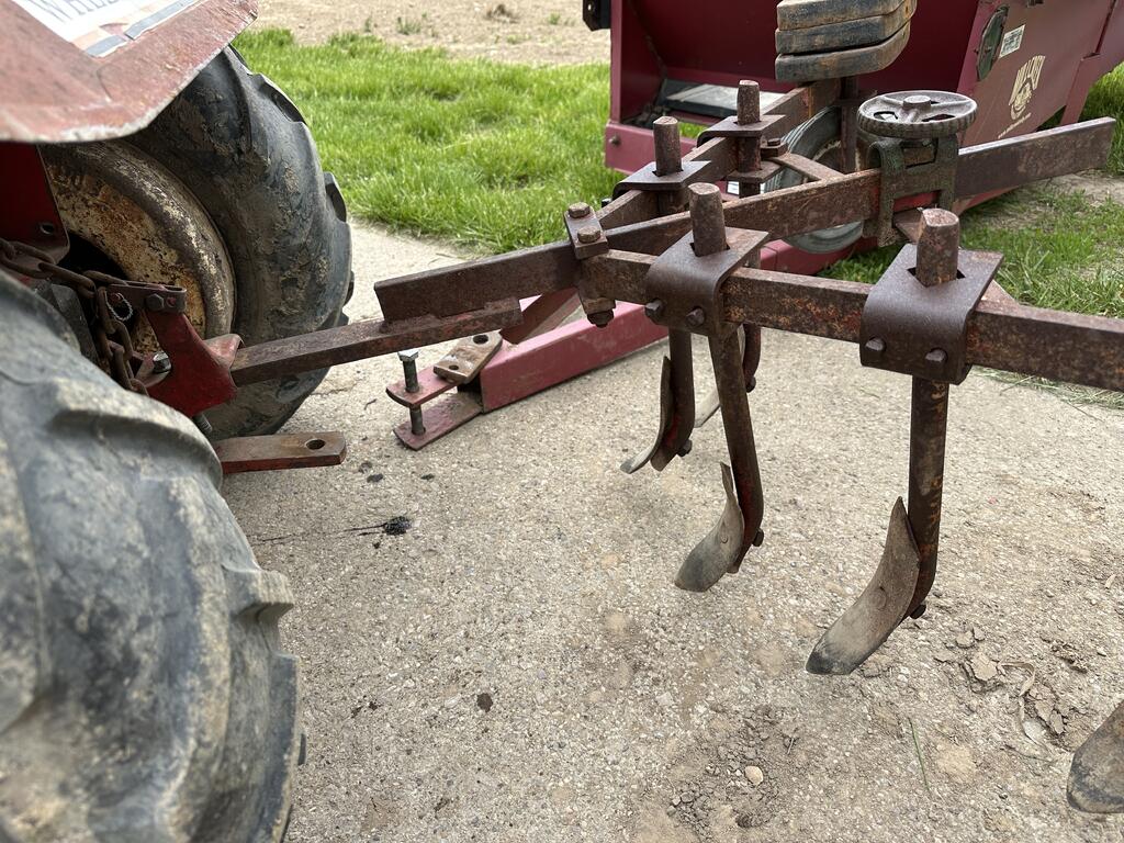

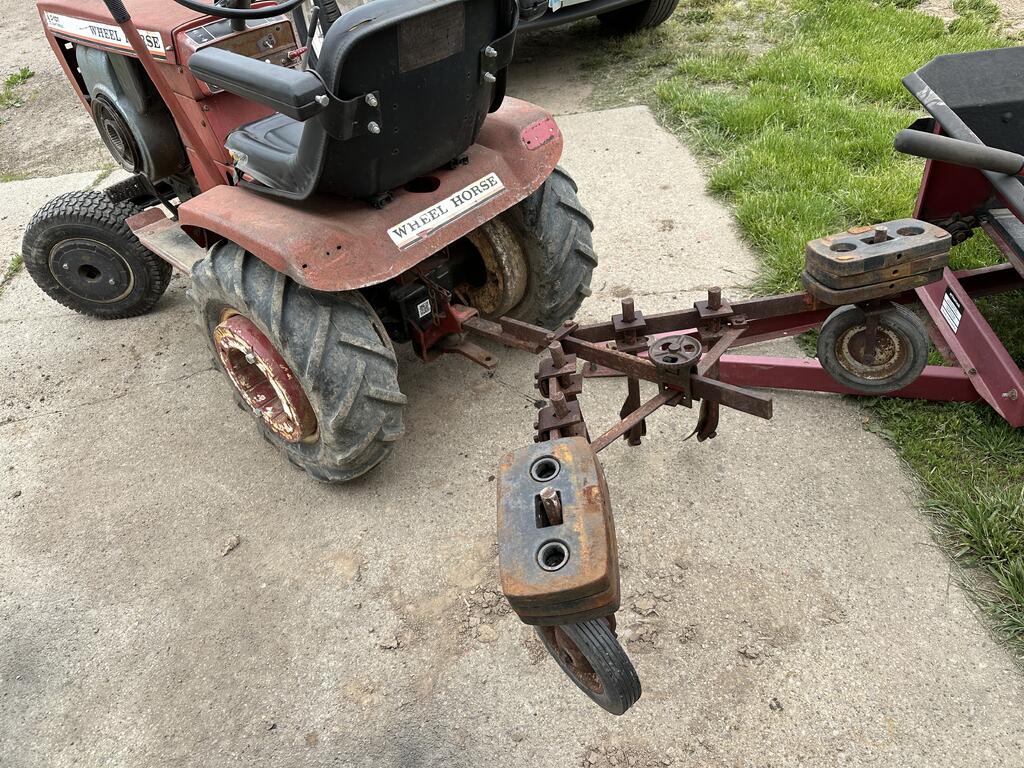

Pullstart 70,423 #1 Posted May 15 The 23x8.50 Deestones on this rig are more like 6-12 tires. That, and the addition of a rock shaft, my lift height was lacking on this cultivator. I’m not sure what correct is, but I flipped the main hitch bar and was able to get a couple inches of real estate that made a big difference. Food for thought… 3 2 Share this post Link to post Share on other sites
Achto 32,035 #2 Posted May 16 9 hours ago, Pullstart said: Food for thought… If you can, slide the center bar further forward so that there is less sticking out the back. This will cause the tines to be lifted further in the air. 1 Share this post Link to post Share on other sites

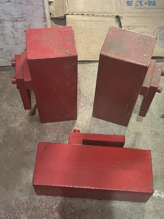

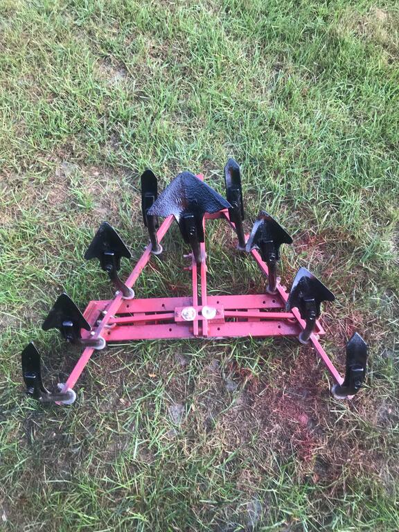

Lane Ranger 12,023 #5 Posted May 16 I rigged up this cultivator several years ago with a mix of different blades to cut out weeds between vegetable garden rows. This rig cuts out weed growth 30 to 34 wide with ease. I have one like Kevin’s and i have some machinist made weights i use but i prefer my cultivator with the Danish tines! I also have 3 machinist made weights numbered 1,2,3 that weigh 19 pounds each i use on both of my cultivators! Work great. 2 Share this post Link to post Share on other sites
