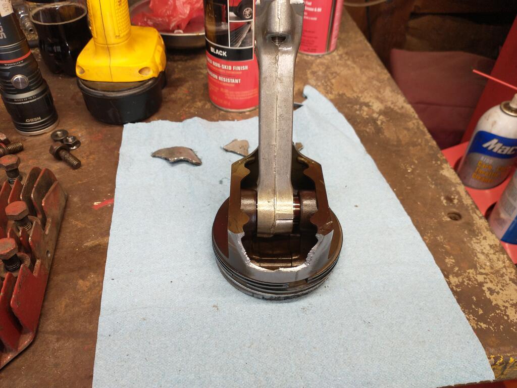

squonk 48,126 #12 Posted May 14 The noise is very similar to piston slap or wrist pin. Back in the day when I was in the auto shop we had tons of GM and Chrysler 4 bangers that would rattle under a light load like de-acceleration. They pretty much ran forever. The few I had apart had loose wrist pins. Now My C-160 had this noise for years. One spring it got noticeably louder. So I swapped it out with another engine. I found a balance gear needle in the pan and this broken piston. It's a simple job to remove the head or pan and take a look inside if you're not sure. Share this post Link to post Share on other sites
