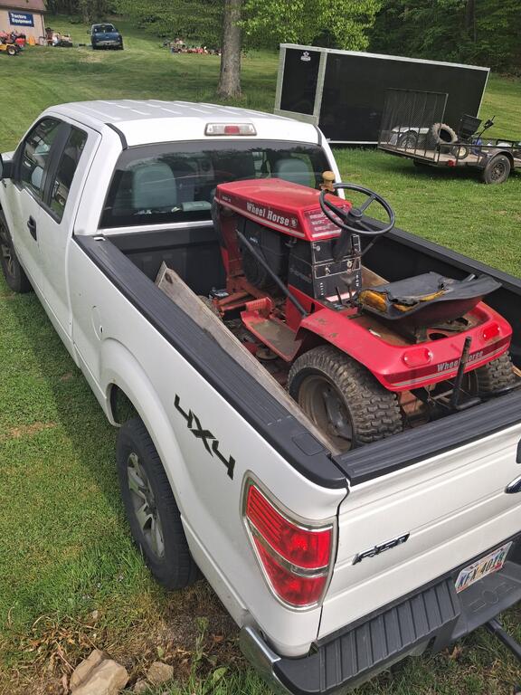

Fivehorsetown 18 #1 Posted May 13 Picked up this 308-8 for my girlfriend's son's first tractor today. I have an extra under the fender tank off a 310-8 that I'd like to put on it to use instead of the little 1 gallon on the engine. Has anyone done this and any advice? Thanks! 4 Share this post Link to post Share on other sites

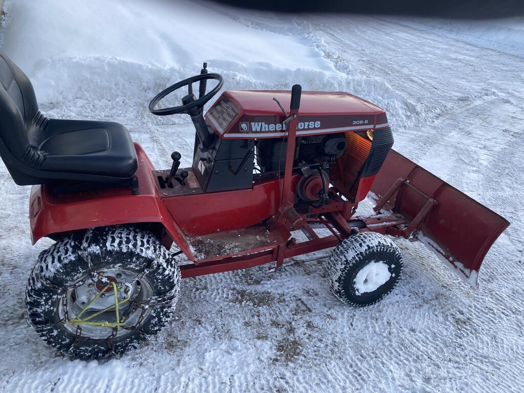

MainelyWheelhorse 3,133 #4 Posted May 13 @Fivehorsetown I added an under seat tank to my 308-8. It seems to go longer between fill ups but will still pull from the small tank before it pulls from the larger tank. I’ve only run it out once with both tanks. I do have a shutoff to attempt to switch between the two but it still needs work. The U shaped piece will need to be changed over to one from a tractor with a tank as the 308’s isn’t set up for it. I’d say try it and if it doesn’t work take it off. 2 1 Share this post Link to post Share on other sites
