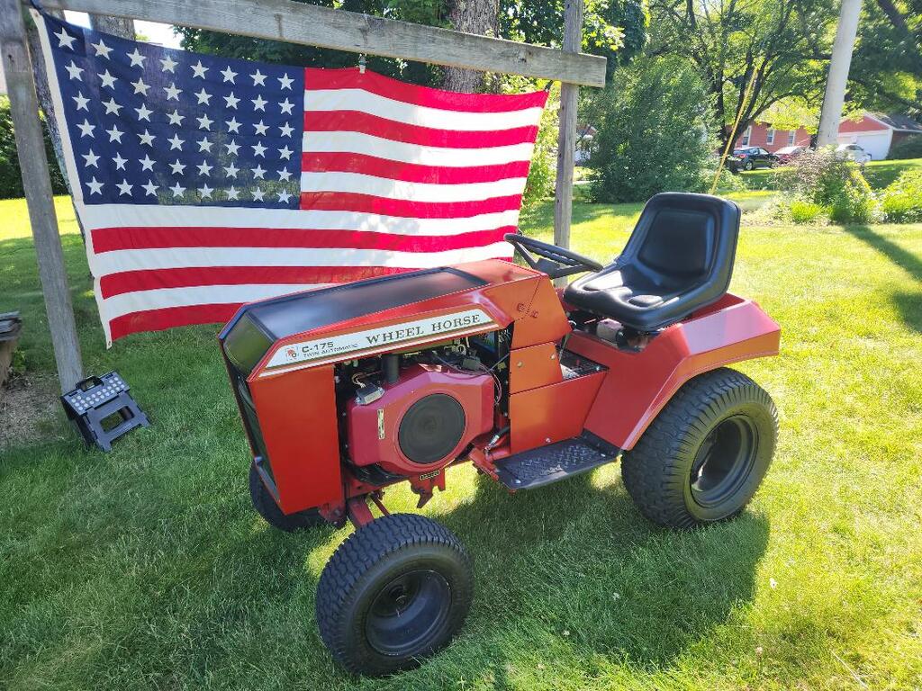

Brockport Bill 2,553 #16 Posted May 13 I am fan of the blackhoods ---------- I have two of the C175h models - a S1 and what was a S2 but now the S2 KT 17 has been replaced with a Briggs from an 1800 ( thanks to Bill D ) -------- the C175H with the S1 is my year round worker - snow and yard - I know the Kohlers better than the Onans so the K's are my preference 1 3 Share this post Link to post Share on other sites
Brockport Bill 2,553 #17 Posted May 13 oh yeah as added note - yes, I like the Blackhood -- but I am also fan of the unique seat pan fender on the 175s - an unusual distinction to give one of the horses some different character Share this post Link to post Share on other sites

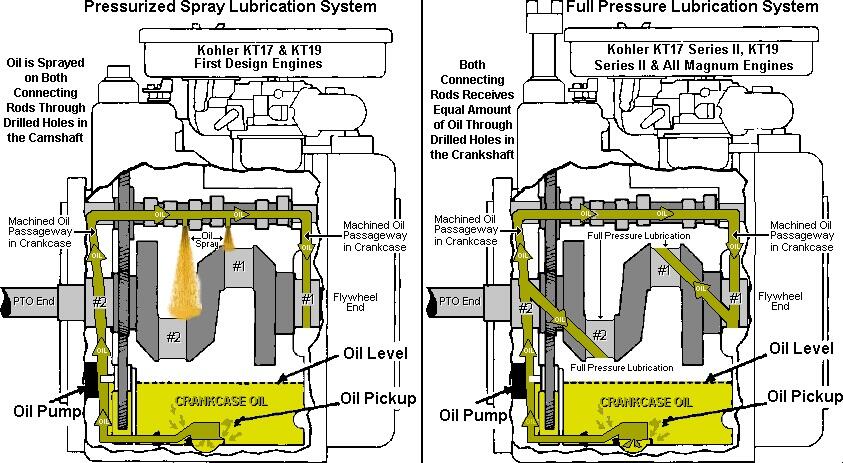

953 nut 70,649 #20 Posted May 13 Oiling of the rod bearings is the big problem with the Series One K-Twins. A spray of oil is directed toward the connecting rod from the cam shaft bearings, if you are going up or down a hill gravity will direct the oil away from the rod. 2 2 Share this post Link to post Share on other sites
cjb398 40 #21 Posted May 13 21 minutes ago, 953 nut said: Oiling of the rod bearings is the big problem with the Series One K-Twins. A spray of oil is directed toward the connecting rod from the cam shaft bearings, if you are going up or down a hill gravity will direct the oil away from the rod. Thanks. I thought from other remarks that the problem was with the oil pickup from the oil reservoir and so people recommend overfilling the oil a bit. Are both oil pickup and the oil spray distribution an issue? 2 Share this post Link to post Share on other sites
