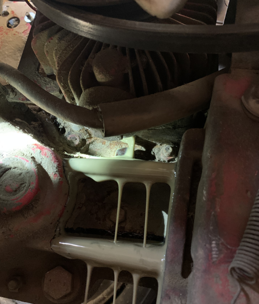

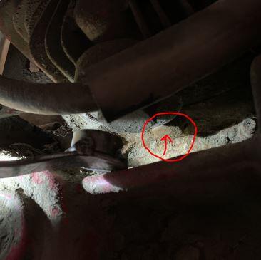

If the machine has the Eaton 11 (has a spin on oil filter on the left side under the seat pan) the drain plug is the main plug located under the rear housing and requires a 1/4" hex wrench.
If it has the Eaton 7, (no oil filter) This transmission has two separate oil compartments. One is the hydro (10w-30 oil) that is dedicated to hydro pump and is captive. The other is rear gearing lubrication. Takes 80w-90 and drains from the main plug located under the rear housing and requires a 1/4" hex wrench.
The Eaton 7 hydro system can be drained and refilled.
The drain plug is an o-ring plug located under the pump unit on the right side.
