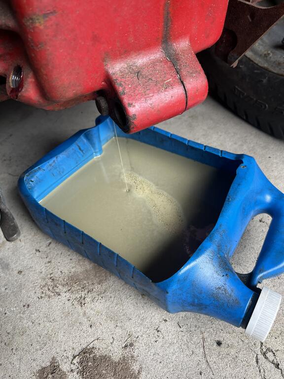

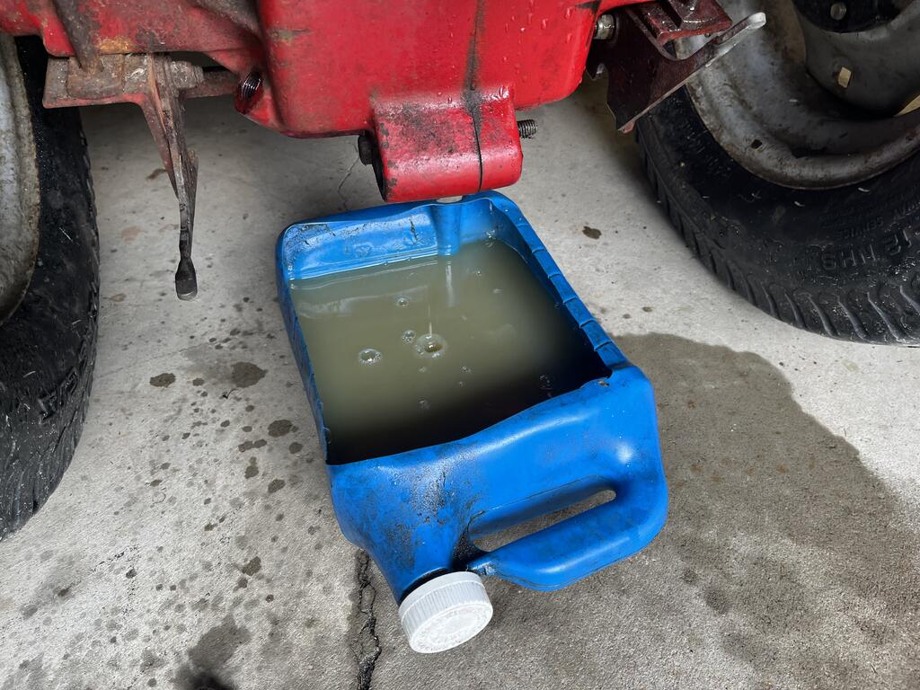

My_horse 131 #1 Posted May 11 Had the 314-8 out and put the mower on to mow the rough areas of the yard. Decided to change the trans oil while it’s good and warm. Probably better than 15 years since it was done last. This is what came out: shift boot is good, tractor is stored in a shed. Should I flush it with diesel or just refill with new oil? thanks 1 Share this post Link to post Share on other sites

ri702bill 13,050 #6 Posted May 11 I do not see the tractor raised so that the wheels can spin freely. Just dropping the fluid and refilling is inadequate to alleviate an issue with moisture in the Unidrive. That leaves too much comtaminated fluid clinging to the innards. A diesel flush is best - but - the Unidrive must be cycled thru all the gears - and hi & low ranges to get the sufficient "waterfall wash". Either by driving it or jacking it up in place. If you want to be amazed with the "waterfall" effect, pull the shifter out while doing the flush & look in.....The differential & gears spinning make for quite the splash. 1 1 Share this post Link to post Share on other sites
Handy Don 17,474 #7 Posted May 11 3 minutes ago, ri702bill said: ...The differential & gears spinning make for quite the splash. The pinions and other differential internals only get worked when the rear wheels turn at different speeds--do some circles on your “drive around”! 2 Share this post Link to post Share on other sites
ri702bill 13,050 #8 Posted May 11 And DO look in the botton of the pan as you empty it for any "Gee, I don't think these should be here" bits - broken gear teeth, metal particles, or stray loose bearing needles.... Finding those is a game changer..... 3 Share this post Link to post Share on other sites
