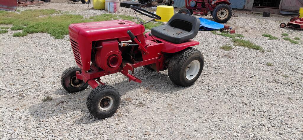

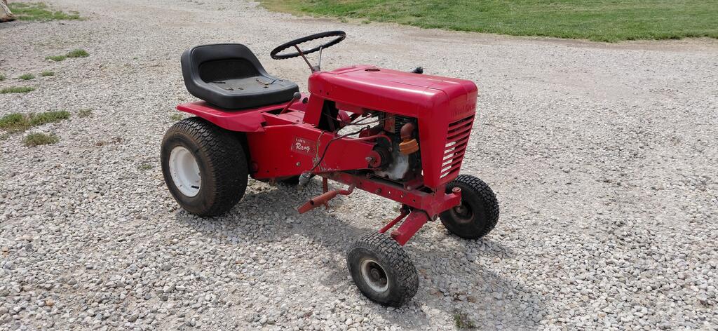

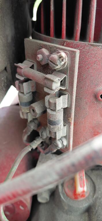

Easton Rich 1,291 #1 Posted May 10 This is my L-155 I bought last year in the spring. It started and ran just fine until July when I was unloading it at a show. It started and ran fine, but died and never restarted. I thought it was either the ignition or the starter. Is it this diode board? Can I delete it and add a solenoid instead? 1 1 Share this post Link to post Share on other sites
gwest_ca-(File Mod) 12,557 #2 Posted May 10 That board has nothing to do with starting. Battery charging only so the addition of a solenoid will not fix it. The magneto ignition is self powered and the wire going to the ignition switch simply grounds the magneto coil to shut it off. Adding a solenoid would remove the heavy starting load on the ignition switch and a good idea to keep the expensive switch working. 7 Share this post Link to post Share on other sites

pfrederi 21,342 #8 Posted May 12 You said you had fuel and spark in a post above. You do not need a recoil. There is a rope pull setup on the tractor in the picture when you pull it over do you feel compression?.. As pointed out above you need fuel, compression, and spark (at the right time.) Share this post Link to post Share on other sites
