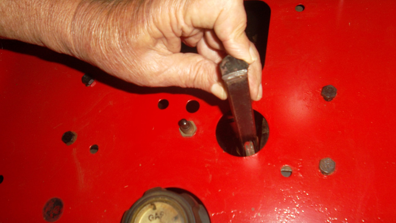

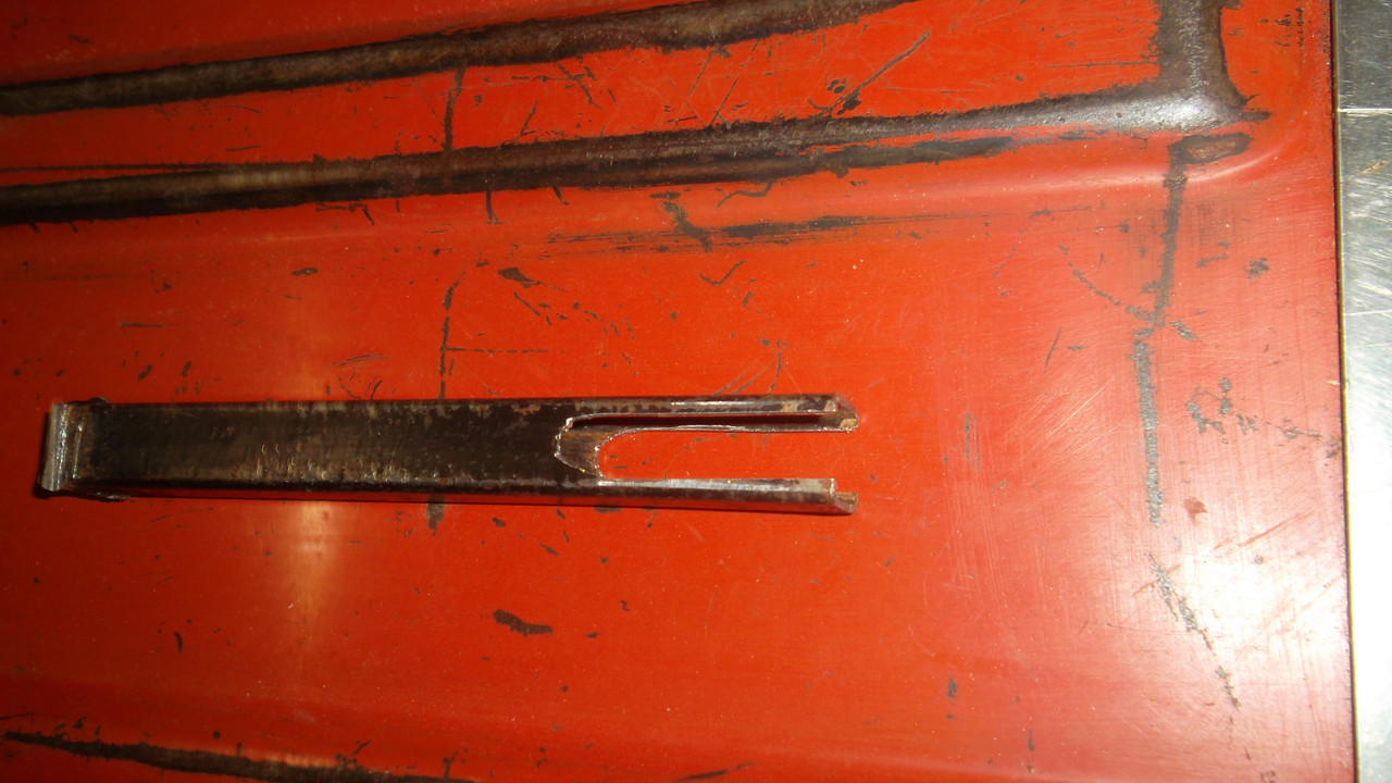

DLF 74 #8 Posted May 13 The rubber seal on thoes dip sticks gets hard and almost imposable to push on. I made a tool to fix that. Slit a large dowel. steel tubing, or old broom to clear the pull handle. Place on dip stick cap and tap with small hammer it will slip on. 1 Share this post Link to post Share on other sites
953 nut 70,651 #9 Posted May 14 21 hours ago, DLF said: The rubber seal on thoes dip sticks gets hard and almost imposable to push on. I made a tool to fix that. Slit a large dowel. steel tubing, or old broom to clear the pull handle. Place on dip stick cap and tap with small hammer it will slip on. 1 Share this post Link to post Share on other sites
DLF 74 #10 Posted May 14 I can show you the tool, don't have anybody to take the picture. of me using it. Best picture of me holding i And the tool laying on my tail gate. It's a piece of 1/2" square tubing, could be anything that fits trough the hole. 3 Share this post Link to post Share on other sites

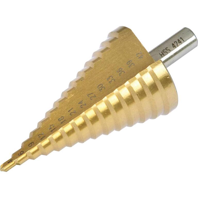

wallfish 20,744 #12 Posted May 15 Use a step bit. Drill out the tube just a bit and it'll slip back in but still stay tight like it's supposed to. Then there's no tools required afterwards. Shove a paper towel or something down in there first to keep the plastic from falling in and I run a shop vac to suck them up while drilling. Just go slow and test it each time. You could probably heat up that tube and use the step bit as a flaring tool without drilling too 1 Share this post Link to post Share on other sites
DLF 74 #13 Posted May 15 2 hours ago, 953 nut said: I thought you had developed a tool to fix the rubber seal. It does get easer after it has been forced on a few times. The rubber seal gets so hard you can't force it on with the pull handle. It's for when you have work to do, you can get the cap back on and go get it done. Share this post Link to post Share on other sites
