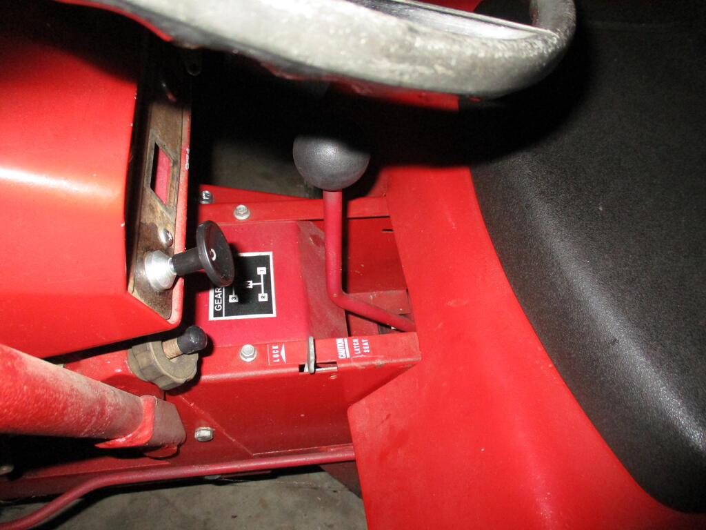

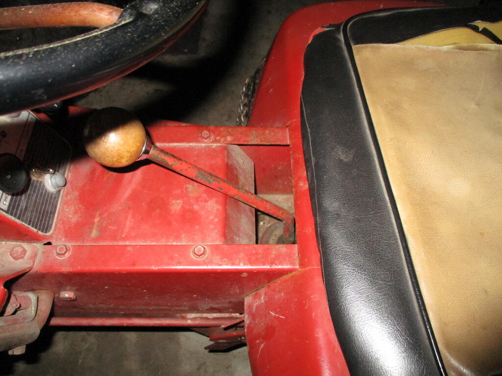

pfrederi 21,150 #13 Posted May 9 Pulleys should be OK however you may have to swap the gear shift lever. First picture is Commando 8 second L-107. Neverpais much attention but rgere are alot of variations in shift levers. L-107 #5279 753 #4440 856 #5633 Commando 8 #5632 Share this post Link to post Share on other sites
