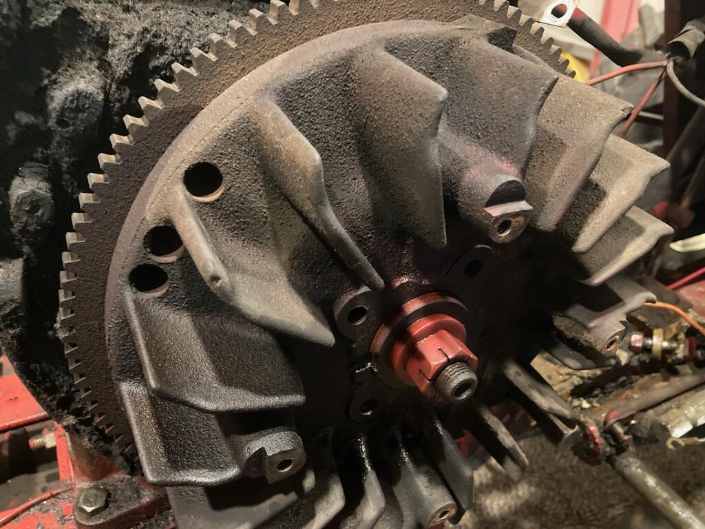

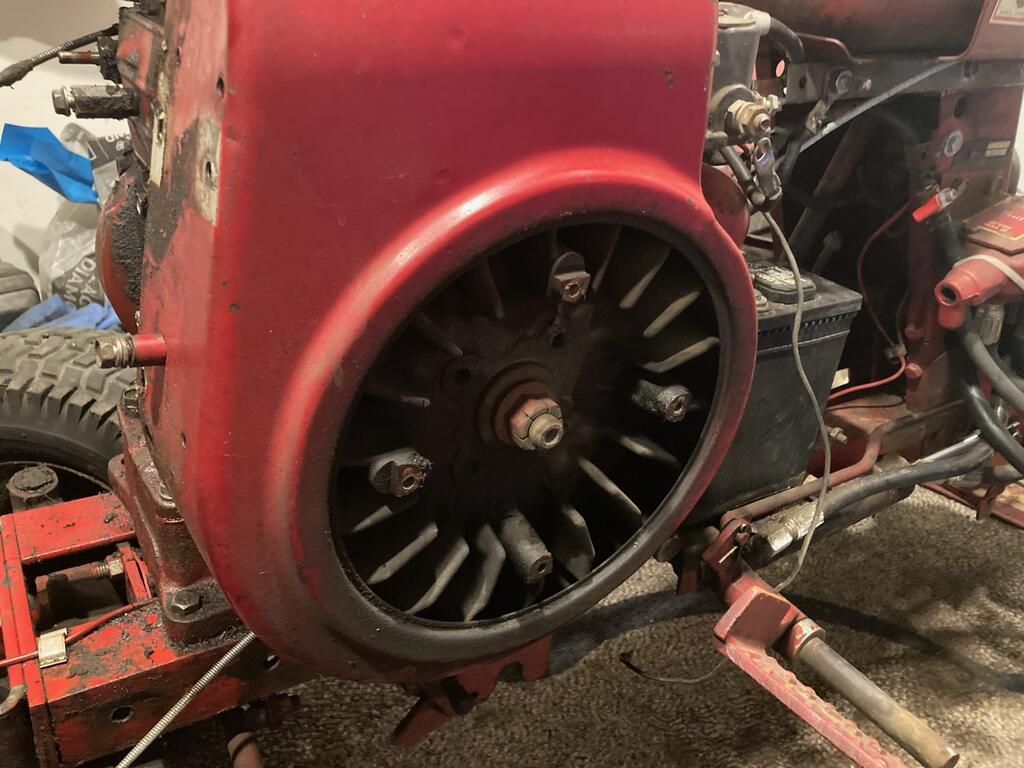

ineedanother 2,864 #1 Posted May 8 My apologies if this has been addressed before since I suspect it has, but I got exhausted before the search did I need a good puller for this flywheel (k341). This one has likely never moved since installed but it's in pretty good condition. I could probably manage but wouldn't shy away from acquiring a good tool for this since I have a few others with similar needs. TIA. 1 Share this post Link to post Share on other sites
wallfish 20,611 #2 Posted May 8 (edited) No puller required Wedge the flywheel from the back against the plate but not super tight. I use 2 large screwdrivers spaced apart on each side. Loosen the nut so it's at the edge of the threads plus a tad tp protect the threads. Smack the nut with a brass hammer and viola. the flywheel is off. A piece of hardwood and any old hammer will wok if you don't have a brass hammer. I've yet to have a flywheel that didn't come off doing it this way Edited May 8 by wallfish 7 Share this post Link to post Share on other sites

wallfish 20,611 #6 Posted May 8 6 minutes ago, ineedanother said: That's how I've done it in the past and trust it, but have always been concerned about damaging the bearing plate and I don't think this one has been off in 50 years. Don't pick the weak points of the plate to wedge it and it'll pop off without breaking the plate. Doubtful most I've popped off were ever done before. Did you actually try it yet? You can use wood wedges behind it but then you gotta smack that nut/crank end much harder to make up for the give of the wood. 2 Share this post Link to post Share on other sites
ineedanother 2,864 #7 Posted May 8 2 minutes ago, wallfish said: Don't pick the weak points of the plate to wedge it and it'll pop off without breaking the plate. Doubtful most I've popped off were ever done before. Did you actually try it yet? You can use wood wedges behind it but then you gotta smack that nut/crank end much harder to make up for the give of the wood. No, I haven't tried yet and don't doubt that I can get it off but just looking for best practice to avoid any adverse outcomes. I'm pretty confident I can wedge it off with pressure and impact. 2 Share this post Link to post Share on other sites

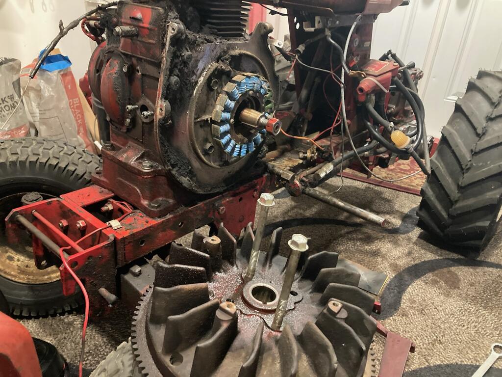

ineedanother 2,864 #13 Posted May 8 11 hours ago, squonk said: The proper type of puller is a harmonic balancer puller. Cheap enough and if you're cheaper you can rent them at some auto parts stores. Clean out the bolt holes with a tap first! Yep. Chased the threads first Share this post Link to post Share on other sites
