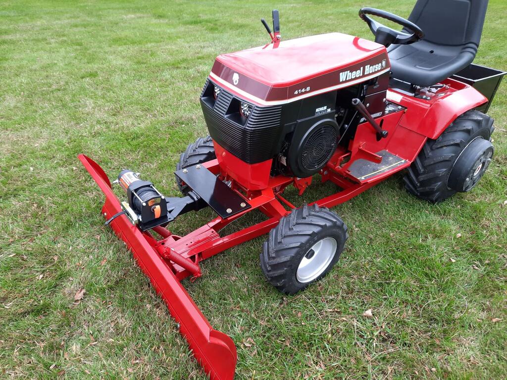

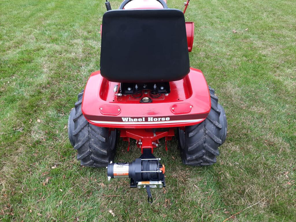

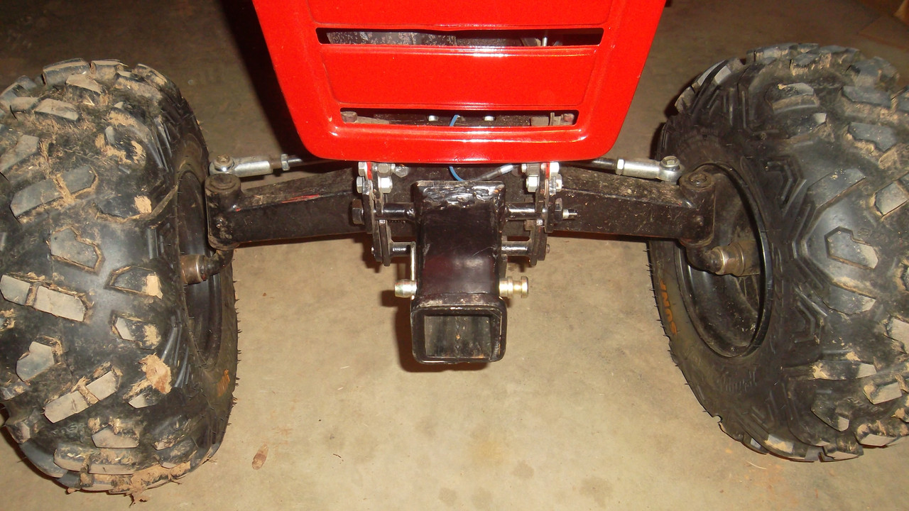

CCW 1,519 #2 Posted May 7 (edited) @SamHit This is what I did with my 312-8. See the thread. One of the hidden features is I add some spacers to widen the space of the arms extending back to the frame. This gave enough room for the mule drive to mount. Edited May 7 by CCW 1 Share this post Link to post Share on other sites

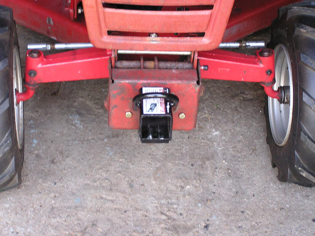

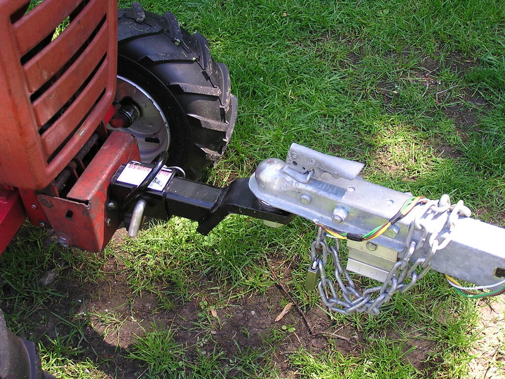

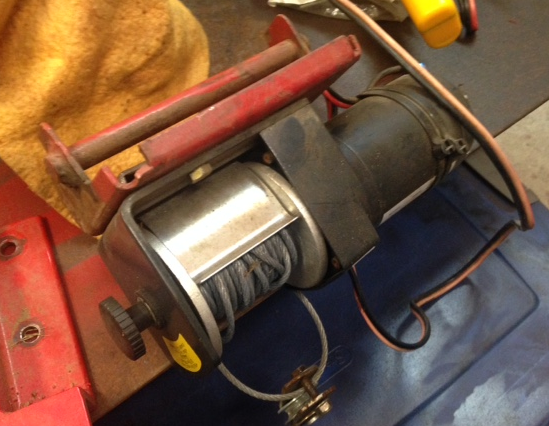

ri702bill 13,051 #3 Posted May 7 (edited) Welcome! Consider doing just what CCW did - the axle sees enough loading as is. Better to mount to the frame... or... if it is for temporary use, How about an adapter to go into a front receiver hitch? I used an old rusty Mule Drive & a HFT ATV receiver. Still allows the hood to open normally. Edited May 7 by ri702bill 1 2 Share this post Link to post Share on other sites

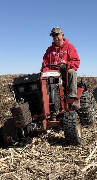

SylvanLakeWH 32,500 #4 Posted May 7 I use mine for weights when plowing, winch for raising / lowering my snow plow blades, and a 2" hitch to move trailers around... 4 1 Share this post Link to post Share on other sites

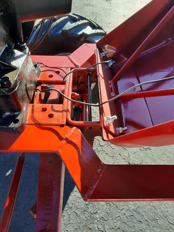

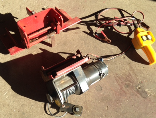

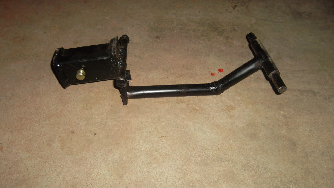

JoeM 10,267 #5 Posted May 8 I made up this crazy contraption using an old mule drive plate. I could use it on the front or back. 1 5 Share this post Link to post Share on other sites

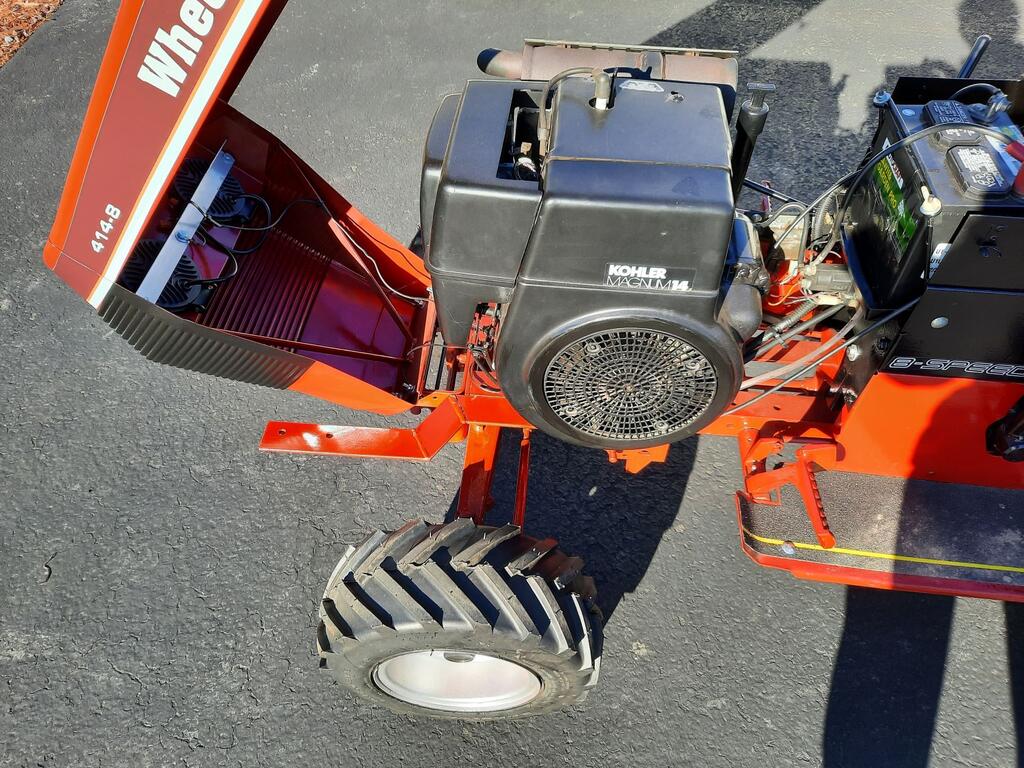

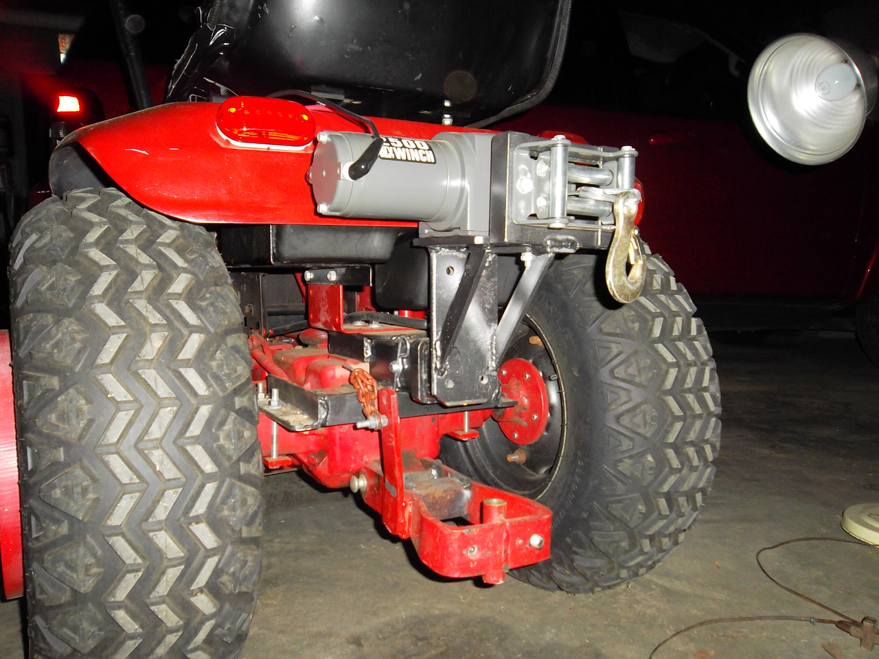

David414 323 #6 Posted May 14 Used same size angle iron as tractor frame. Mounts using 3, grade 8 bolts per side, bolts to tractor frame. Has removable receiver plate bolted to the angle iron with 4 bolts that allows plate removal for unobstructed hood opening. I later drilled the mounting plate and bolted winch directly to plate to allow usage of both receiver hitch and winch at same time. The winch when mounted in the arm, can be used in the rear receiver as well. The extended frame works as is with snow blade and when using the bervac 44" 2 stage snow thrower, the right-side frame rail must be removed. 4 Share this post Link to post Share on other sites
CCW 1,519 #7 Posted May 15 @David414 Wish I had seen this one before building my winch mount. The 45 degree extensions from the frame are a great addition for width. Share this post Link to post Share on other sites

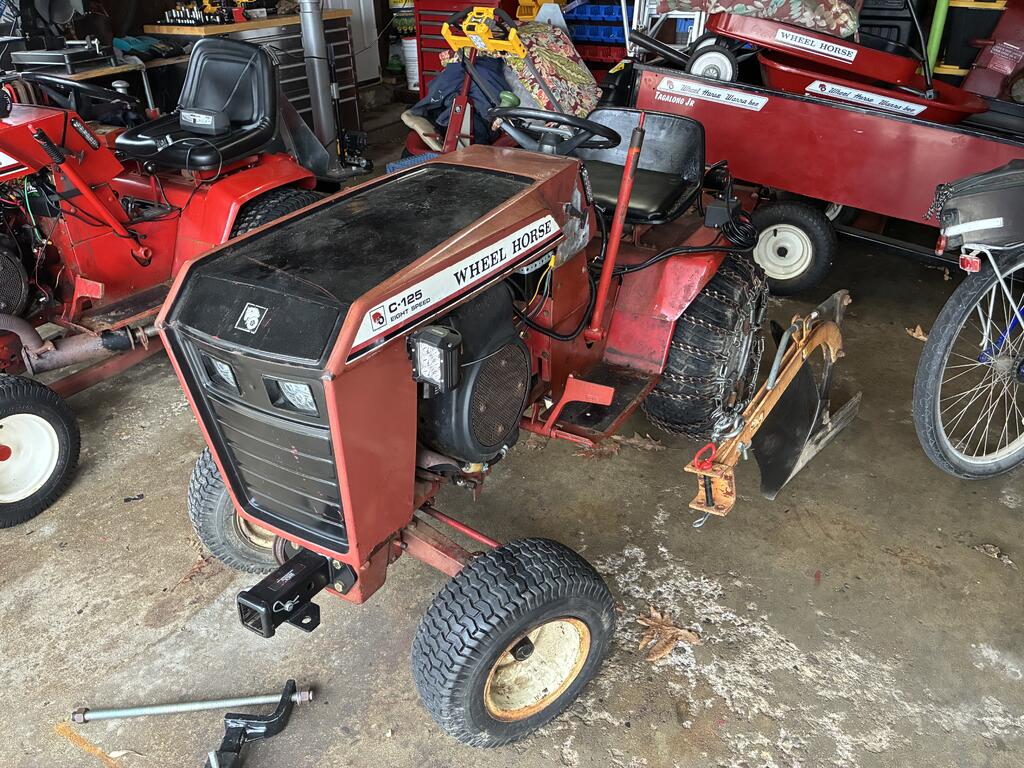

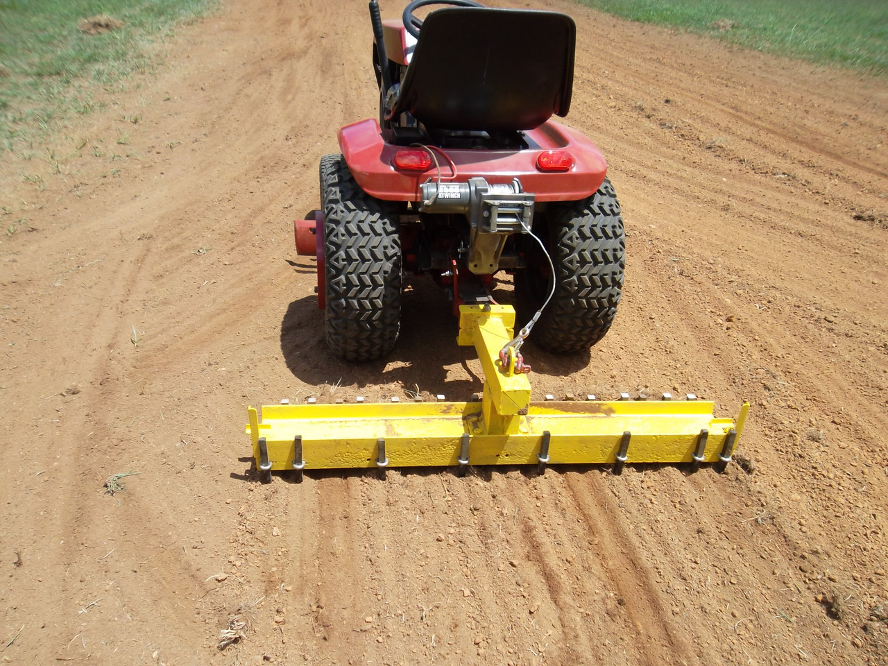

DLF 74 #8 Posted May 15 My wench is mounted on a receiver hitch in the rear and used for a rear lift. I built a front receiver hitch at doesn't used a mule drive. there are at least four more built by different members. [url=https://postimg.cc/YLhMhbj5][/url] Lee1977 Share this post Link to post Share on other sites
