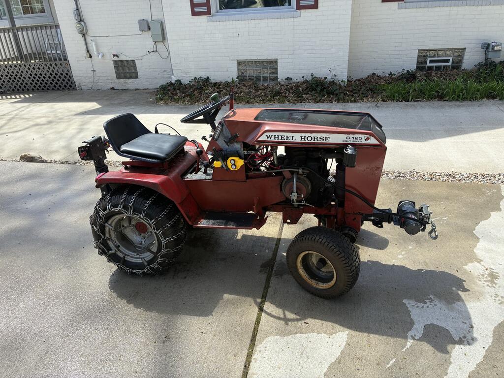

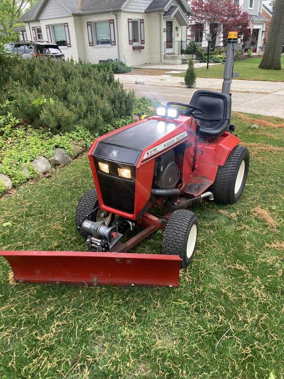

Here's how I did mine:
2" hitch mounted on front attachomatic... Harbor Freight atv winch on a 2" receiver winch plate.
