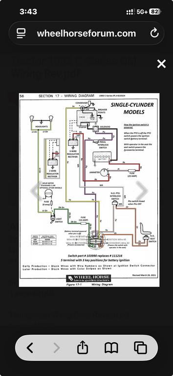

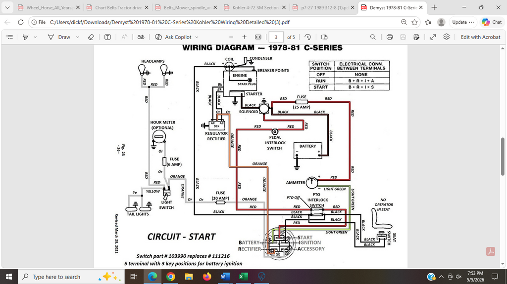

SylvanLakeWH 31,665 #12 Posted May 5 4th page of download 1 1 Share this post Link to post Share on other sites

953 nut 67,194 #18 Posted May 6 11 hours ago, Joshyg said: It’s the 01-14ks01 1980 automatic and the brake pedal switch was cut by the previous owner and I don’t know where those go Have you checked to be sure there is power to the "B" slot in the ignition switch harness connector? Thank you, since the brake switch was already removed and everything worked without it that is one less thing to be concerned about. based on the wiring diagram the only components between the ignition switch plug and the solenoid are red wires and the PTO switch. Use your electrical meter to determine if the PTO switch is working as it should. With the PTO off and with the small jumper in place in the ignition switch harness between the "B" and "S" sockets put one lead of the meter to ground and the other lead of the meter (or a test light) on a PTO switch terminal with a red wire going to it, is voltage present? Now move the other terminal of the PTO switch with a red wire and see if voltage is present. If both terminals have power then the problem is somewhere in the red wires beyond the PTO switch, perhaps where the previous owner removed the brake switch. Share this post Link to post Share on other sites
