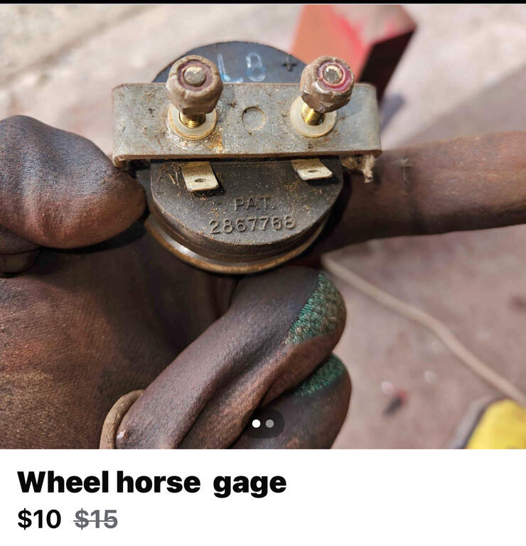

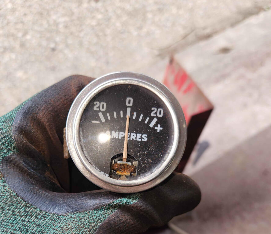

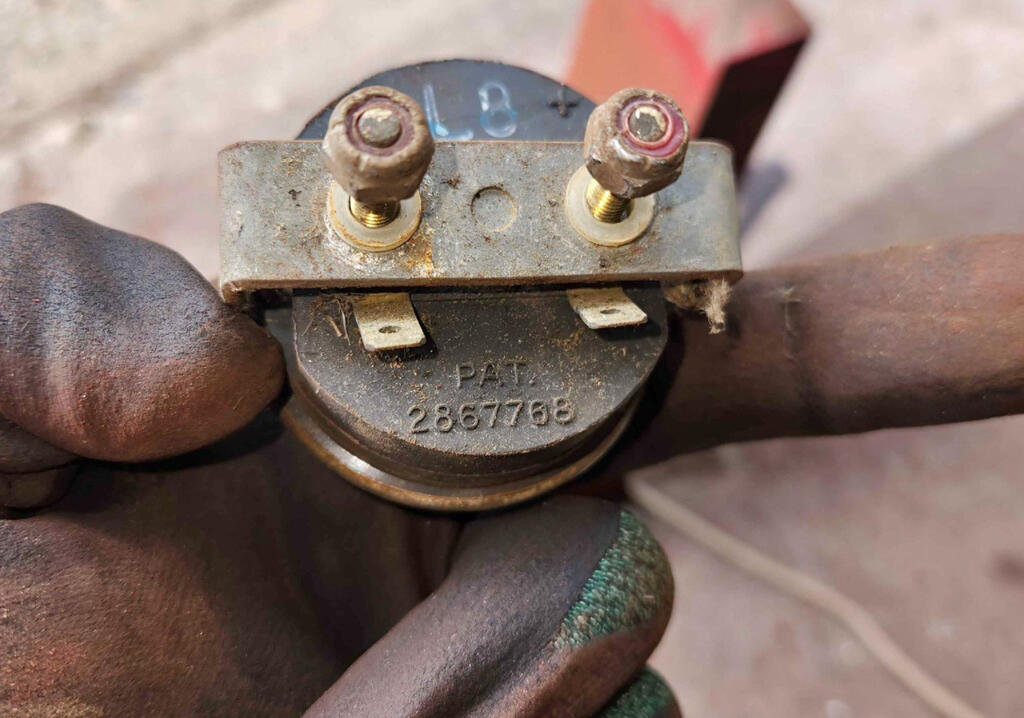

FLtractor 232 #1 Posted May 5 (edited) Evening, Saw this on marketplace.. is it actually from Wheelhorse? Be worth it to somehow somewhere (don’t have availability on dash) put on my 856? Edited May 5 by FLtractor 1 Share this post Link to post Share on other sites
Retired Wrencher 6,989 #2 Posted May 5 You do not need it but if you feel up to it go for it. Share this post Link to post Share on other sites
ri702bill 13,084 #3 Posted May 5 (edited) Yes, it appears to be the period correct part...but.... a lot of folks ditch the ammeter and use a voltmeter in its place. Thw ammeter can have two serious issues. If the circuit goes to an open state, there is no charging as the path is incomplete. Worse, and this does happen, if the ammeter fails and develops an internal short to ground, all the battery amperage discharges there - (unless you had already added a fuse) and the thermal event begins. Remember just where that gauge is located - right behind the gas tank...... Edited May 5 by ri702bill Share this post Link to post Share on other sites
953 nut 69,475 #4 Posted May 5 Its your money, feel free to waste it as you see fit. Share this post Link to post Share on other sites
pfrederi 21,172 #5 Posted May 5 If your idiot light works do not see the need for an ammeter Share this post Link to post Share on other sites
Handy Don 17,484 #6 Posted May 5 Being a bit of a belt and suspenders guy, I have both an ammeter and voltmeter. A voltmeter tells you the charging system is or isn’t generating adequate voltage but only an ammeter tells you what current is going into or out of the battery. The safety part is adding a fuse between the battery and the ammeter so that a shorting failure doesn’t get out of hand. 2 Share this post Link to post Share on other sites
