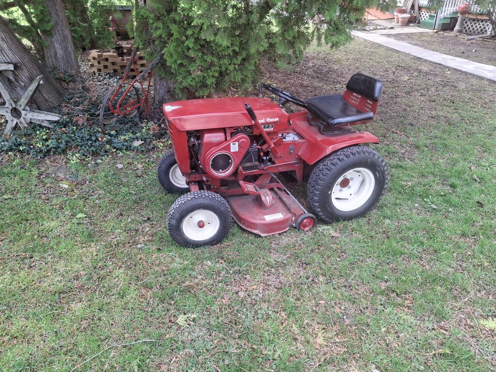

 After 40+years i finally sent the 3416H Simplicity to a new home, I acquired a 857 w/deck a couple of years back, and have been mowing with it. I like it because of the turning radius and overall compactness. The 8HP Kohler is very fugal on gas and it just runs great.
 What I miss is the hydrostat. They are great to mow with as your ground speed and blade RPM are not directly related to the throttle. So, as I am a habitual tinkerer, is there a hydorstat unit that will bolt up in place of the 3 speed gear box?

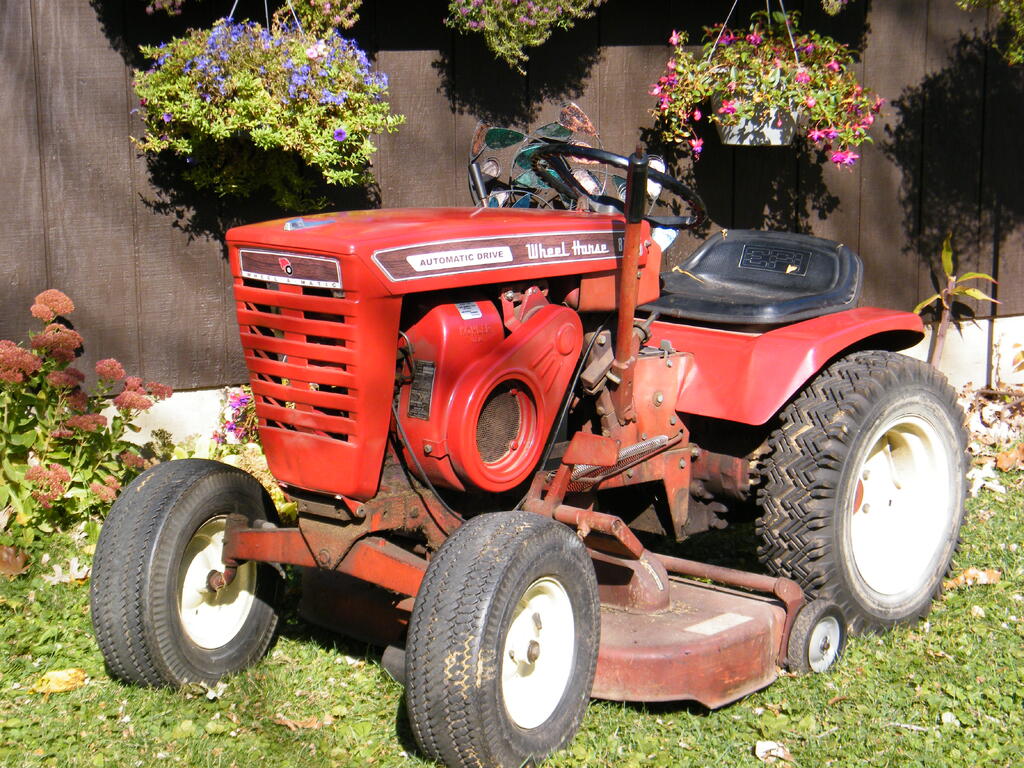

875 Wheel a Matic!

I recomend one of each.  Mine, an 857 and the other an 876 have the best of both worlds.  I have not noticed any power loss due to being an auto.  My ground is level though.  :occasion-xmas:
857
876
  • Like 1
