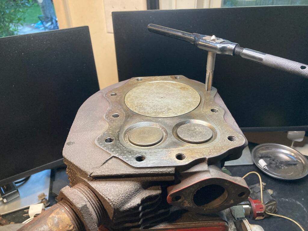

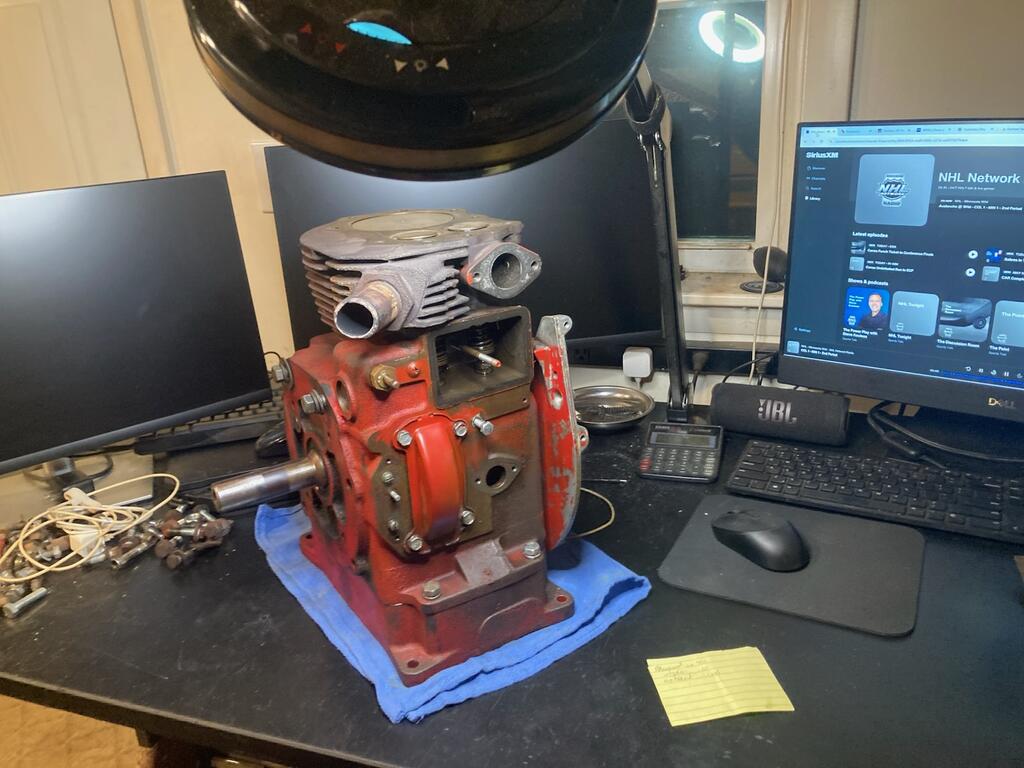

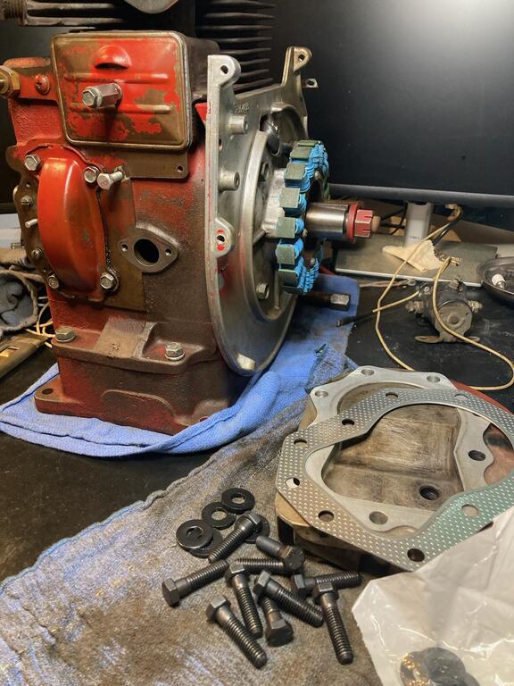

ineedanother 2,864 #30 Posted May 15 Waiting on an oil pan gasket to start much reassembly but the head bolts came today so I thought I would go ahead and start on some of that. Blocked the head on granite with some 320 grit. Nice and flat . Chased the threads in the block, adjusted the valves and reassembled the breather. I'll wait to torque the head until it's back on the frame. It's just easier when it's not sliding around on the bench. 3 4 Share this post Link to post Share on other sites

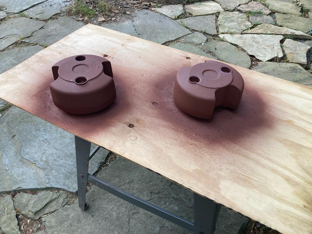

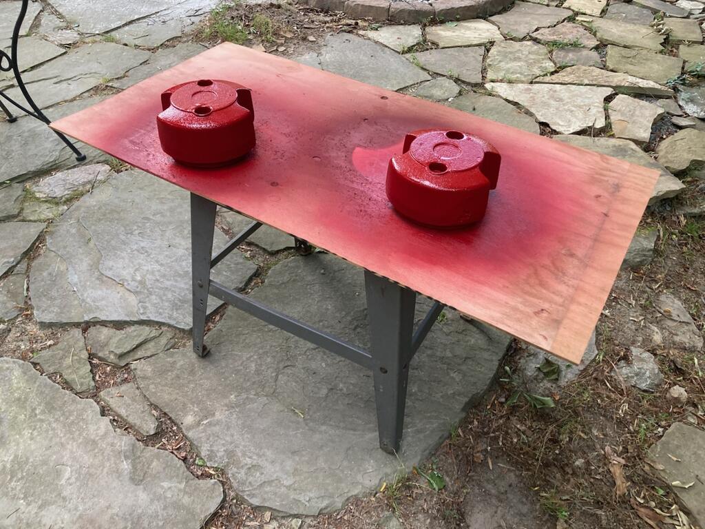

ineedanother 2,864 #31 Posted May 18 6-8 days delivery for the oil pan gasket so I've caught up on some chores around the house and painted the front wheel weights...but this is a good time (pun) to set the timing...I'll attach the ground wire with a new grommet and dialectric grease when it's ready to brrrrrrr. 2 Share this post Link to post Share on other sites
ineedanother 2,864 #32 Posted May 18 Forgot the pics I swear...I haven't weighed them but they're heavy. 3 2 Share this post Link to post Share on other sites

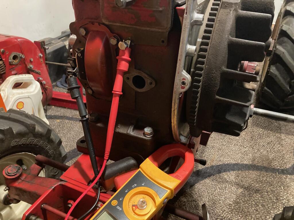

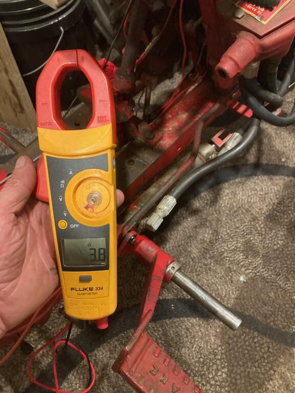

ineedanother 2,864 #33 Posted May 20 The oil pan gasket finally shipped this morning but...USPS I suspect it will be creased right between the "O" and "T" in "DO NOT BEND" but we'll see. Installed in-line fuses for the clutch and ammeter. Not much else to do until I get the block bolted down. 4 1 1 Share this post Link to post Share on other sites

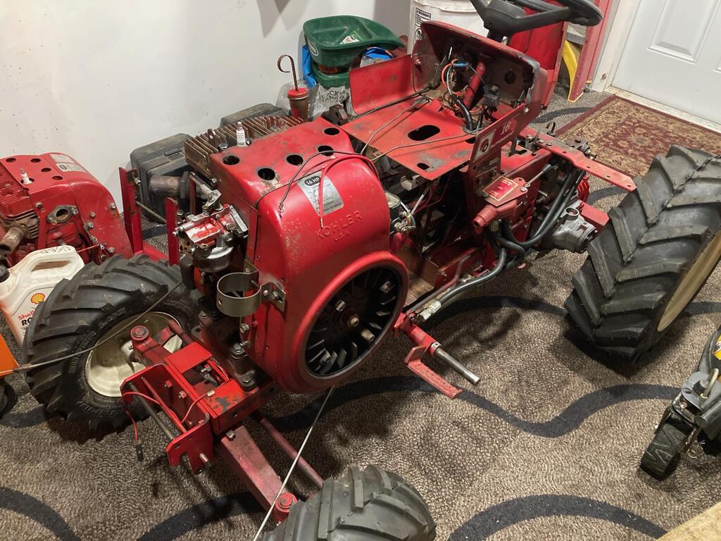

ineedanother 2,864 #35 Posted May 24 This might look like a bit of a mess but hopefully that's because my shop is so small. Some progress...engine back together and bolted down. All wiring tidied up and ready to finish. Throttle and choke cables robbed from donors. Battery box and belt guard repaired but I won't brag about my welding Most of the long block components are back in place. Shout out to my wife for appreciating how enjoyable this is for me to get in the shop and work We did manage to get steaks on the grill and share a bottle of wine in spite of the weather . 3 3 Share this post Link to post Share on other sites
ineedanother 2,864 #36 Posted May 25 Quite a bit of progress today but it's raining like you know what so everything got pushed back into my small shop. I made myself be patient with the wiring, throttle and choke cables, and getting the sheet metal back in place. I have to find a solution for the exhaust but she burns fuel again and I got the head torqued down x3 and one test drive until the skies opened up again. Getting close... 4 Share this post Link to post Share on other sites

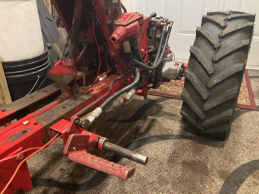

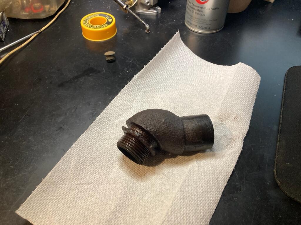

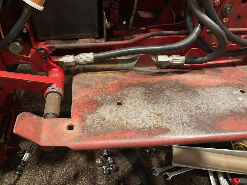

ineedanother 2,864 #37 Posted May 27 Not much time on a work day but trimmed the left foot rest to clear the front hydro lift hose. I had to do that on another and really don't see a good way around it. Salvaged an exhaust elbow from an M10 I had in the garage. Still looking at exhaust solutions and this gives me another. I've actually been spraying that for 6 months or so and an old 1 1/8" axle fit perfectly in the outlet so a little persuasion broke it loose 2 1 Share this post Link to post Share on other sites

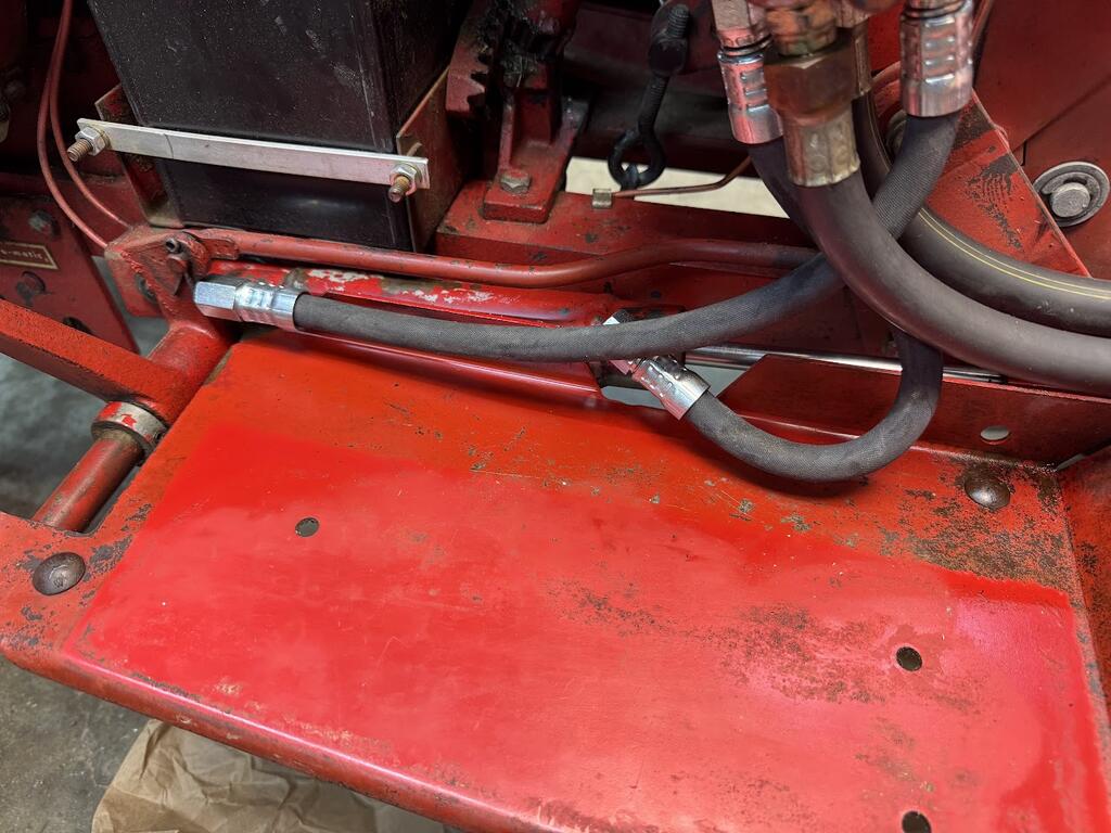

Bar Nuthin 3,222 #38 Posted May 27 (edited) 2 hours ago, ineedanother said: Not much time on a work day but trimmed the left foot rest to clear the front hydro lift hose. I had to do that on another and really don't see a good way around it. I just put new front hoses on my 16. I have the front hose in front of the rear hose Edited May 27 by Bar Nuthin Share this post Link to post Share on other sites
ineedanother 2,864 #39 Posted May 27 3 minutes ago, Bar Nuthin said: I just put new front hoses on my 16. I have the front hose in front of the rear hose Interesting, maybe. It looks like the bore for the fitting on your cylinder is more lateral than mine. 1 Share this post Link to post Share on other sites
Bar Nuthin 3,222 #40 Posted May 27 4 minutes ago, ineedanother said: Interesting, maybe. It looks like the bore for the fitting on your cylinder is more lateral than mine. Seems unlikely - Share this post Link to post Share on other sites

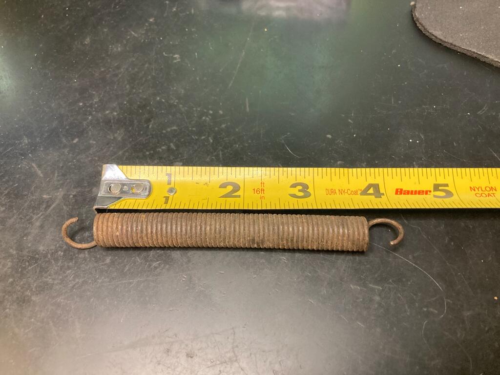

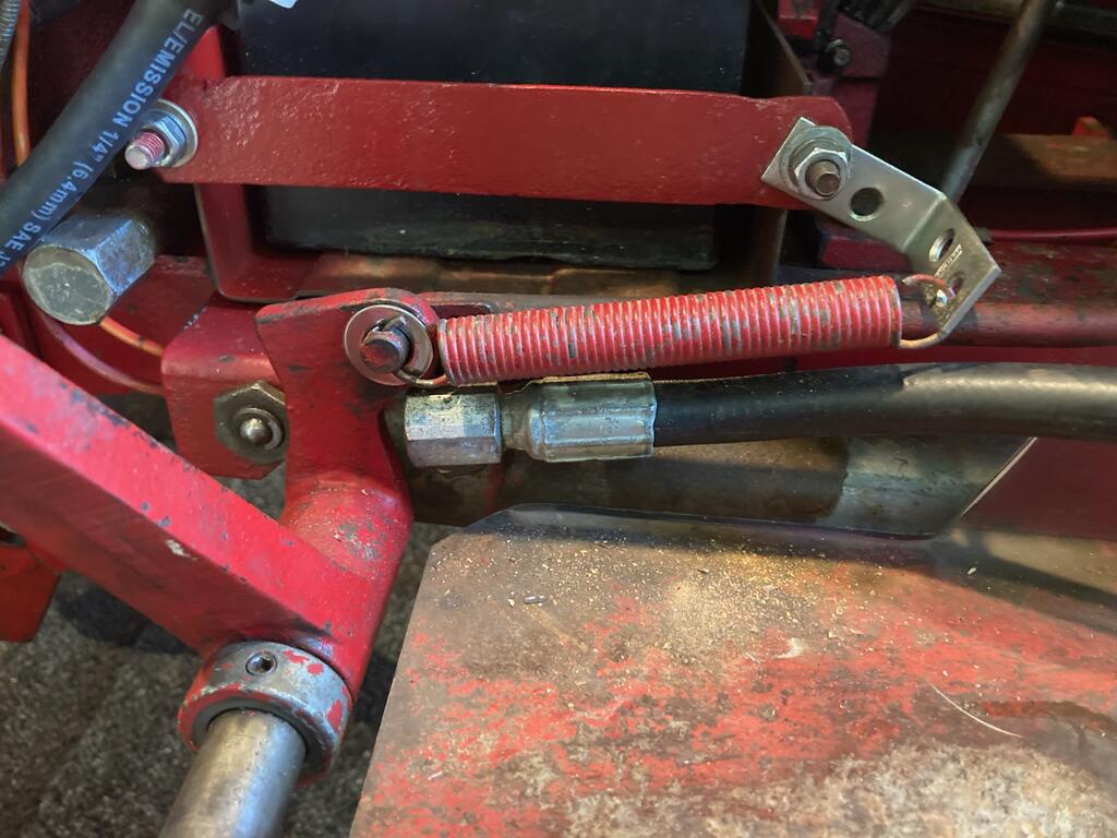

ineedanother 2,864 #41 Posted May 30 Anyone who's ever replaced the pesky brake pedal return spring on a sundstrand hydro unit knows that it's in the hood stand and can be an exercise in patience. I've seen some workarounds so that's what I chose to do this morning. I'll swap the angle bracket out for something more appropriate but this was effective for testing purposes. I can't recall what these springs are for but I have a few in the shop so they're likely a common part. 5 Share this post Link to post Share on other sites

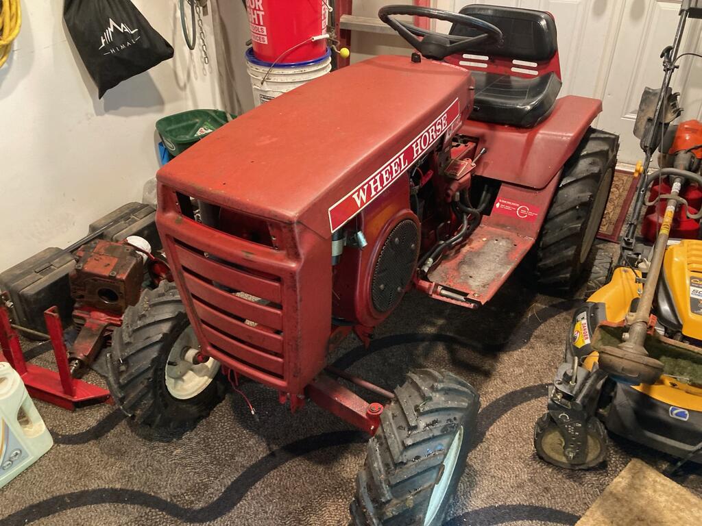

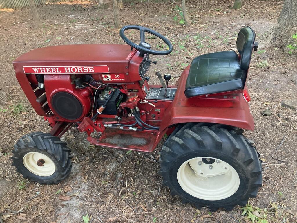

ineedanother 2,864 #42 Posted May 30 Well, it's been almost a month and it's back together. I wouldn't call it a restoration but I got the hydro/uni-drive replaced and the balance gears removed which were the primary objectives. I got seat springs and an old Nelson on it this afternoon and will do a few more things as I get time, but for now I'll call it good and move on to another project that's been waiting... 5 Share this post Link to post Share on other sites
adsm08 5,145 #43 Posted May 30 7 hours ago, ineedanother said: I can't recall what these springs are for but I have a few in the shop so they're likely a common part. Looks a lot like the PTO tension spring on my two units. Share this post Link to post Share on other sites
ineedanother 2,864 #44 Posted May 30 4 minutes ago, adsm08 said: Looks a lot like the PTO tension spring on my two units. I think it's bigger than that but it could be. It might be a brake spring from an 8-speed. Share this post Link to post Share on other sites
peter lena 10,065 #45 Posted May 30 @ineedanother done a lot of this , makes for a perfect era patina , there is no dust or dirt on my paint , just solid clean , now retained , only thing i use on it is s light penetrant , mineral oil clean cloth , that 6" electric palm buffer , cleaner wax , makes it easy , pete Share this post Link to post Share on other sites
adsm08 5,145 #46 Posted May 30 8 minutes ago, ineedanother said: I think it's bigger than that but it could be. It might be a brake spring from an 8-speed. Maybe. I don't have any 8 speeds, but those two springs on my tractors are similar in size. I think they are also the same dimensions as the springs on our trampoline. Share this post Link to post Share on other sites
