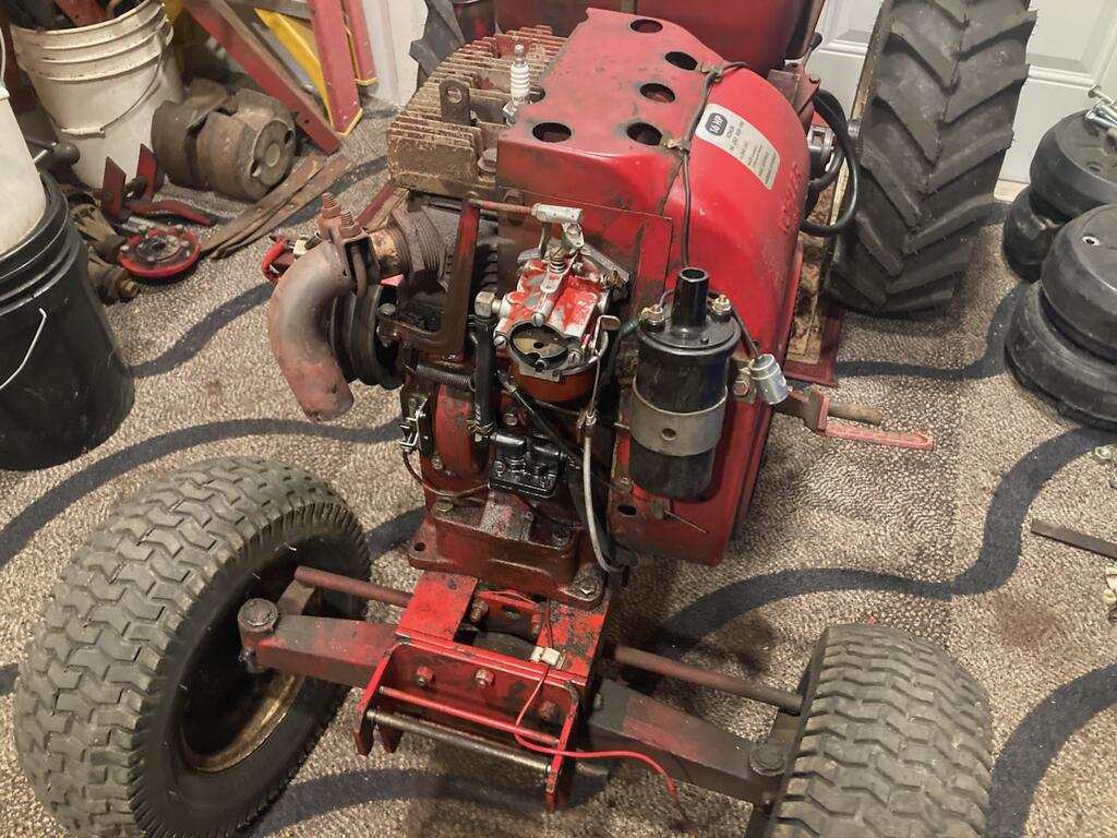

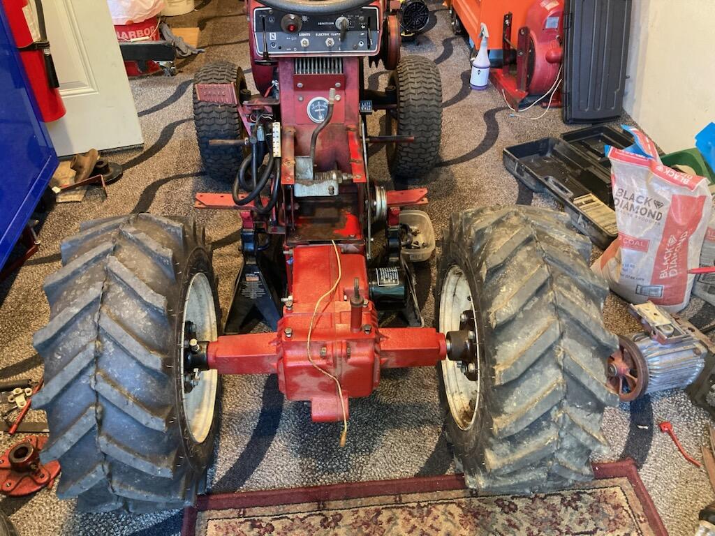

ineedanother 2,650 #1 Posted May 3 Not sure what the end game is for this but it's too good to let go. It's got some issues but is largely original. I'm going to start with a gearbox for axle issues and penetrol treatment to preserve the patina... 9 4 1 Share this post Link to post Share on other sites
ebinmaine 79,786 #2 Posted May 3 Good looking original there. Definitely worth the effort of saving. Some touch ups here & there and you'd have a great rig. 2 Share this post Link to post Share on other sites
kpinnc 18,771 #3 Posted May 3 15 hours ago, ineedanother said: too good to let go Agreed 100% 2 Share this post Link to post Share on other sites
ineedanother 2,650 #4 Posted May 3 Lots going on today other than tractors but I'll get some of it done... 2 Share this post Link to post Share on other sites

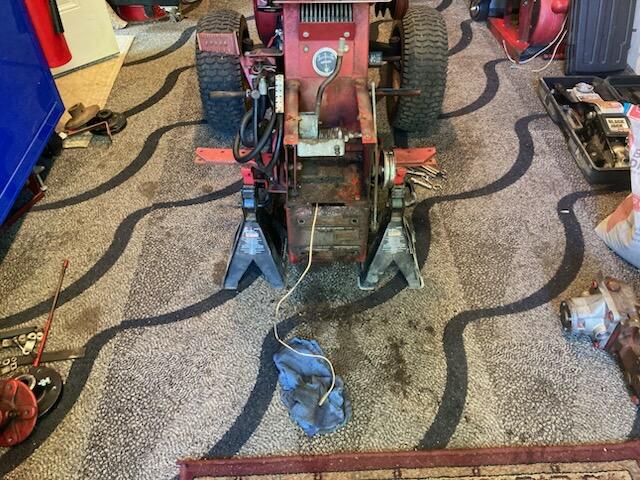

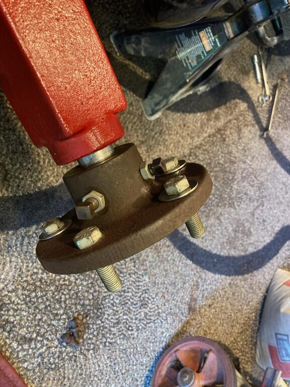

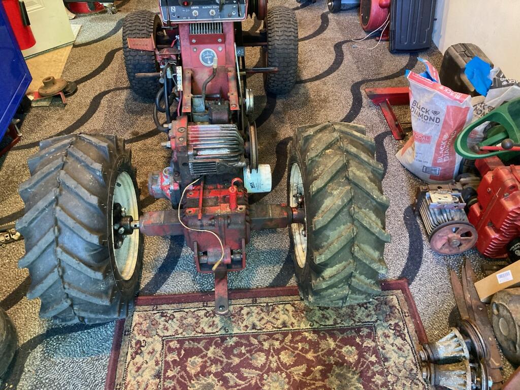

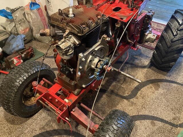

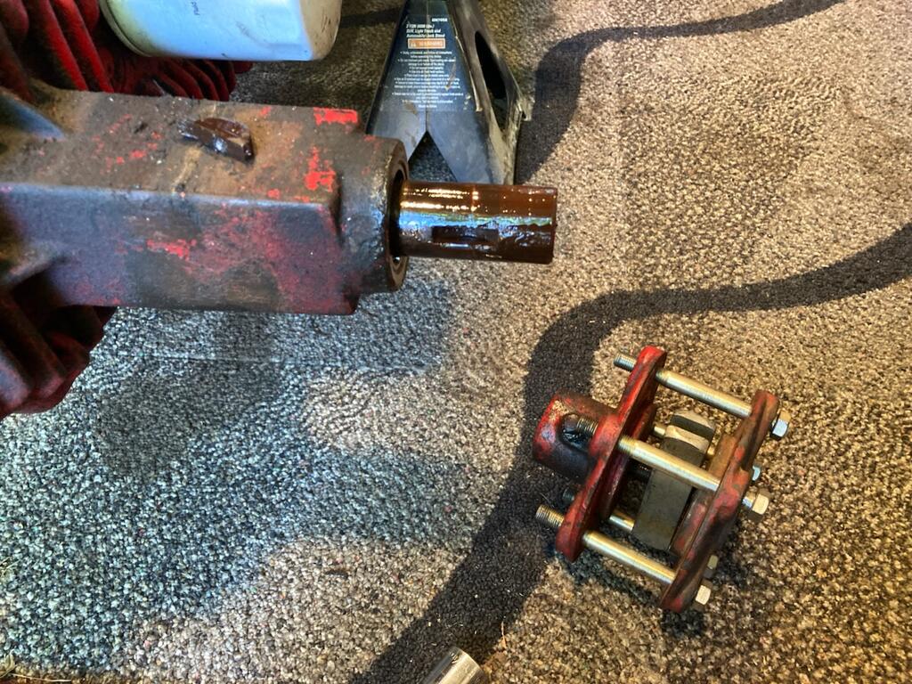

ineedanother 2,650 #5 Posted May 3 The drain plug is stripped so no draining the ATF but I did manage to get the good hub off and that axle looks fine. 2 Share this post Link to post Share on other sites

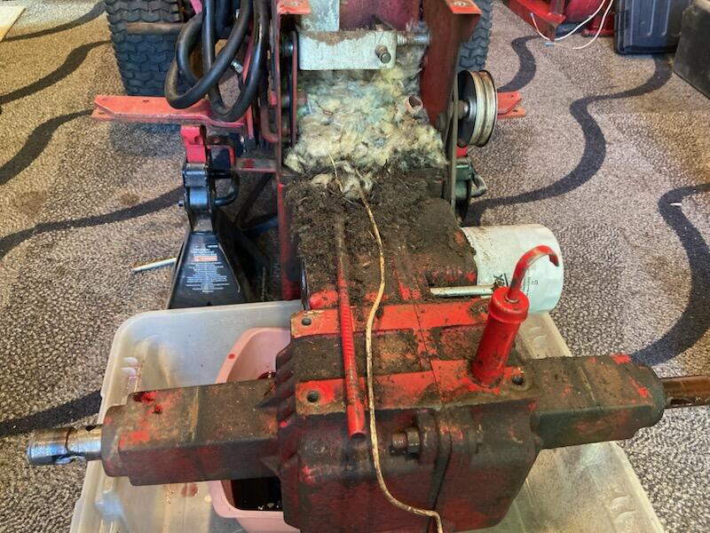

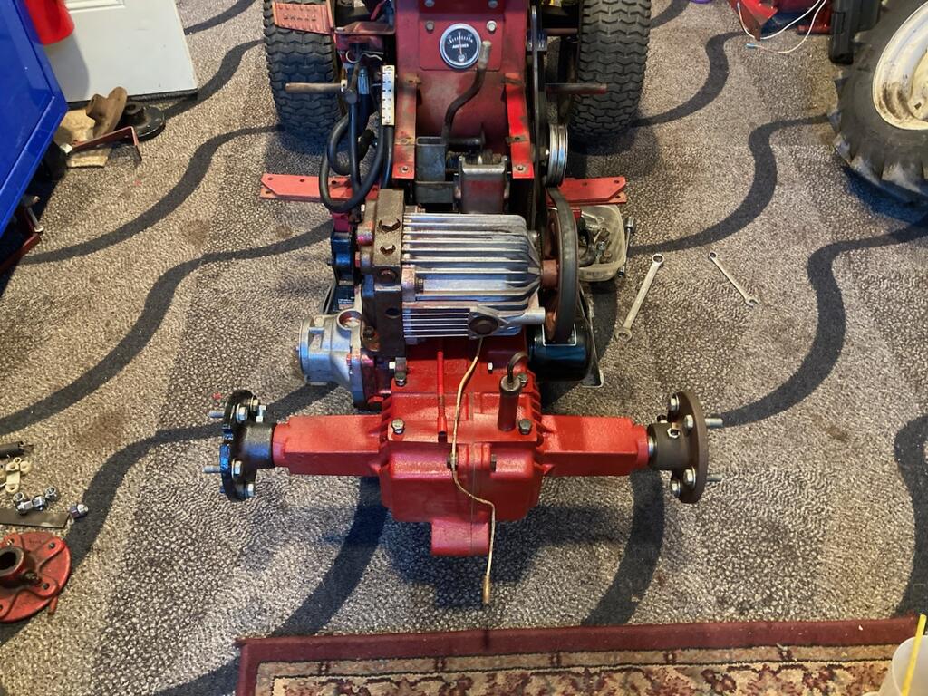

ineedanother 2,650 #6 Posted May 3 I forgot I could drain the case from the bottom of the motor, 3 quarts of clean ATF. Pulled the pump and motor to make it more manageable from a weight perspective. Found a nice comfy nest of insulation and nuts in with the controls. Got the gear box off and will get the frame cleaned up but everything looks good and solid. I would really like to have a roller again today but my old self is close to done getting up and down off this floor. 4 2 Share this post Link to post Share on other sites
ineedanother 2,650 #7 Posted May 3 Well, it's a roller. I really could have had it all back together today but too many other distractions and no ATF on the shelf either. Tomorrow's another day... 1 3 Share this post Link to post Share on other sites
ineedanother 2,650 #8 Posted May 4 I have power. Converting over to 10-30 so need to drain the lift cylinder and have a list of other things to address but this was a big line item 3 Share this post Link to post Share on other sites

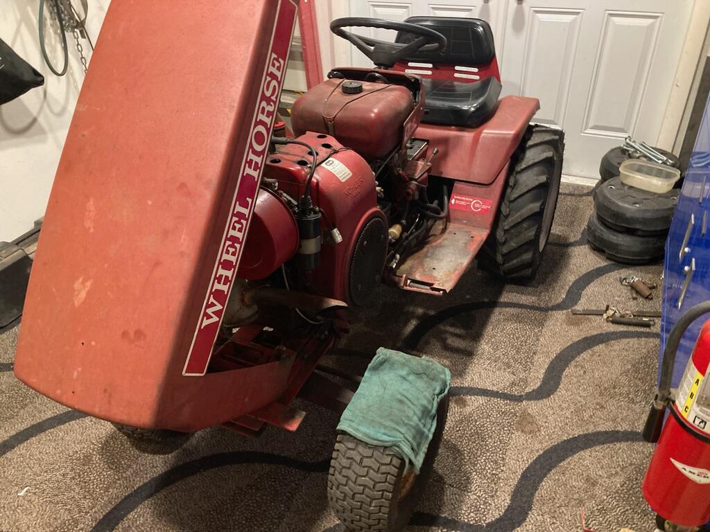

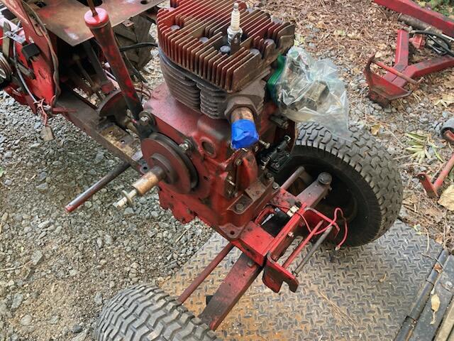

ineedanother 2,650 #9 Posted May 7 Needs a good bit of attention elsewhere, to be expected being a '73 with no records and not much known about its history. Someone has been pumping grease into it but the fuel pump leaks, most of the wiring is original, I can't tell yet if the head has ever been pulled and doubt that the valves are in adjustment by the way it runs...stuff to do I'd like to pull the balance gears but I've got other priorities and no tasks in mind for this one. We'll see how things shake out, it might be worth a couple hours to go ahead and do that while I'm this far in. 5 Share this post Link to post Share on other sites

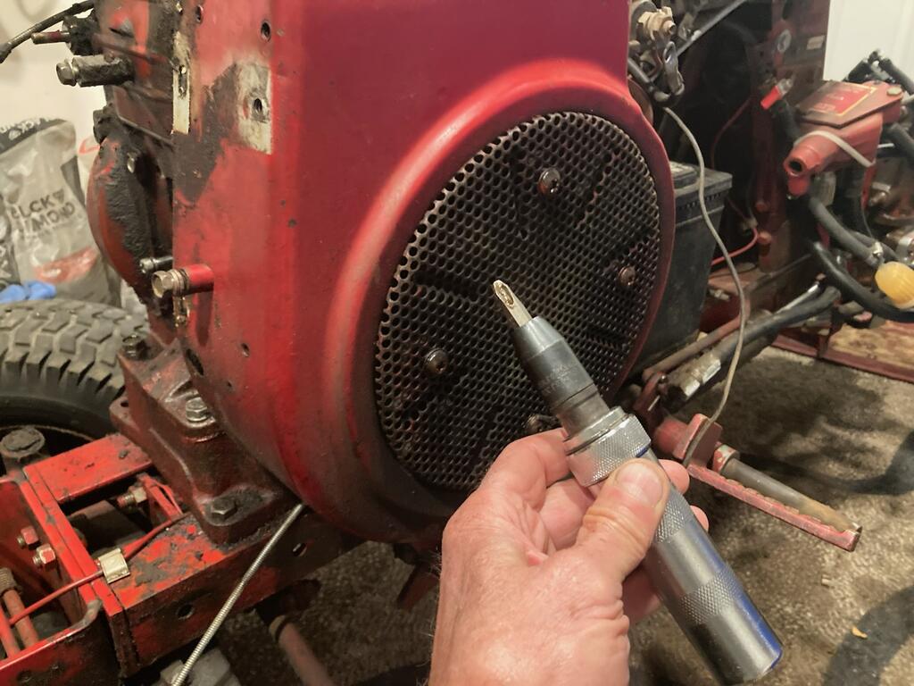

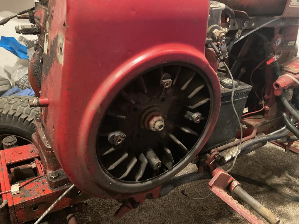

ineedanother 2,650 #14 Posted May 7 I've had issues in the past with the #3 phillips for the screen on the flywheel. I've soaked these for a few days and hit them with the manual impact. Four for 4 3 5 Share this post Link to post Share on other sites
ebinmaine 79,786 #15 Posted May 8 10 minutes ago, ineedanother said: I've had issues in the past with the #3 phillips for the screen on the flywheel. I've soaked these for a few days and hit them with the manual impact. Four for 4 Niiiiice. That manual impact driver was a recommended purchase by the folks here on Redsquare several years ago when we restored my 1974 C160-8 Cinnamon Horse. EXCELLENT purchase. Whack! To tighten. Then loosen. Repeat. Remove. 3 1 Share this post Link to post Share on other sites
ineedanother 2,650 #16 Posted May 8 3 minutes ago, ebinmaine said: Niiiiice. That manual impact driver was a recommended purchase by the folks here on Redsquare several years ago when we restored my 1974 C160-8 Cinnamon Horse. EXCELLENT purchase. Whack! To tighten. Then loosen. Repeat. Remove. And they're cheap...although the phillips tend to be stronger on the better ones. Great for 3/8" sockets but the phillips driver tips on these are priceless IMO. 4 Share this post Link to post Share on other sites

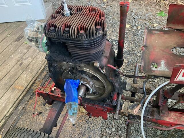

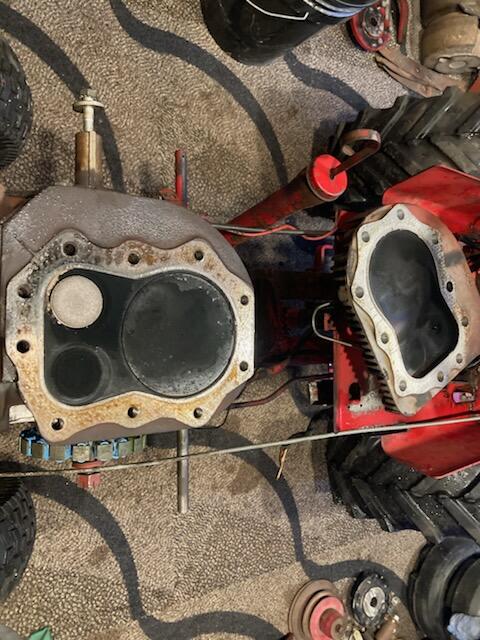

ineedanother 2,650 #19 Posted May 9 Finally got to the time to pull the head. This is a 13-fin k341 with original paint on most of the bolts but it runs like crap so I was curious as to what I would find. I haven't finished cleaning it up but the piston is unmarked and the cylinder measures 3 3/4". No signs of leaking head gasket and what really surprised me is that the cylinder looks great and there's visible cross hatch. 2 2 Share this post Link to post Share on other sites

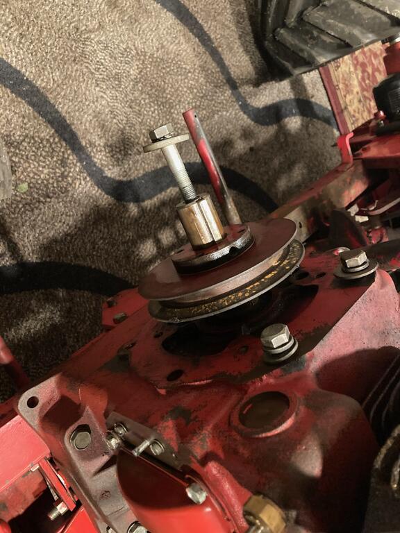

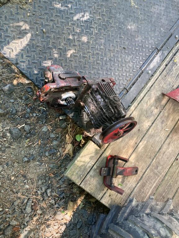

ineedanother 2,650 #20 Posted May 9 Another small win. The drive pulley came off with little fight. 5 Share this post Link to post Share on other sites

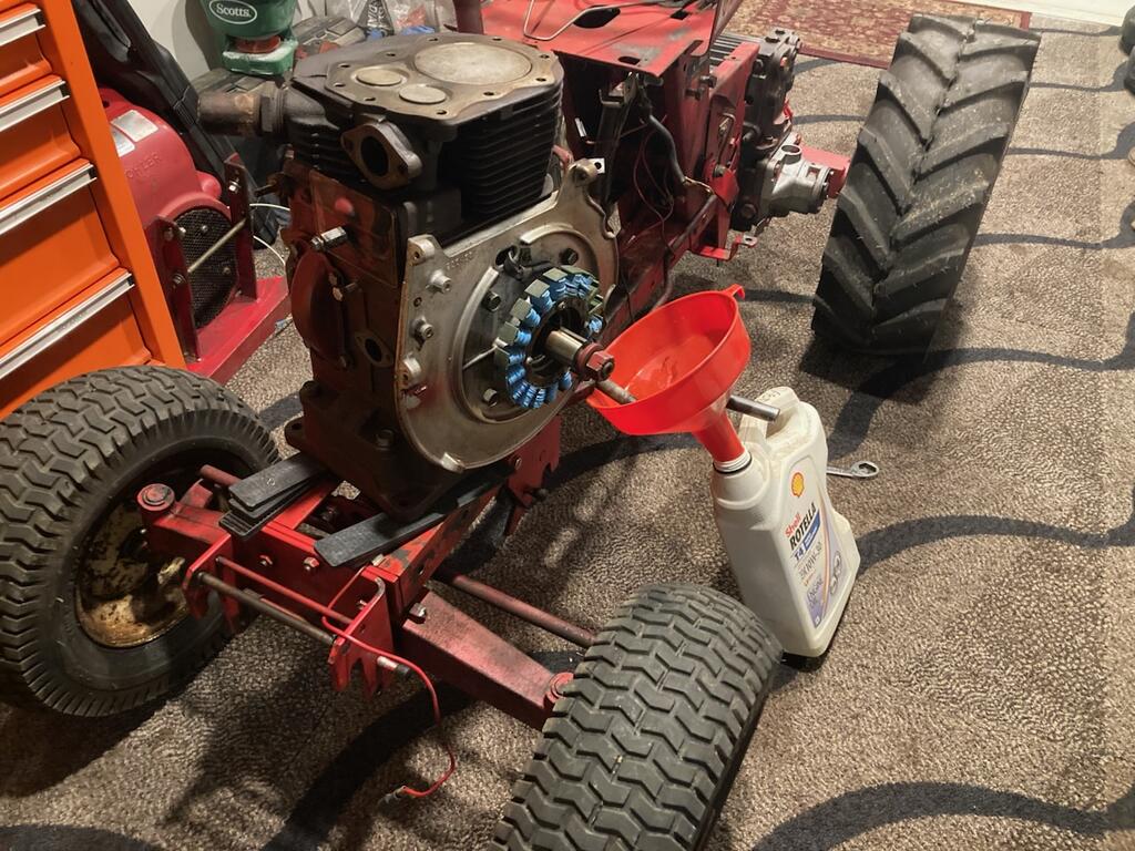

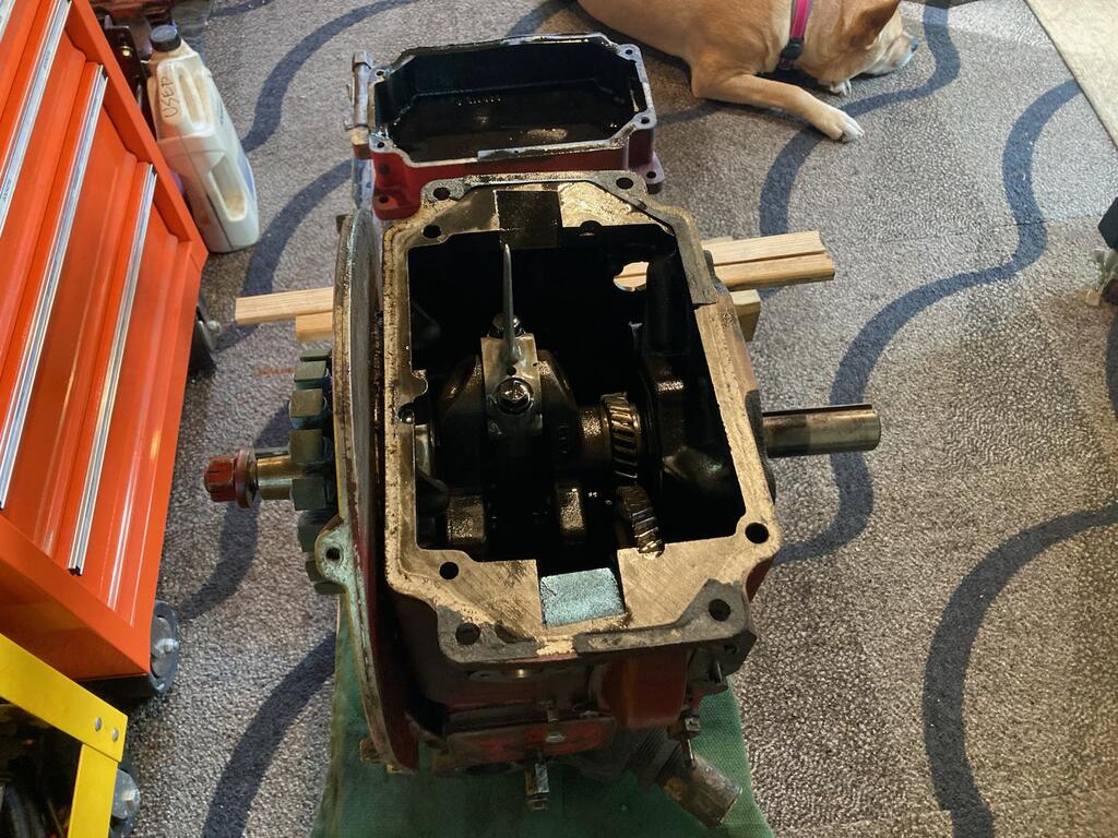

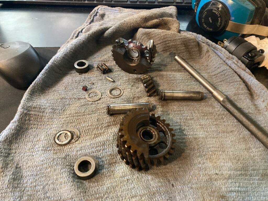

ineedanother 2,650 #21 Posted May 9 Stator disconnected, mounting bolts out and oil draining. I'm going to pull the filler tube and turn it over for balance gear removal...new one for me but I trust this is the time to git'er done. 2 4 Share this post Link to post Share on other sites
Retired Wrencher 6,832 #22 Posted May 9 On 5/6/2026 at 8:51 PM, ineedanother said: Needs a good bit of attention elsewhere, to be expected being a '73 with no records and not much known about its history. Someone has been pumping grease into it but the fuel pump leaks, most of the wiring is original, I can't tell yet if the head has ever been pulled and doubt that the valves are in adjustment by the way it runs...stuff to do I'd like to pull the balance gears but I've got other priorities and no tasks in mind for this one. We'll see how things shake out, it might be worth a couple hours to go ahead and do that while I'm this far in. Definitely a 1973 no name 14 i would say. Share this post Link to post Share on other sites

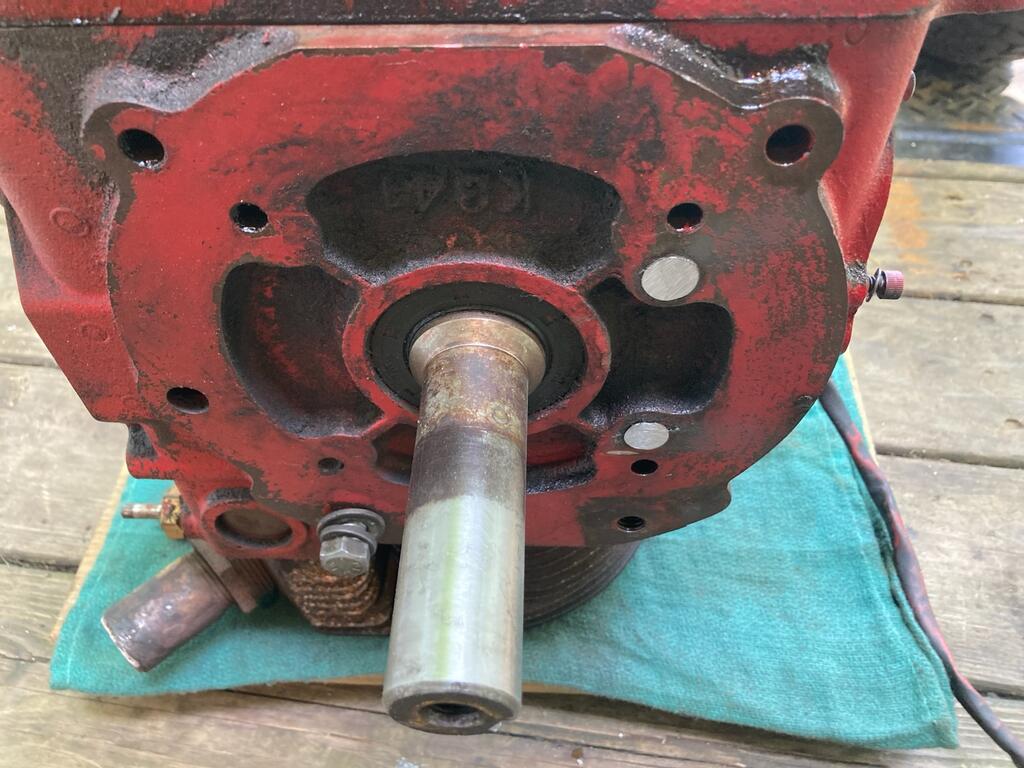

ineedanother 2,650 #23 Posted May 9 I split the first gear to see how that would go and it didn't split all the way through so I ended up driving the pins. I think that's the better way to do it. 4 2 Share this post Link to post Share on other sites
ineedanother 2,650 #24 Posted May 9 One thing I didn't care for was driving the pins back in. I used some 320 grit and assembly grease and still peened them a bit. Hit them with grinder and they're good to go, plenty of clearance for the pulley and not going anywhere! 1 1 Share this post Link to post Share on other sites
kpinnc 18,771 #25 Posted May 9 3 hours ago, ineedanother said: One thing I didn't care for was driving the pins back in. I used some 320 grit and assembly grease and still peened them a bit. Hit them with grinder and they're good to go, plenty of clearance for the pulley and not going anywhere! Had that trouble before myself. On the last one I did, I also just drove to top pin until the hole was plugged and ground the excess off flush as you did. Pounding on that cast iron just doesn't do any good for these engines. You did it right! 4 Share this post Link to post Share on other sites
