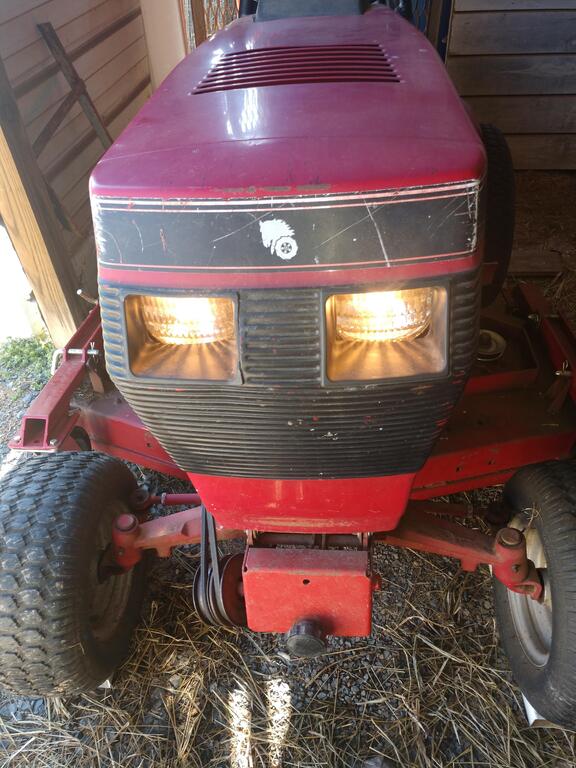

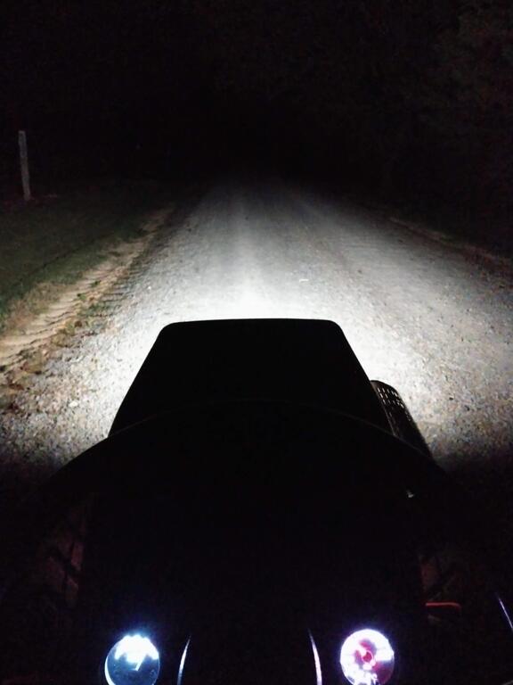

kpinnc 18,960 #5 Posted May 3 (edited) 10 hours ago, ri702bill said: IF you are going for improved brightness, LED's are the way to go. PAR 36 is a common bulb, and LEDs are easier to find than old incandescent. They are brighter, use less power, and last forever. LED is the way to go. First pic below is an old incandescent. The rest are LED for comparison. Edited May 3 by kpinnc 1 Share this post Link to post Share on other sites
