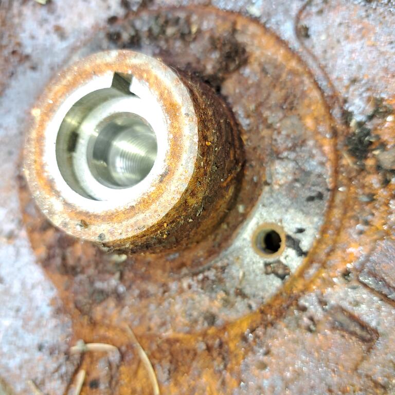

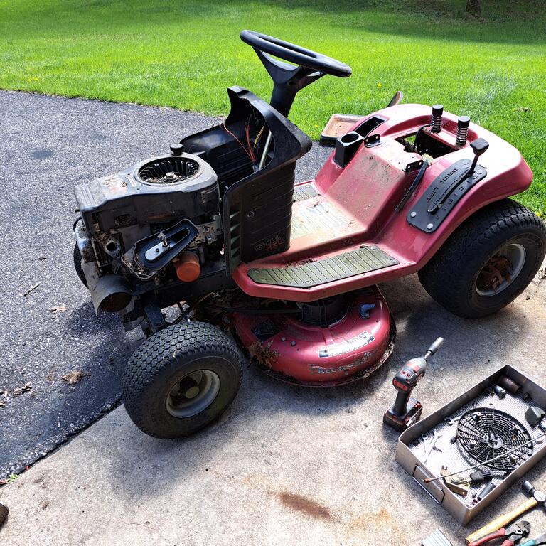

WHX?? 58,388 #1 Posted May 2 Definitely not running when parked as they usually are. I rescued this machine out of the scrap yard for potential parts tractor for the Missus 16-38. Any one see the problem? 1 1 Share this post Link to post Share on other sites
702854boy 1,245 #2 Posted May 2 (edited) The carb not being hooked up to the air filter or the fact that the blade spindle is 90 degrees sheared from the key or is that the flywheel key? Edited May 2 by 702854boy Share this post Link to post Share on other sites
ebinmaine 81,281 #3 Posted May 2 So what's a little timing issue...? It'll spark. Eventually. 1 1 Share this post Link to post Share on other sites
ri702bill 13,392 #4 Posted May 2 Yup - timing is way off. IMHO - salvage what you can & scrap it. Sorry, it's just a vertical shaft grass cutter (well, it used to be) Let it go. 1 Share this post Link to post Share on other sites
ineedanother 2,885 #5 Posted May 2 That blade won't turn fast enough. Time to throw it away! Share this post Link to post Share on other sites

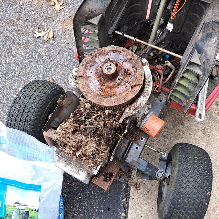

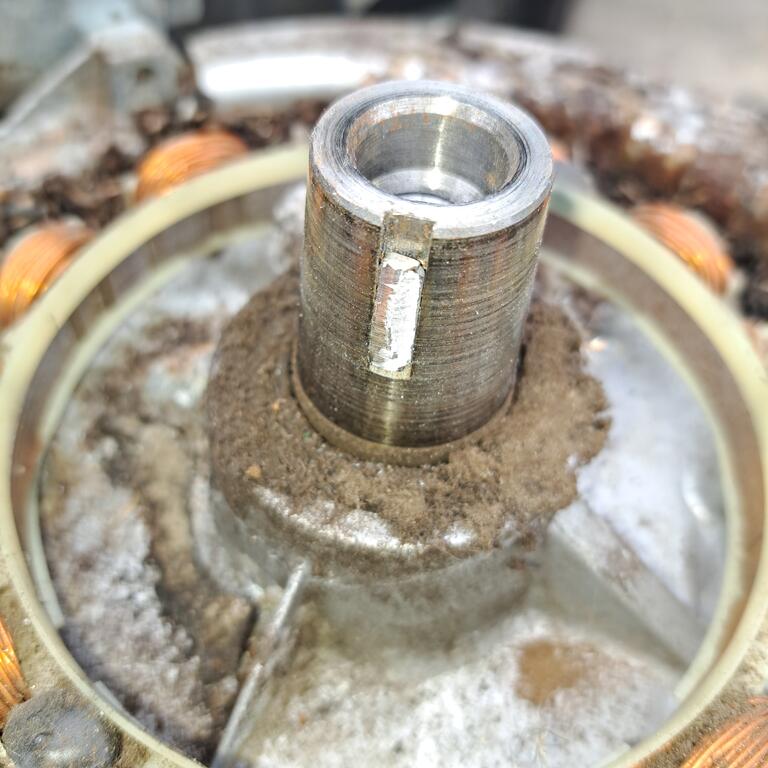

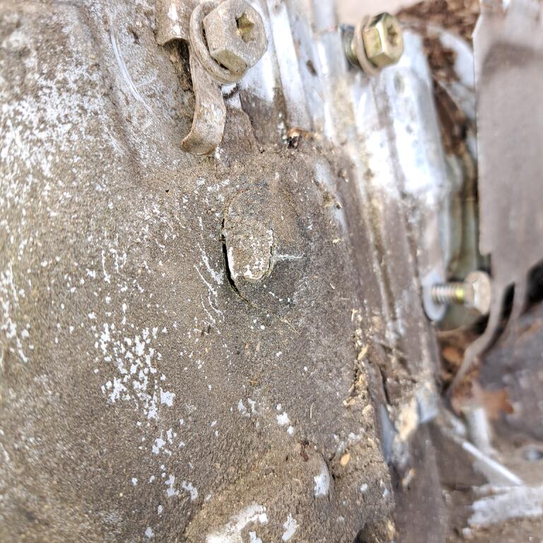

WHX?? 58,388 #8 Posted May 2 Nope not a blade ... Big Unit gets the prize. Although hitting a stump with a blade can cause it. It wasn't hitting a stump that did it ... It wasn't the mouse house ... it wasn't the Squonkies orange death although it was oil related. So after finding the not uncommon Briggs aluminum key way sheared I got as excited as a groom on wedding night. The motor does somewhat turn over with a pipe wrench on the stub. If that's all it is the mouse house will buff out and maybe I can save this motor right? Maybe go thru it for a a spare engine? Just for practice? Hiding behind the starter ... the reason for the abrupt engine stop. These motors are actually not too bad if oil is checked. 3 1 Share this post Link to post Share on other sites

ri702bill 13,392 #11 Posted May 2 (edited) Ah, the high milage accessory crankcase vent.... (As Marvin the Martian said... "And there was a big Kaboom!!") That engine is wasteacated. Maybe that Oh-so-efficient Fram spin on oil filter can be cleaned of the chunks and reused??? So it is my guesstimation that the crank came to a sudden stop at speed and the flywheel above said "I'm not done yet" and kept going?? Edited May 2 by ri702bill 2 Share this post Link to post Share on other sites
WHX?? 58,388 #12 Posted May 2 1 hour ago, ri702bill said: engine is wasteacated. I'm afraid so ... the hole would buff right out with some AL or JB weld. it's the damage inside that scrapped it. I'll still crack the cases just to see. Inquiring minds wanna know. These were very popular tractors in Toro's ending of . A fair motor too until Briggs went south. 5 hours ago, ri702bill said: Sorry, it's just a vertical shaft grass cutter That is true but my same 26 year old vertical is still in pristine shape and always has been a daily mower. Makes a guy wonder if he took good care of todays big box mowers it would still be operating in 26 years? Point of the whole story is check the dammed OIL!!! 4 Share this post Link to post Share on other sites
