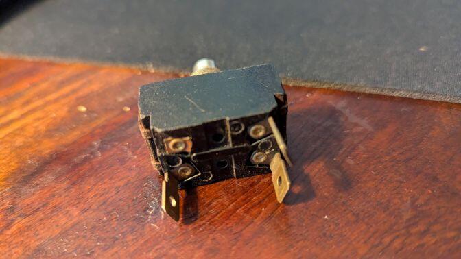

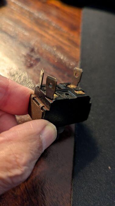

Phan 65 #7 Posted April 30 Hi gwest_ca: Sorry fo rthe miscommunication. I attached the PTO switch. Share this post Link to post Share on other sites
gwest_ca-(File Mod) 12,320 #8 Posted April 30 That switch is two switches in one. I am guessing on the wire colors here because we do not have a 1976 wiring diagram. I am using the late 1975 diagram. When the pto is off (button not pushed) the red wires are connected and go on the the clutch pedal switch and then to starter. When the pto is off (button not pushed) the black wires are connected and send power the the ignition coil. Click on the tractor to see the 1975 diagram. I believe it is the same as you have. A link to the switch where there is a picture of the switch wires. Share this post Link to post Share on other sites
