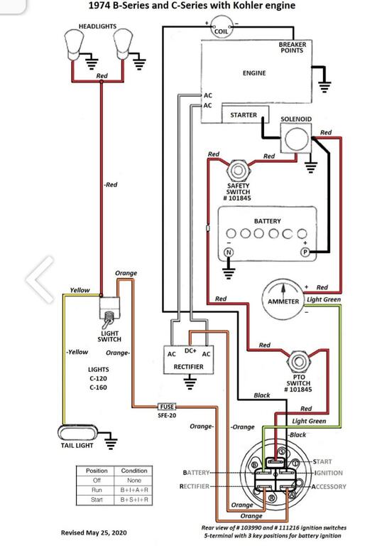

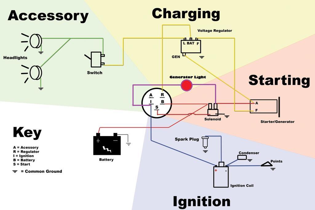

WHX?? 58,125 #5 Posted April 29 25 minutes ago, Sparky said: The wiring will have to be somewhat custom. Yes it will. A B-80 would originally had a start solenoid. A SG motor likely not. Ignition switch will definitely be different. Here's one with a solenoid to get you started. 1 Share this post Link to post Share on other sites

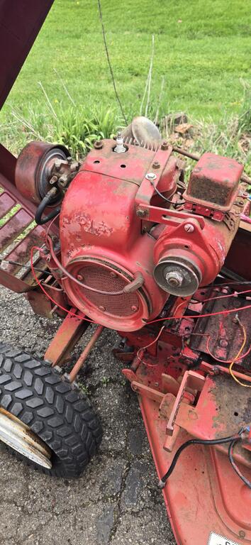

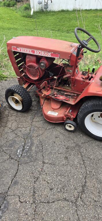

tractor. 3 #6 Posted April 29 3 hours ago, ebinmaine said: Yep. @tractor. How about some pics? 1 Share this post Link to post Share on other sites

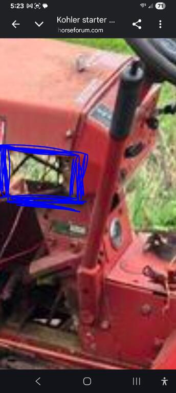

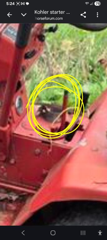

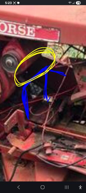

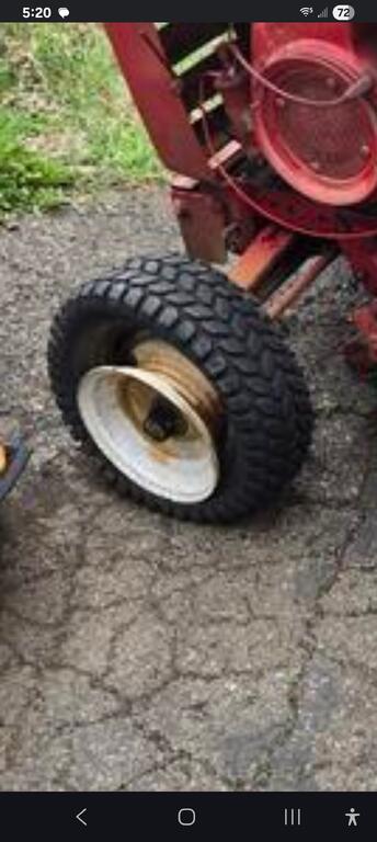

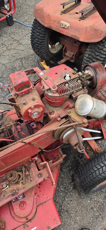

ebinmaine 80,695 #7 Posted April 29 Very interesting project. I've been a fan of the Starter/Generator systems for several years because of the unique noise at startup and good overall dependability. Looks like you may have a 1974/75 ish B80 with the 4 speed. Someone has transplanted a mid 1960s S/G 8 HP engine in there. There's an S/G belt cover missing from the side of the engine. A few points of interest. This tire MAY be low on air. The blue rectangle is where the battery would set. The yellow oval can be a point of contact between the Starter and the battery. Watch for that. There's a shelf that goes here in blue. parts are easy enough to find. I may have one if ya need it. That's where the "B80" decal would have been. The tag just below that would have the serial numbers to identify the tractor. This circular piece in yellow appears to be the old coil holder. Not sure where it belongs on your "modified application". Share this post Link to post Share on other sites
953 nut 69,303 #8 Posted April 29 5 hours ago, WHX?? said: Ignition switch will definitely be different. Here's one with a solenoid to get you started. The ignition switch in the diagram Jim posted is a 103990 which is readily available at auto parts stores or big box stores like HD, Lowes, or Tractor Supply. Share this post Link to post Share on other sites

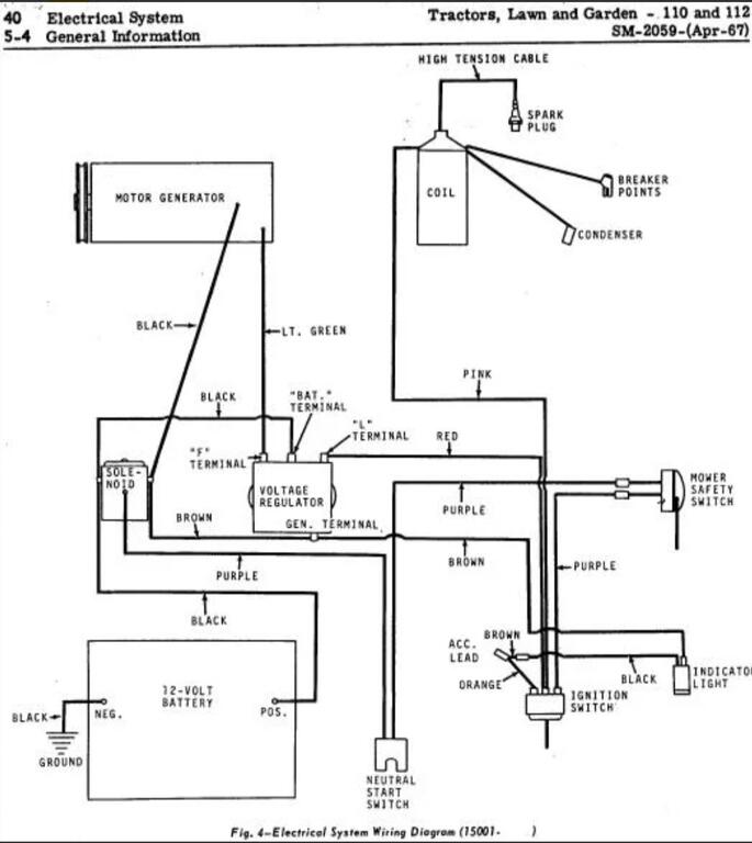

tractor. 3 #9 Posted April 29 45 minutes ago, ebinmaine said: Very interesting project. I've been a fan of the Starter/Generator systems for several years because of the unique noise at startup and good overall dependability. Looks like you may have a 1974/75 ish B80 with the 4 speed. Someone has transplanted a mid 1960s S/G 8 HP engine in there. There's an S/G belt cover missing from the side of the engine. A few points of interest. This tire MAY be low on air. The blue rectangle is where the battery would set. The yellow oval can be a point of contact between the Starter and the battery. Watch for that. There's a shelf that goes here in blue. parts are easy enough to find. I may have one if ya need it. That's where the "B80" decal would have been. The tag just below that would have the serial numbers to identify the tractor. This circular piece in yellow appears to be the old coil holder. Not sure where it belongs on your "modified application". Thank you for the pointers. I just bought this a few weeks ago. I bought this with another one that has the original engine in it as a parts tractor. The guy I bought it from was also trying to turn the two into one but had no time so he sold them to me. I do know about the tires I do have some just need to put them on the rims. The parts tractor has the shift knob, and the coil holder was a little to small so I used a different one. The gas tank holder/shelf I took off to get to the pto safety button easier. Thank you for the tip on the battery though. I did find a john deere 110 wiring diagram because they have the same kohler engine, and I will try to merge the 110 and the b80 diagrams to hopefully figure out how to wire it up. Share this post Link to post Share on other sites
ebinmaine 80,695 #10 Posted April 29 3 minutes ago, tractor. said: john deere 110 wiring diagram I've never rewired a JD but I'd suggest avoiding that unless you know for sure the switches ALL work the same. Not saying they do or don't... just that they may be different types and that can present issues. Share this post Link to post Share on other sites
tractor. 3 #11 Posted April 29 8 minutes ago, ebinmaine said: I've never rewired a JD but I'd suggest avoiding that unless you know for sure the switches ALL work the same. Not saying they do or don't... just that they may be different types and that can present issues. They are a little different but I think i will be able to figure out how to wire it all up. 1 Share this post Link to post Share on other sites
ebinmaine 80,695 #12 Posted April 29 10 minutes ago, tractor. said: They are a little different but I think i will be able to figure out how to wire it all up. The diagrams are different? Or the switches are? It's the switches I'm concerned with .... If a "normally open" switch is placed in a circuit that requires "normally closed" that's a potentially serious problem. Share this post Link to post Share on other sites
tractor. 3 #13 Posted April 29 20 minutes ago, ebinmaine said: The diagrams are different? Or the switches are? The diagrams are a bit different but the switches should be the same. 1 Share this post Link to post Share on other sites
953 nut 69,303 #14 Posted April 29 51 minutes ago, tractor. said: I did find a john deere 110 wiring diagram because they have the same kohler engine, and I will try to merge the 110 and the b80 diagrams to hopefully figure out how to wire it up. You may be headed down a rabbit hole with little hope of success. I would suggest you go with the simple diagram Jim @WHX?? posted unless you happen to have the John Deere harness and are reasonably knowledgeable on wiring. If you can post the JD wiring diagram we can help you as much as possible if that is the road you decide to go down. Share this post Link to post Share on other sites
tractor. 3 #15 Posted April 30 14 minutes ago, 953 nut said: If you can post the JD wiring diagram we can help you as much as possible The black and white one is the JD and the colored is the b80 diagram Share this post Link to post Share on other sites

953 nut 69,303 #17 Posted April 30 12 hours ago, tractor. said: The black and white one is the JD and the colored is the b80 diagram OK, the JD wiring diagram is for an engine with a Starter / Generator and mechanical voltage regulator while the Wheel Horse diagram is for an engine with a gear drive starter and a stator behind the flywheel using a solid state voltage regulator. Very little of the wiring is interchangeable. Since your 1974 B has had a heart transplant utilizing the S / G type engine I would strongly suggest you use the diagram Jim @WHX?? gave you in post # 5, It is clearly labeled and uses the 103990 ignition switch. We have no idea what switch JD used and there is no diagram of the switch to show the connections. If you have the clutch and PTO safety switches in place they can be connected in series as indicated below. 2 Share this post Link to post Share on other sites
