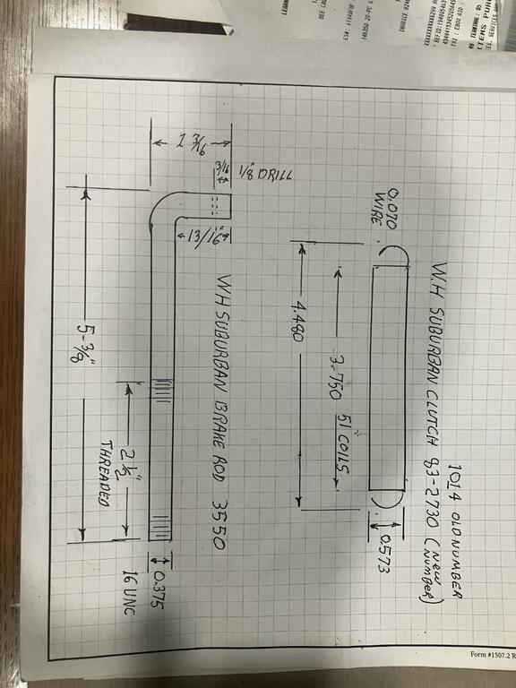

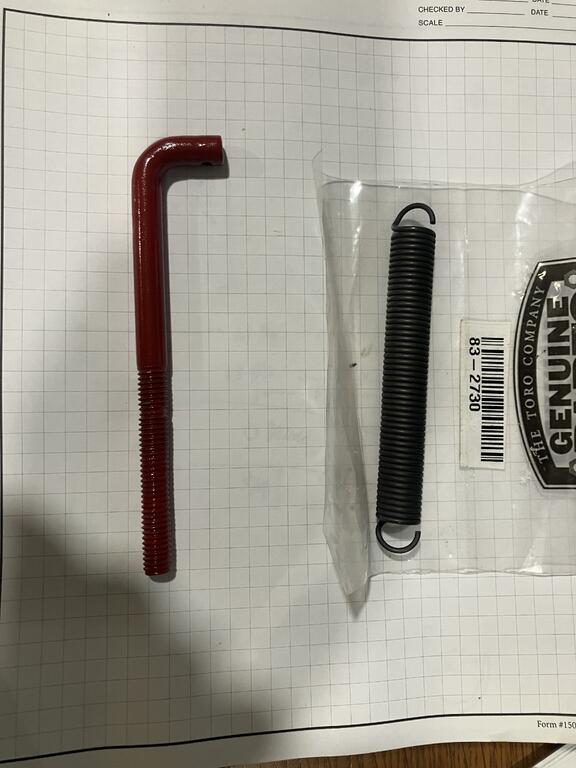

Jon Cooper 0 #1 Posted April 28 I am looking for dimensions for the Suburban 401 Brake Rod. I haven't been able to find anything except a part number, and I cant find dimensions with that. I will.have to make one. Thanks! Share this post Link to post Share on other sites
Jon Cooper 0 #2 Posted April 28 Some clarification, the rod for the brake band. Also looking for the clutch spring dimensions as I need to get that as well Share this post Link to post Share on other sites

Jon Cooper 0 #9 Posted May 10 7 hours ago, oliver2-44 said: @Jon Cooper Thank you so much!!!! Share this post Link to post Share on other sites
