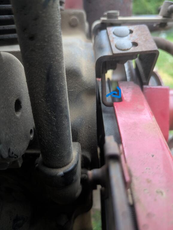

Yitzchok 5 #1 Posted April 27 Hi, I have a Wheel horse 312-8 and if i press the clutch too fast or i am on bumpy ground sometimes the belt flips into the space next to it and then the clutch does nothing when i push it and the tractor starts lurching, am i missing a guard there? Share this post Link to post Share on other sites
ebinmaine 80,078 #2 Posted April 27 What's the age and part number of your belt? It looks thin. 1 Share this post Link to post Share on other sites

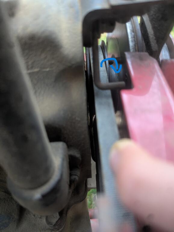

953 nut 68,140 #3 Posted April 28 There is a belt guide attached to the right foot rest, is it in place? Share this post Link to post Share on other sites
gwest_ca-(File Mod) 12,416 #4 Posted April 28 Adjust these guides so they just clear the belt when the belt is tight. They will force a good condition belt to behave. Share this post Link to post Share on other sites

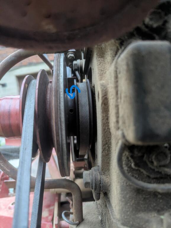

Bill D 3,062 #5 Posted April 28 (edited) That looks like a 1/2" wide belt. Should be an 82" x 5/8". Also, the belt on the PTO should be on the larger pulley closer to the engine. Edited April 28 by Bill D 2 3 Share this post Link to post Share on other sites
ri702bill 12,694 #6 Posted April 28 7 hours ago, Bill D said: That looks like a 1/2" wide belt. Should be an 82" x 5/8". Also, the belt on the PTO should be on the larger pulley closer to the engine. On both counts. And any belt that far down in the V groove acts like it is too long, causing shifting issues. The top of a new belt should ride just above the OD of the pulley..... 2 Share this post Link to post Share on other sites

Yitzchok 5 #8 Posted April 28 On 4/27/2026 at 7:36 PM, ebinmaine said: What's the age and part number of your belt? It looks thin. I don't know, a few years ago (before i started using it) i think the old one snapped and my older brother switched it. Share this post Link to post Share on other sites
Yitzchok 5 #9 Posted April 29 23 hours ago, gwest_ca said: Adjust these guides so they just clear the belt when the belt is tight. They will force a good condition belt to behave. Thanks i adjusted them and it seems to work fine Share this post Link to post Share on other sites
Yitzchok 5 #10 Posted April 29 (edited) 22 hours ago, Bill D said: That looks like a 1/2" wide belt. Should be an 82" x 5/8". Also, the belt on the PTO should be on the larger pulley closer to the engine. Thanks i switched it, what is the other one for? Edited April 29 by Yitzchok Share this post Link to post Share on other sites
ineedanother 2,769 #11 Posted April 29 1 hour ago, Yitzchok said: Thanks i switched it, what is the other one for? Not sure how many attachments might use that one but the hydro pump for the ARK FEL does. Share this post Link to post Share on other sites
ebinmaine 80,078 #12 Posted April 29 7 hours ago, Yitzchok said: Thanks i switched it, what is the other one for? 6 hours ago, ineedanother said: Not sure how many attachments might use that one but the hydro pump for the ARK FEL does. My Mackissic chipper shredder is driven by the smaller outside groove too. Share this post Link to post Share on other sites
pfrederi 20,992 #13 Posted April 29 Snow blowers use outer pulley 1 Share this post Link to post Share on other sites
