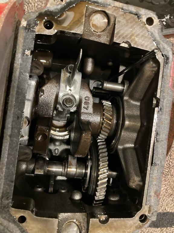

ineedanother 2,885 #27 Posted April 29 I have (4) K341 that are all in use and plan to do this as time permits. I had an old k241 sitting here that needs rings and figured I'd just open it up and knock those out since I've never done it before. Well, they were already gone! I guess I'll do that lesson later. 2 Share this post Link to post Share on other sites
pfrederi 21,342 #28 Posted April 29 What was the spec number of your K241? Share this post Link to post Share on other sites
ineedanother 2,885 #29 Posted April 29 9 minutes ago, pfrederi said: What was the spec number of your K241? 46636d Share this post Link to post Share on other sites
ineedanother 2,885 #30 Posted April 29 7 minutes ago, ineedanother said: 46636d K301 block as I think many were. Share this post Link to post Share on other sites
ineedanother 2,885 #31 Posted April 29 2 minutes ago, ineedanother said: K301 block as I think many were. 13 fins and I suspect a thicker cylinder wall than others, similar to some of the k341 but I'm not sure about any of that, truth be told... Share this post Link to post Share on other sites
Retired Wrencher 7,043 #32 Posted April 29 8 hours ago, pfrederi said: What was the spec number of your K241? I believe this is it. I can double check today. IMG_1089.mov Share this post Link to post Share on other sites
pfrederi 21,342 #33 Posted April 29 There are no balance gears in that engine. 46333 Share this post Link to post Share on other sites
pfrederi 21,342 #34 Posted April 29 10 hours ago, ineedanother said: 46636d No balance gears in that spec number either. There are many variations of crankshaft for K241 engine only 5 of them had balance gears. Very uncommon to have them. 1 Share this post Link to post Share on other sites
ineedanother 2,885 #35 Posted April 29 9 hours ago, pfrederi said: No balance gears in that spec number either. There are many variations of crankshaft for K241 engine only 5 of them had balance gears. Very uncommon to have them. Good to know. The interesting thing to me is that the shafts for the gears are there, just no gears. 1 Share this post Link to post Share on other sites
ebinmaine 81,281 #36 Posted April 29 30 minutes ago, ineedanother said: Good to know. The interesting thing to me is that the shafts for the gears are there, just no gears. Interesting Share this post Link to post Share on other sites
Retired Wrencher 7,043 #37 Posted April 30 Well guys I stuck it under the porch yesterday. It will be there until I find another engine or rebuild this one. The video I posted yesterday in GEAR if you listen closely you can hear the nose in the bottom end. This was just starting to be come a problem. Thanks for all the help so far! Share this post Link to post Share on other sites
pfrederi 21,342 #38 Posted April 30 (edited) 14 hours ago, ineedanother said: Good to know. The interesting thing to me is that the shafts for the gears are there, just no gears. As part of production the engine blocks were all probably drilled with the two holes for Balance gear shafts. Got to fill them in somehow.... Edited April 30 by pfrederi 2 Share this post Link to post Share on other sites
