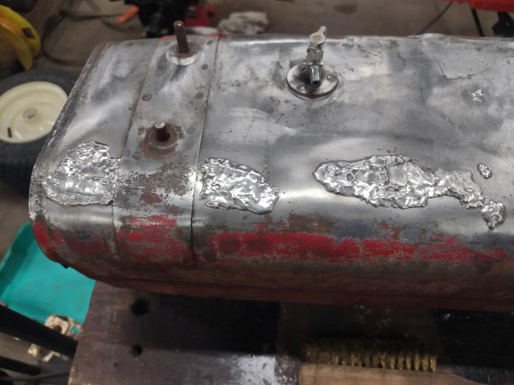

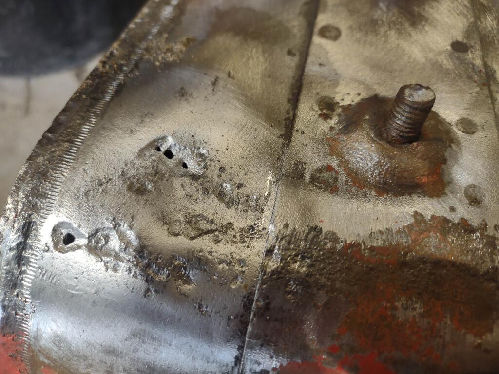

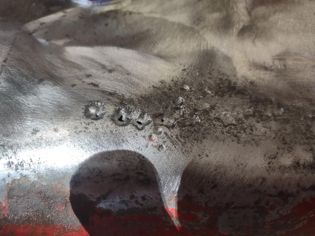

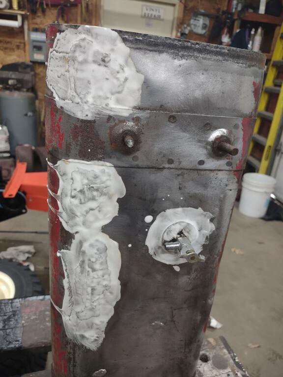

Achto 32,915 #1 Posted April 26 (edited) At the end of summer last year my D-160 started weeping fuel like a SR-22 Black Bird sitting on the tarmac waiting for take off. Today I decided to pull the tank & see what was going on. After a good wire brushing things did not look good. Figured that I would try silver soldering the holes & low spots up. Took some time, don't look real pretty but at this point I believed that I had it sealed up. Here is a trick to check your work if you do some thing like this. Make a paste out of water & baking soda. Brush it over your work and allow it to dry. Once it is dry put some gas in the tank and allow it to sit. If you have a leak the past will show exactly where it is. It will turn yellowish where ever the gas seeps through.. My paste stayed nice & white except for 2 little spots that were stained by left over flux. These spots did not grow when I put gas in the tank so it should be ready to install again. Just wanted to share this leak detecting trick with you all. Edited April 26 by Achto 6 8 3 Share this post Link to post Share on other sites

Achto 32,915 #5 Posted April 27 29 minutes ago, 8ntruck said: What tools and supplies did you use for silver soldering? After using a wire brush on a drill to get the metal super clean. I warmed the tank up & gave it a good coat of paste flux. Used a mini torch to heat the metal and used a silver bearing solder for metal work. https://www.lowes.com/pd/Harris-Products-Group-3-oz-Lead-Free-General-Metal-Solder/1000858196 3 Share this post Link to post Share on other sites
