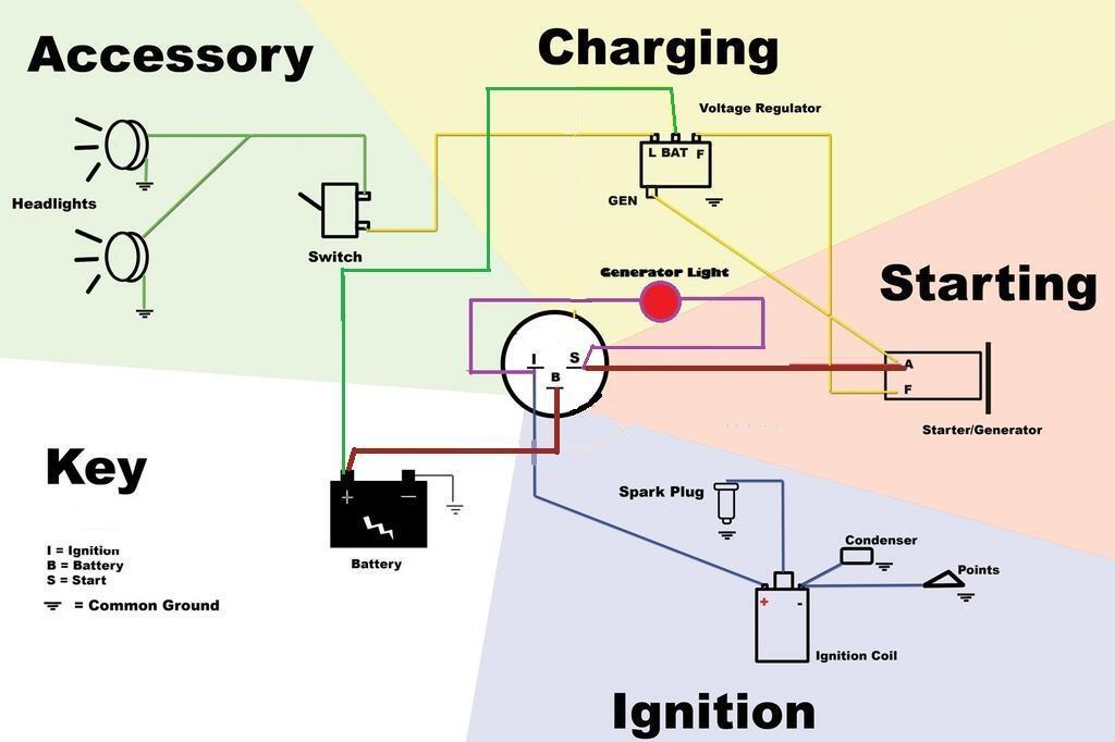

terc 27 #1 Posted April 24 Hello All I'm looking for information on how to bench test a starter/ generator. This tractor does have a voltage regulator which is not in the best of shape. The current tractor setup is well passed trying to test on the tractor. So I am just wanting to see if this unit is any good before maybe sending it out for refirb. Also is it possible to get a wiring diagram for a starter/generator. 1 Share this post Link to post Share on other sites

WHX?? 57,628 #3 Posted April 24 There isn't really a good way to bench test them unless you have the proper test apparatus. About the only thing you can do is apply +12 volts to the A terminal and ground the case. If it spins chances are good that it will charge. Most often a good cleaning is all that is required. Possibly brushes and and bearings. If in doubt about the regulator just replace it. Need the model of the tractor for the correct wiring diagram but here is a basic one. Attached are some of the manuals I have. Starter_Generator_Repair.pdf Training_Chart_Generators_4.pdf 5 Share this post Link to post Share on other sites

terc 27 #5 Posted April 25 thanks that gives some info to work with. As to the model of the tractor all the serial number plates are long gone, so i m guessing its 700 uni drive model late 60's or early 70's 1 Share this post Link to post Share on other sites
WHX?? 57,628 #6 Posted April 25 (edited) 1 hour ago, terc said: the serial number plates are long gone SGs were last used early '68 on tractors with a Kohler. This a Briggs motor by chance? They were used with SGs into the early '70s. If so that wiring diagram is not correct as its for a early to mid sixties model. Edited April 25 by WHX?? 1 Share this post Link to post Share on other sites
