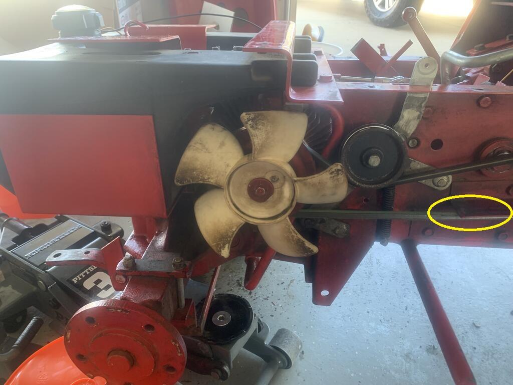

Stbona1995 0 #1 Posted April 24 1983 Wheel horse C 175 automatic Went to replace the Drive belt and can not get the new one on ..... cant find the routing diagram and when i actually get it on it jumps the clutch pully I have a 5/8 by 84 belt what everything says is the correct size Help Please Thank you in advance Share this post Link to post Share on other sites

953 nut 69,556 #4 Posted April 24 This picture is of a 400 model with an Eaton 1100 but the belt routing would be the same. The belt should be above the guide circled in yellow. 1 1 Share this post Link to post Share on other sites
