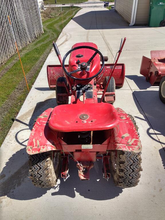

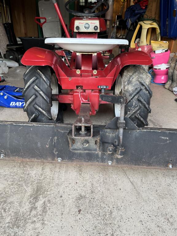

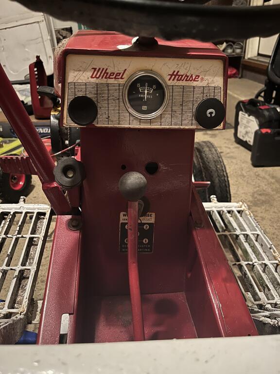

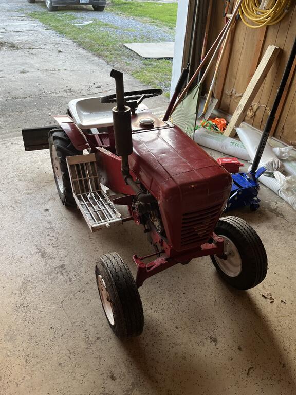

NewToWH 8 #1 Posted April 23 Please help a new to wheel horse tractor guy out. Trying to figure out some info about this little guy. Please excuse the mess. I’ve done the browse, manuals and then look through for models but still unsure. Any and all help is greatly appreciated! 2 1 Share this post Link to post Share on other sites
gwest_ca-(File Mod) 12,557 #2 Posted April 23 Welcome to Red Square My guess it is a fairly early 1961 model 701 with a replacement engine by the serial number. 2 Share this post Link to post Share on other sites
Racinbob 13,290 #3 Posted April 23 (edited) Based on the newer front axle I'd say likely a 654. I'd have to verify which models had that dash/fuel tank style. The engine won't help identify this one. Edited April 23 by Racinbob 1 Share this post Link to post Share on other sites

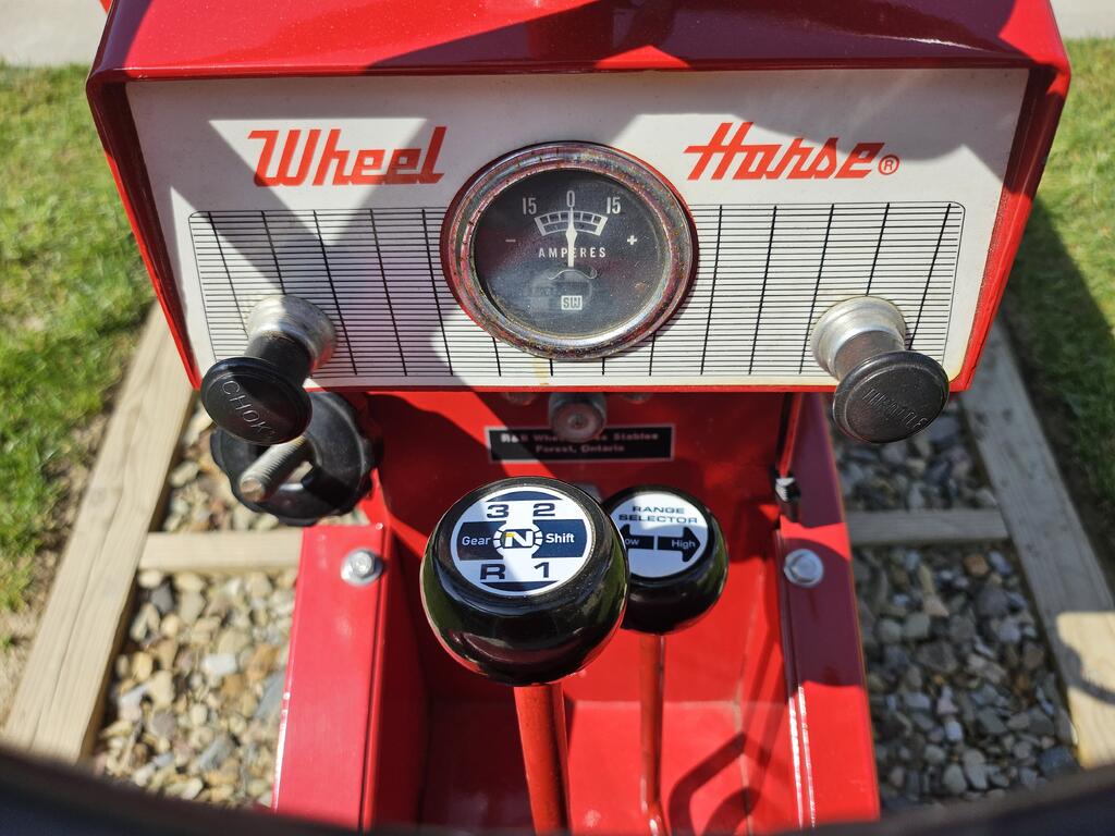

ML3 2,571 #4 Posted April 23 The dash on my 654 in 1st pic. 2nd pic is dash on my 753 The tie rods/steering components (unless replaced/upgraded) appear to be 1963 or later? 2 1 Share this post Link to post Share on other sites
ri702bill 13,392 #5 Posted April 23 (edited) Hmmmm... I'm going to agree it is of 1964 vintage - most likely started life as a 654. The cambered front axle with tierods, the slotted grille, and the Dial-a-Height lift lever stop all say 1963 or later. @ML3 - excellent work on that 753. Nice upgrade to the HI-LO Unidrive. That makes it take on a whole new personality. Similar to my 854 8 speed. The one they never built, but should have. Nice to see the OE choke & throttle knobs too. Edited April 23 by ri702bill 2 1 Share this post Link to post Share on other sites

ML3 2,571 #7 Posted April 23 8 minutes ago, ri702bill said: Hmmmm... I'm going to agree it is of 1964 vintage - most likely started life as a 654. The cambered front axle with tierods, the slotted grille, and the Dial-a-Height lift lever stop all say 1963 or later. @ML3 - excellent work on that 753. Nice upgrade to the HI-LO Unidrive. That makes it take on a whole new personality. Similar to my 854 8 speed. The one they never built, but should have. Nice to see the OE choke & throttle knobs too. Thanks. Cant take credit for the Hi-Lo. Purchased 753 from @Buckeyes. He gets the credit for transmission upgrade. He told me it was a NOS unit 1 Share this post Link to post Share on other sites
ri702bill 13,392 #8 Posted April 23 10 minutes ago, ML3 said: He told me it was a NOS unit The Unidrive is, but from a later tractor. Is it a 6 or 8 speed?? Done right, it looks like it was from the factory... 1 Share this post Link to post Share on other sites
Racinbob 13,290 #9 Posted April 23 I'm liking the 753 thoughts. I was thinking it was 64 when they switched the front axle but a bit of research showed it was 63 except for the Lawn Ranger and 603. The steering wheel would be flat on a 63 but that doesn't look original. 3 1 Share this post Link to post Share on other sites

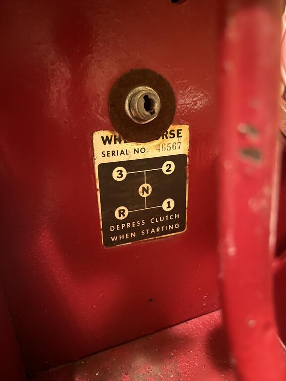

gwest_ca-(File Mod) 12,557 #10 Posted April 23 Turns out serial 46567 was recorded in the past as a 753. 3 2 1 Share this post Link to post Share on other sites
953 nut 70,649 #11 Posted April 23 Since it has been confirmed that your is a 753 and you want more information on it I have attached a link to all of the 753 related manuals we have. Have you owned it very long? How did it come into your possession? Any problems we can help with? https://www.wheelhorseforum.com/search/?q=753&quick=1&type=downloads_file&nodes=7 1 1 Share this post Link to post Share on other sites
Buckeyes 277 #13 Posted April 23 (edited) 1 hour ago, ri702bill said: The Unidrive is, but from a later tractor. Is it a 6 or 8 speed?? Done right, it looks like it was from the factory... The transmission is a 'later model' nos 8-speed I acquired from somewhere along the way. The original 3-speed on the 753 was in need of a rebuild at the time, so I thought an 8-speed swap would be pretty cool. Edited April 23 by Buckeyes 2 2 Share this post Link to post Share on other sites
ri702bill 13,392 #15 Posted April 23 34 minutes ago, Buckeyes said: The transmission is a 'later model' nos 8-speed I acquired from somewhere along the way. The original 3-speed on the 753 was in need of a rebuild at the time, so I thought an 8-speed swap would be pretty cool. Same here. I picked up my 854 locally where it had sat outside in the elements for over 2 years. The 3 speed was filled to the shifter boot with water. Scored a good deal on a C81 roller that had low hours back in 2014 & the oil in the 8 speed was like new. Soooo........ 1 3 Share this post Link to post Share on other sites
ML3 2,571 #16 Posted April 23 2 hours ago, ri702bill said: The Unidrive is, but from a later tractor. Is it a 6 or 8 speed?? Done right, it looks like it was from the factory... Its a 8sp. Very well done installation by @Buckeyes 1 Share this post Link to post Share on other sites

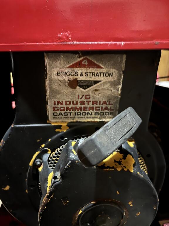

NewToWH 8 #20 Posted April 23 7 hours ago, 953 nut said: Since it has been confirmed that your is a 753 and you want more information on it I have attached a link to all of the 753 related manuals we have. Have you owned it very long? How did it come into your possession? Any problems we can help with? https://www.wheelhorseforum.com/search/?q=753&quick=1&type=downloads_file&nodes=7 7 hours ago, gwest_ca said: Turns out serial 46567 was recorded in the past as a 753. Thank you!! It used to be my FIL but he sold it to a guy and I just bought it off him yesterday. I had been researching before I bought it but was really struggling to find much. Figured the motor wasn’t original but I knew some came with a B&S so wasn’t sure. Thank you to everyone welcoming me! I’m really excited about this new adventure and everything I’ve got to learn. 1 2 Share this post Link to post Share on other sites
NewToWH 8 #21 Posted April 23 7 hours ago, 953 nut said: Since it has been confirmed that your is a 753 and you want more information on it I have attached a link to all of the 753 related manuals we have. Have you owned it very long? How did it come into your possession? Any problems we can help with? https://www.wheelhorseforum.com/search/?q=753&quick=1&type=downloads_file&nodes=7 Only issue I know of is the guy said sometimes it’s hard to find the gear. Feels like you never found gear but goes back and forth. Is this common? 2 Share this post Link to post Share on other sites
Achto 32,962 #22 Posted April 23 3 hours ago, NewToWH said: Figured the motor wasn’t original but I knew some came with a B&S so wasn’t sure. The only Wheel Horse garden tractors with a B&S engine were the Work Horse's. Your 753 should have a Kohler K161 engine. Nothing wrong with the B&S, just some info for you. 3 hours ago, NewToWH said: Only issue I know of is the guy said sometimes it’s hard to find the gear. Watch the belt when you step on the brake/clutch peddle. If the belt does not stop it will be hard to get it in gear. 3 Share this post Link to post Share on other sites
953 nut 70,649 #23 Posted April 23 4 hours ago, NewToWH said: Only issue I know of is the guy said sometimes it’s hard to find the gear. Feels like you never found gear but goes back and forth. Is this common? Could be the dogpoint screw needs to be adjusted. This thread will help you along if that is the case. 1 Share this post Link to post Share on other sites
gwest_ca-(File Mod) 12,557 #24 Posted April 24 Make sure the donut is secure on the shifter. Some are welded and some are pinned. 1 Share this post Link to post Share on other sites
