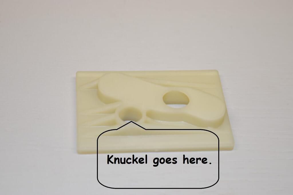

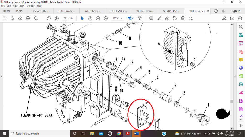

953 nut 70,649 #4 Posted April 23 There is a plastic cam plate that connects the motion control lever to the Sundstrand transmission motion control. They6 tend to become worn and I would start by looking there. 4 1 Share this post Link to post Share on other sites

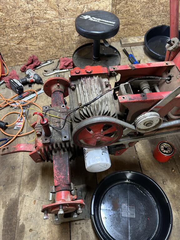

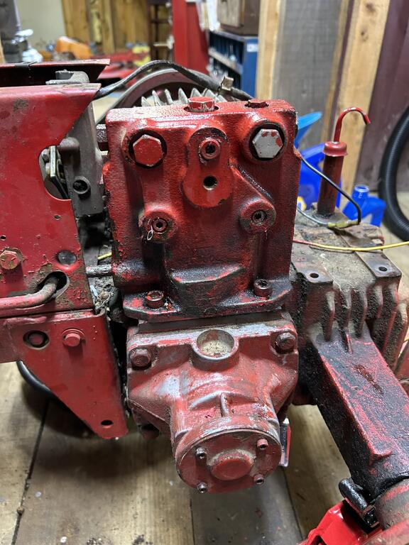

Tom Rochon 3 #5 Posted May 2 Hello, it's me again. I downloaded the manual you guys sent me, but my unit does not look like the one in the manual. I drained the unit overnight by removing the filter and drain plug. I removed all valves, inspected them and put them back in the same place just as they came out. I replaced the filter with a NAPA 1410 filter and 10W-30 oil. I removed the plastic cam so I could move the valve by hand. Now I don't have forward or reverse. What did I miss or do wrong? Thanks for all your help! 1 Share this post Link to post Share on other sites
pfrederi 21,342 #6 Posted May 2 From the picture you have the piston to piston unit. Which the manual covers. Can you push it with tow valve closed 2 Share this post Link to post Share on other sites

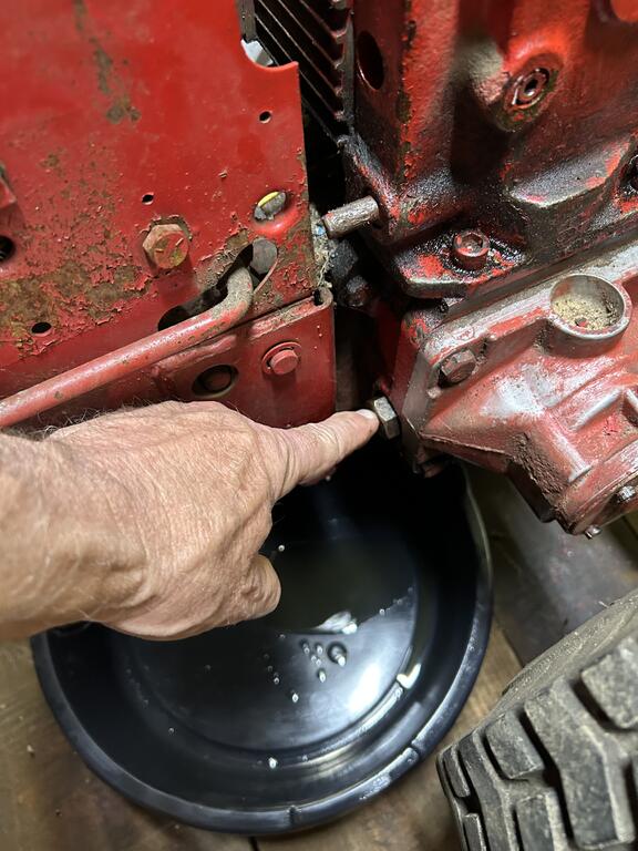

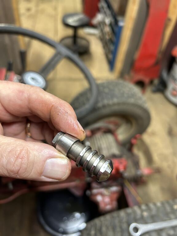

Tom Rochon 3 #7 Posted May 4 Hello, I drained the fluid (10W-30) last night and a lot of micro air bubbles came out with the oil. I cannot push the tractor with the tow valve closed, or open. I noticed (see pictures attached) that there is a flat spot on this bullet. Does this have to align a certain way with the flat surface on re-install? 1 Share this post Link to post Share on other sites
ineedanother 2,885 #8 Posted May 5 (edited) 1 hour ago, Tom Rochon said: Hello, I drained the fluid (10W-30) last night and a lot of micro air bubbles came out with the oil. I cannot push the tractor with the tow valve closed, or open. I noticed (see pictures attached) that there is a flat spot on this bullet. Does this have to align a certain way with the flat surface on re-install? If I'm not mistaken, I don't think there's any need or way to align that. The flat side just allows fluid to pass, not intended to hold it in a specific orientation to the motor housing. Edited May 5 by ineedanother 1 Share this post Link to post Share on other sites
ineedanother 2,885 #9 Posted May 5 On 5/2/2026 at 3:47 PM, Tom Rochon said: Hello, it's me again. I downloaded the manual you guys sent me, but my unit does not look like the one in the manual. I drained the unit overnight by removing the filter and drain plug. I removed all valves, inspected them and put them back in the same place just as they came out. I replaced the filter with a NAPA 1410 filter and 10W-30 oil. I removed the plastic cam so I could move the valve by hand. Now I don't have forward or reverse. What did I miss or do wrong? Thanks for all your help! It's likely that there just isn't any oil in the pump if you filled it through the filler tube into the gear box. When the system is empty, I much prefer to remove the drive belt and run the drive pulley with a drill and 7/16" socket (in reverse) filling through the top port on the pump housing (11/16" plug at the top of this photo). If you're not turning the drive pulley with the drill, oil will not go in. That will fill the pistons in the pump and motor. 1 Share this post Link to post Share on other sites

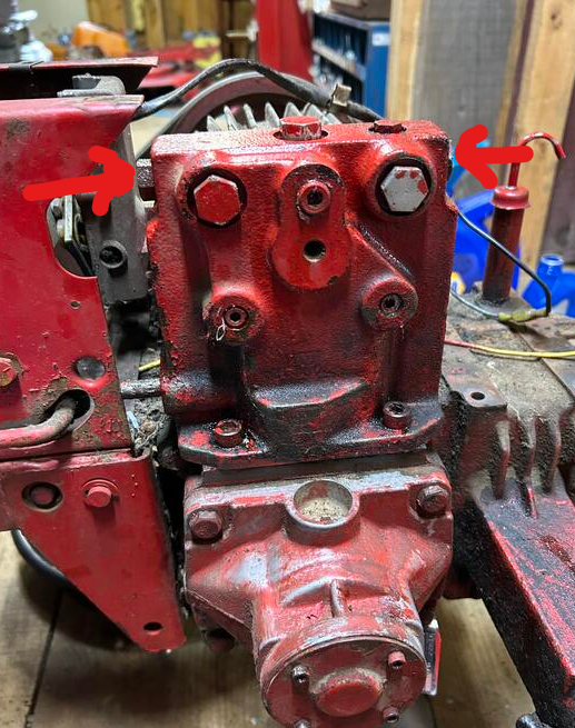

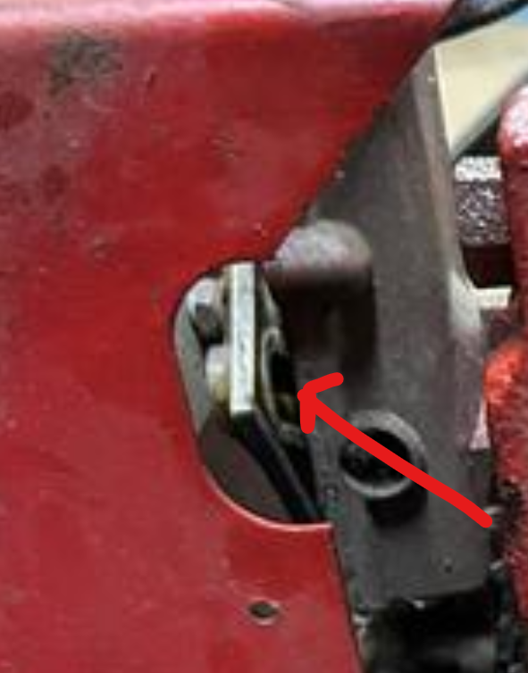

Bar Nuthin 3,644 #10 Posted May 5 On 5/2/2026 at 3:47 PM, Tom Rochon said: Hello, it's me again. I downloaded the manual you guys sent me, but my unit does not look like the one in the manual. I drained the unit overnight by removing the filter and drain plug. I removed all valves, inspected them and put them back in the same place just as they came out. I replaced the filter with a NAPA 1410 filter and 10W-30 oil. I removed the plastic cam so I could move the valve by hand. Now I don't have forward or reverse. What did I miss or do wrong? Thanks for all your help! Is it just me, or does something look amiss here? 3 Share this post Link to post Share on other sites

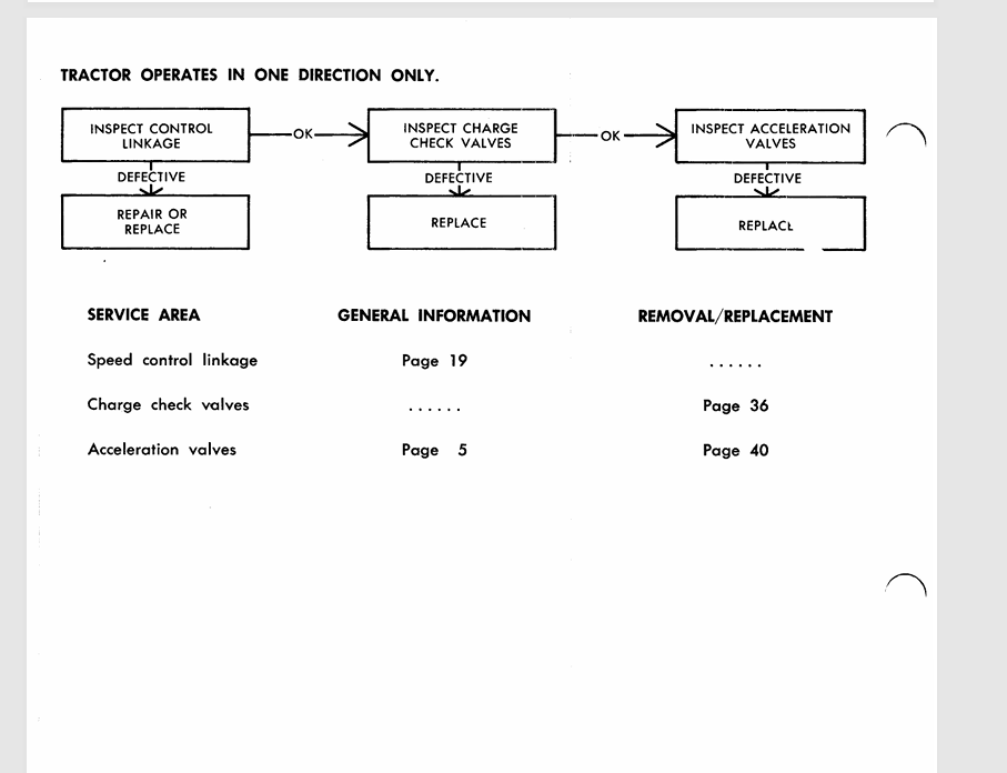

Bar Nuthin 3,644 #11 Posted May 5 These are the charge valves mentioned in the trouble shooting chart. There shouldn't be anything in the front one - the back one should have a spring and a metal cone. Make sure the cone is clean. 1 Share this post Link to post Share on other sites
ineedanother 2,885 #12 Posted May 5 32 minutes ago, Bar Nuthin said: Is it just me, or does something look amiss here? Without question. Good catch. 2 Share this post Link to post Share on other sites
953 nut 70,649 #13 Posted May 6 On 5/4/2026 at 9:56 PM, Bar Nuthin said: Is it just me, or does something look amiss here? You referring to the cam plate mentioned in post #4 of this thread. 2 Share this post Link to post Share on other sites
squonk 48,427 #14 Posted May 6 Yes the cam plate looks all Caa Caa! 1 Share this post Link to post Share on other sites
Bar Nuthin 3,644 #15 Posted May 6 (edited) 2 hours ago, 953 nut said: You referring to the cam plate mentioned in post #4 of this thread. Yes. Hard to tell what's going on here or at which stage of testing the photo was taken. OP said he removed the plate and tested manually, but it's not clear on what he found when he tested by hand. Also says he lost both forward and reverse at that point. Does he mean when testing by hand, or after reassembly. Given that he's pulled several of the valves and the cam plate, there are a lot more suspects in the line-up if something didn't go back together right. Given that the tractor now won't roll with the tow valve open or closed - the cam plate may be the least of his worries. Edited May 6 by Bar Nuthin 1 Share this post Link to post Share on other sites
squonk 48,427 #16 Posted May 6 6 hours ago, Bar Nuthin said: Also says he lost both forward and reverse at that point. I had the arm that the cam plate moves loosen on the control shaft once. Set screw came loose. Could be all it is. 1 Share this post Link to post Share on other sites
