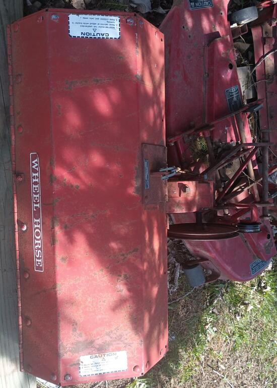

syslvt90 2 Report post #1 Posted 12 hours ago Hello, I have a C141 and a 77-36TL01 rototiller. The interchange list does not show compatibility. The tiller listed as compatible is 97-36TL01. Does anyone know if these 2 models are similar? If I can use the 77-36TL01, I will need parts. Thank you for your help! Stacey 1 Lane Ranger reacted to this Quote Share this post Link to post Share on other sites
c-series don 11,796 Report post #2 Posted 9 hours ago I believe it will fit, however if you can post a picture of it we can tell you for sure. 1 Lane Ranger reacted to this Quote Share this post Link to post Share on other sites
syslvt90 2 Report post #3 Posted 8 hours ago Photo of the tiller. 1 Lane Ranger reacted to this Quote Share this post Link to post Share on other sites
c-series don 11,796 Report post #4 Posted 8 hours ago That will fit! You will need the lift cable on the tractor, rear axle bracket, mid- mount pulleys and obviously the belt. 2 1 Lane Ranger, ineedanother and syslvt90 reacted to this Quote Share this post Link to post Share on other sites

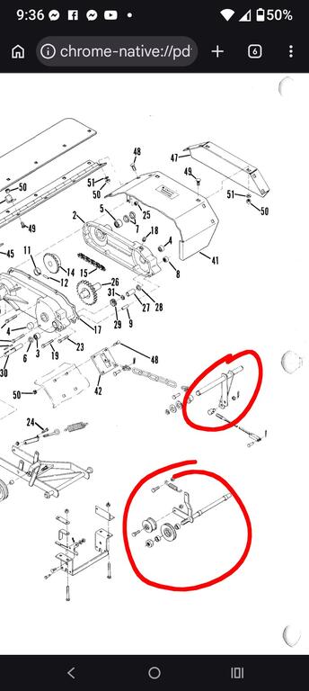

syslvt90 2 Report post #6 Posted 7 hours ago Awesome 👍🏻 Thank you c-series don. gwest_ca thank you for the comparison, they appear similar to me. I see I am missing at least 2 parts for it though. The ones circled in red. Quote Share this post Link to post Share on other sites
