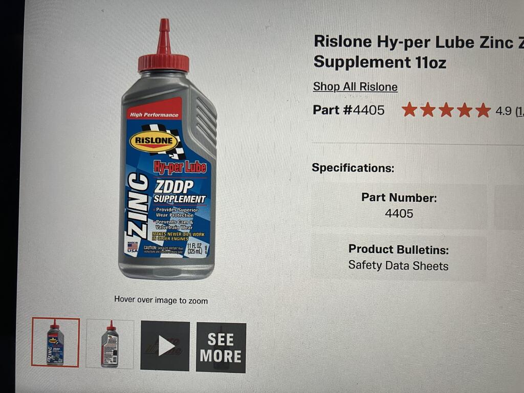

Retired Wrencher 6,792 #14 Posted April 24 I use a when I change the oil. It helps the tappets. 1 Share this post Link to post Share on other sites

peter lena 9,948 #16 Posted April 24 @Retired Wrencher been using that rislone zinc for for years , 4 oz per 2 qts of oil , bottle specs , often refer to it for smoking engines ? its VARNISH CUTTING ABILITY IS AMAZING , would pick up a used neglected engine , smoking , rough , run it in on a seperate gallon of heavily treated fresh fuel ? cleaned fuel bowl , STA BIL IN THE GAS . START THE IMEDIATE REVERSAL OF FUEL HOSE BREAK DOWN .while slowly recovering engine function . detail in carb , and related linkage function , usually a rusted / neglected mess . choke and related throttle, plate barely move , its amazing to me how close , original set ups were , verifying insuring areas , make them work with ease . just started up my , 1982 ,c 85 , swapped in a 12 magnum years back , still my favorite unit , also my test bed for a lot of ideas , pete 1 Share this post Link to post Share on other sites

Retired Wrencher 6,792 #18 Posted April 25 21 hours ago, peter lena said: @Retired Wrencher been using that rislone zinc for for years , 4 oz per 2 qts of oil , bottle specs , often refer to it for smoking engines ? its VARNISH CUTTING ABILITY IS AMAZING , would pick up a used neglected engine , smoking , rough , run it in on a seperate gallon of heavily treated fresh fuel ? cleaned fuel bowl , STA BIL IN THE GAS . START THE IMEDIATE REVERSAL OF FUEL HOSE BREAK DOWN .while slowly recovering engine function . detail in carb , and related linkage function , usually a rusted / neglected mess . choke and related throttle, plate barely move , its amazing to me how close , original set ups were , verifying insuring areas , make them work with ease . just started up my , 1982 ,c 85 , swapped in a 12 magnum years back , still my favorite unit , also my test bed for a lot of ideas , pete Well Pete you told me about it so now I always have some in the oil lubes and what ever else box. 1 Share this post Link to post Share on other sites
peter lena 9,948 #19 Posted April 25 @Retired Wrencher thank you for the reply , regularly read about a lot of areas , that I experimented with , ( repetitive problem ) love those ? more often than not , it was the original build set up , on a production line , they were in a hurry , I AM NOT , the quality of another era made them survive , my original c-85 , was my test bed , for anything , similar / yet different , on my other horses , none of my engines , smoke or blow oil , transmissions , regularly , checked , clean / clear , that fuel hose issue , DISSAPEARED WITH STABIL , started at tank flushing , all new lines , never a speck of anything in filters , went on to carb , functional detailing , another , GOLD MINE of small issues , eliminated . as a long retired millwright , I just look at any problem differently , cleaning out a wide rubber side shield bearing, carb cleaner flush , LUCAS X-TRA HD , green chassis grease , never had a failure or whining noise , 3 tractors set up the same way , solid / reliable , coming to the end , pete Share this post Link to post Share on other sites
