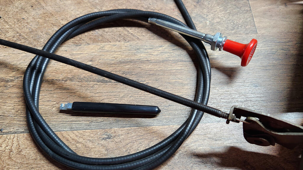

Racinbob 13,210 #11 Posted April 21 Buying cable in bulk is a better idea but for no more often than I do it I just pick up a cheap throttle and cannibalize. I discovered I needed one for my Dino project so I got this at Rural King a couple days ago. I'll fit it to the original control and cut it to length as needed. The Z bend tool I have gets the job done OK. 1 3 Share this post Link to post Share on other sites
Retired Wrencher 6,993 #12 Posted April 21 10 hours ago, Achto said: Yes you can. Here are some other alternatives that make the job a little easier. A DIY Z bend pliers. A dedicated Z bend pliers. https://www.amazon.com/HRGDFBP-Spring-Pliers-Bending-Aircraft/dp/B0FRF4GF6V/ref=sr_1_7 I bought one of those years ago. Very handy to have. 3 Share this post Link to post Share on other sites
hotajax 285 #13 Posted April 21 8 hours ago, Racinbob said: Buying cable in bulk is a better idea but for no more often than I do it I just pick up a cheap throttle and cannibalize. I discovered I needed one for my Dino project so I got this at Rural King a couple days ago. I'll fit it to the original control and cut it to length as needed. The Z bend tool I have gets the job done OK. Bob: I saw that tool somewhere else. How does it work? 1 Share this post Link to post Share on other sites
Racinbob 13,210 #14 Posted April 21 1 hour ago, hotajax said: Bob: I saw that tool somewhere else. How does it work? It works well. Definitely a step up from using long noses. Probably not as good as the pliers designed for the bends but I've never tried those. 1 Share this post Link to post Share on other sites
