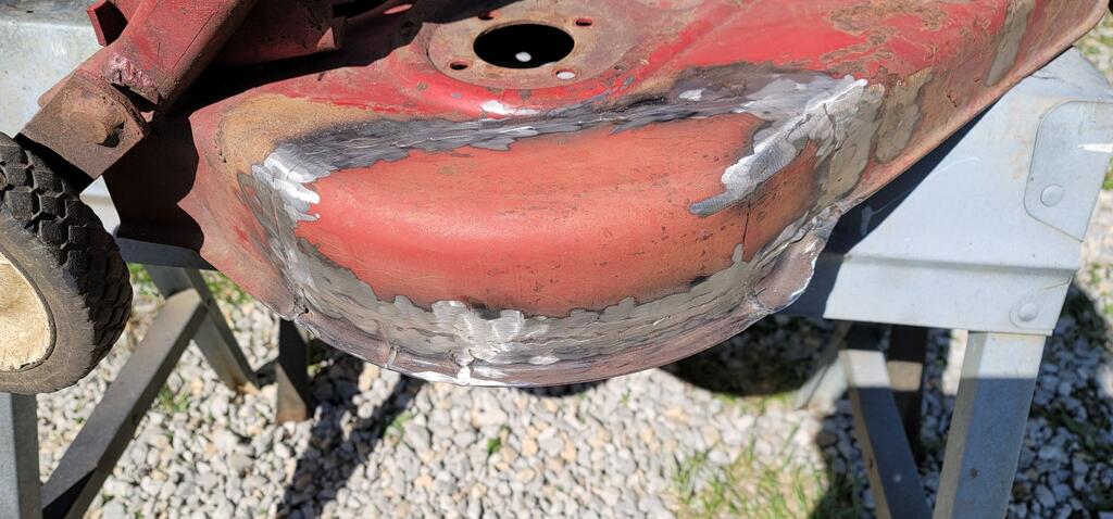

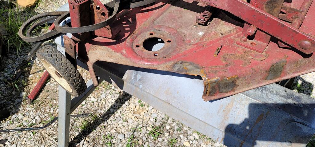

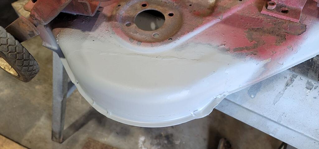

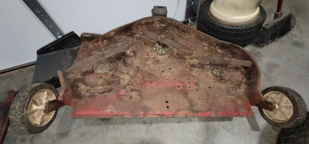

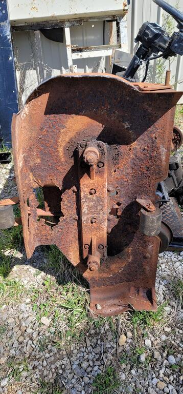

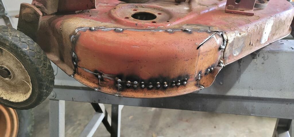

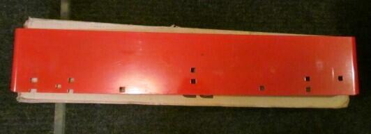

BradKahler 391 #1 Posted April 20 (edited) When I bought my B80 it came with a front dozer blade and a 36" mower deck. The deck was in pretty sad shape, all three spindles were worn out and frozen, and the rear of the shell was open and it had a cobbled together side discharge chute. The deck model number is 95-36MS01 which is supposed to be a side discharge. I don't know why the back was missing, but it was pretty obvious that the side chute had been reworked rather poorly. For my use I need a rear discharge so I took on the task of converting it to rear discharge. I put an ad in the Wanted section for anyone that might have a section of deck available and got no responses. So, I ended up using pieces of shell from the rusted out 36" deck from my 1966 656. The decks weren't really the same but I was about to cut various sections out and piece them together to eliminate the side discharge opening. This is what it looked like before I started. This is the deck I robbed piece from. The actual curved section was remarkably close to the 42" deck only the sides were taller. After a bunch of "custom" art work I ended up with the following: Is it pretty? No. Will it work? I think so. It's not going to be a full time mower, I needed something smaller than my 5' ztr to mow between a line of trees and a fence. I have all the parts for rebuilding the three spindles thanks to a couple of forum members, so the next task is to assemble and install the spindles. The bearings that I bought have seals on both sides. This deck will not be used more than a half dozen times a year for maybe 60 minutes each time. Would there be any reason to not just leave the bearing seals in place and forgo greasing through the spindles? I should add, I found a NOS rear chute on ebay and will be installing it as well. Thanks! Brad Edited April 20 by BradKahler 2 1 Share this post Link to post Share on other sites
8ntruck 9,171 #2 Posted April 20 Looks serviceable. What kind of welder did you use? 1 1 Share this post Link to post Share on other sites

BradKahler 391 #5 Posted April 21 13 hours ago, 8ntruck said: Looks serviceable. What kind of welder did you use? I have an old Hobart Beta Mig 200. It's a nice heavy duty industrial quality welder. 2 Share this post Link to post Share on other sites
