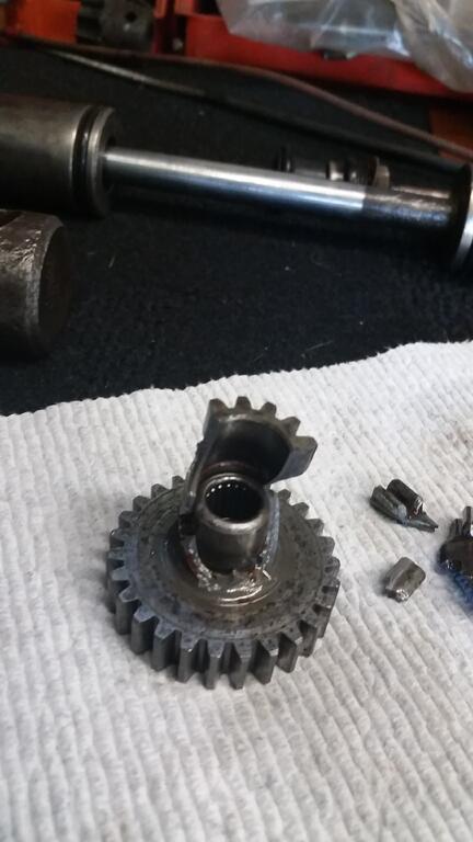

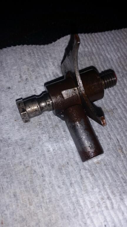

ri702bill 12,335 #4 Posted April 20 Jon - it sounds like the Hi-Lo shift lever inside is broken - a fairly common issue. If taken apart, the shift fork can be welded and actually made to be better than new. Ask if the swap-out trans has had that fix already done. If not, why not go thru fixing your own Unidrive?? "Replacement parts are only as good as the parts they replace" - learned that 50 years ago during my teens wrenching on a local short track Stock Car. 1 Share this post Link to post Share on other sites
WHX?? 57,176 #5 Posted April 20 3 minutes ago, ri702bill said: Hi-Lo shift lever inside is broken Might be but I have had the hi lo gear get crunched. Never did finger out why. The Hi lo shift forks Bill speaks of. One of the fingers have been known to wear and break off. 1 Share this post Link to post Share on other sites
WHX?? 57,176 #6 Posted April 20 10 minutes ago, ri702bill said: why not go thru fixing your own Unidrive?? Plenty of how to vids and help here on doing it. Finding parts isn't too much of a pain since the parts have remained fairly consistent throughout the years. I see you have an ad in wanted and I mentioned some of the MN boys that might be able to help. Share this post Link to post Share on other sites
