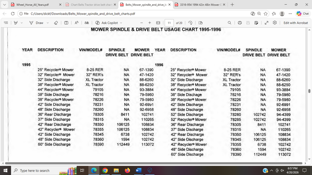

953 nut 70,651 #3 Posted April 19 51 minutes ago, Kali25 said: 416, Model 73423 With your tractor model number and the model number of your mower deck you can find both belts on this chart. Share this post Link to post Share on other sites

953 nut 70,651 #12 Posted April 20 Wheel Horse didn't make a 46" cut but there are a bunch of 48" Side Discharge mowers out there. Since your 416 is a 1996 model I looked up a deck of the same year. Belt # 102742 is the Wheel Horse number and that is a 1/2" by 103" belt. Tractor supply should have this in stock in their Kevlar belts. Share this post Link to post Share on other sites
Kali25 14 #13 Posted April 21 Huge help, this site is amazing! I'll try that sized belt 1 Share this post Link to post Share on other sites

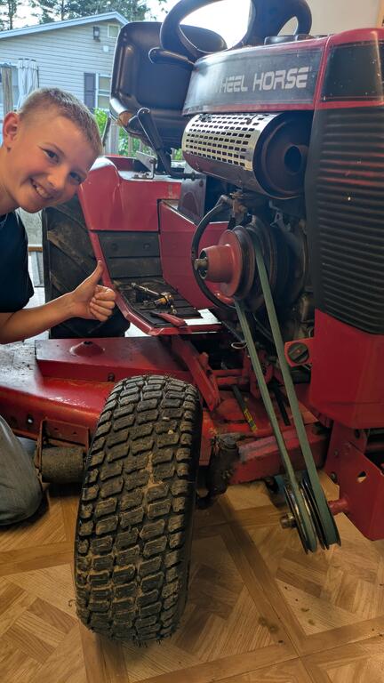

Kali25 14 #17 Posted April 22 VICTORY! The 1/2 103" belt was the winner! You can see the pride in my sons face! Yeah, he's really happy. 2 2 Share this post Link to post Share on other sites

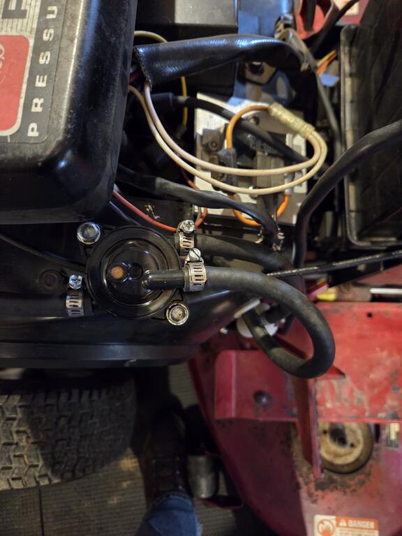

Bill D 3,213 #18 Posted April 25 Glad you found the right belt for it! Based on the picture you definitely have a 48" deck (I can tell by the belt cover). Deck belt is a 107". Both belts are available at Lowe's. Same belts as the ones sold at TSC. I have two 416H's. They are my favorite machines. I've built foot pedals for both of them as I hate the hand control in any form. Search Hydro Pedal #1, 2, 3 if you want to see what I built I'd recommend running a second wire from the voltage regulator to the battery positive on the starter. This takes the load out of the 9 pin connector and helps to prevent it from burning up. I used the white wire for the head temp sensor for this. The head temp sensor is not used on the 416. If the fuel pump fails a Kawasaki pump can be used. I stay away from the cheap Chinese pumps. Share this post Link to post Share on other sites
