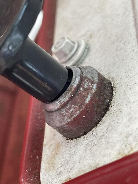

FLtractor 223 #1 Posted April 19 Evening, Is this supposed to be removed by thumb and hand motion? Just lubricant it? Or some kind of wrench or tools? Share this post Link to post Share on other sites
rmaynard 17,579 #2 Posted April 19 (edited) Just use pliers on it. It will come off. Be careful not to use pliers on the front or it will scar it a bit. Sometimes it's easier if you remove the four screws hold the dash panel on. You will get more maneuverability Edited April 19 by rmaynard 2 Share this post Link to post Share on other sites
Ed Kennell 47,271 #3 Posted April 20 3 hours ago, rmaynard said: Be careful not to use pliers on the front or it will scar it a bit. If you need to hold the front with pliers, wrap it with several layers of duct tape ti prevent damage. 2 Share this post Link to post Share on other sites
FLtractor 223 #4 Posted April 20 3 hours ago, rmaynard said: Just use pliers on it. It will come off. Be careful not to use pliers on the front or it will scar it a bit. Sometimes it's easier if you remove the four screws hold the dash panel on. You will get more maneuverability Thank you. Share this post Link to post Share on other sites
FLtractor 223 #5 Posted April 20 8 minutes ago, Ed Kennell said: If you need to hold the front with pliers, wrap it with several layers of duct tape ti prevent damage. Thank you Share this post Link to post Share on other sites

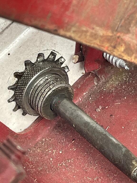

Retired Wrencher 6,983 #6 Posted April 20 (edited) Just remember first that has been there for 60 years. Judging by the picture that you sent definitely original.A small chisel to brake it free. Done many of these. Once you brake it a way from the locking washer use two hands to spin the nut off. If you buying a new one there will be a big nut instead that thin spin on locking washer. Edited April 20 by Retired Wrencher 1 Share this post Link to post Share on other sites
