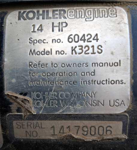

nyquil junkie 280 #1 Posted April 19 (edited) As per my thread in the other forum, this is my dead auction win from the other day, a 314-A with the K321S engine. Seems all there, all the wiring looks original and unmolested. Problem, it has no spark. It'll crank if you turn the key to On and then jump the starter post. But if you turn the key to start, nothing. Before I do something stupid, is there some common point of failure somewhere that will 1)kill the start key from cranking the started and 2) kill the spark? Edited April 19 by nyquil junkie 1 Share this post Link to post Share on other sites
